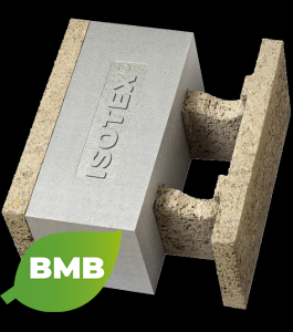

Dunmow Posted November 19, 2021 Share Posted November 19, 2021 I have used isotex ICF to build the walls of my new build. I have quite a lot of EPS insulation blocks left as surplus (taken out of ICF blocks that were used for internal strucutral walls) and wondering if I can make use of them. Can I use them for insulation in my cold roof, ie above the ceiling, below the trusses. The roof areas is too small to use as loft storage so dont mind if it is totally filled. I was thinking perhaps a super foil sheet or quilt and the lay out out all of the EPS blocks, 1 or 2 layers high. There may be some gaps. Would this work as insulation? Or could it be used in addition to some other insulation such as super foil and glass wool? Do I need to tape up gaps? Is there anything else I need to take into consideration? Thanks Link to comment Share on other sites More sharing options...

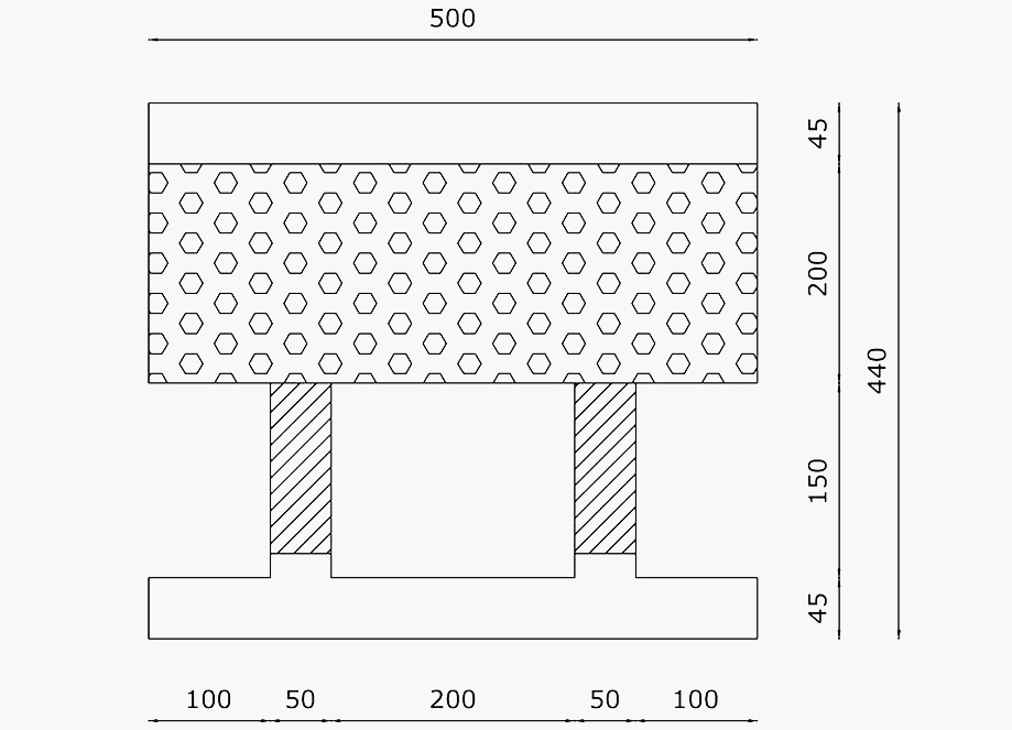

Dunmow Posted November 21, 2021 Author Share Posted November 21, 2021 Thanks for your reply. The suggestion of burying insulation below ground would have been perfect but we have already filled in the ground around the foundations. The blocks of insulation are quite large, though not solid throughout, more like an "E" shape. The back of the E is 500m, the top 350mm, the two gaps are 50mm wide and 150mm deep (similar to the sketch below - though this just shows the back of the E, not the legs). One room is currently stacked high to the ceiling with the insulation and I would really rather use them than throw them. Any other suggestions? Link to comment Share on other sites More sharing options...
