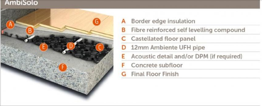

ProDave Posted November 19, 2021 Posted November 19, 2021 Are you saying you have this "AmbiSolo" on the ground floor? I don't see any insulation in that system. It relies on the concrete floor having insulation under it already. Does yours have any such insulation under the concrete? How old is the house?
Dmitri Posted November 19, 2021 Author Posted November 19, 2021 2 minutes ago, ProDave said: When the UFH was fitted, how much and of what type of insulation was fitted under the floor? What is the floor construction? I have attached the screenshots of the designer's drawing. Hoping that this would help to understand what we have got. In short, our downstairs was already concreted when we got the property, I do not know if there is any insulation. So I assume that there isn't any. Between the floors we have 100mm Rockwool (between the joists) and also have an air gap between ceiling boards (battens on the old ceiling with new plasterboard on top)
Dmitri Posted November 19, 2021 Author Posted November 19, 2021 1 minute ago, ProDave said: Are you saying you have this "AmbiSolo" on the ground floor? That is correct. The house is nearly 100 years old I believe

ProDave Posted November 19, 2021 Posted November 19, 2021 Just now, Dmitri said: That is correct. The house is nearly 100 years old I believe Oh dear. I believe you have been miss sold the wrong system for your house. with no insulation under the concrete floor, you will be heating the ground under your house. There is no way this is ever going to work efficiently I would be going back to the supplier and tell them you have been miss sold the wrong system for this house.

Dmitri Posted November 20, 2021 Author Posted November 20, 2021 1 hour ago, ProDave said: doomed to just dumping a very large amount of it's heat I just checked through their supportive information and this is what they claim about this system on their website: The AmbiSolo system is a low profile castellated underfloor heating system, designed for refurbishment projects where floor buildup is at a premium. The system incorporates a 12mm Ambiente underfloor heating pipe within a plastic castellated panel, which is then covered with 20mm of reinforced levelling compound. The way that this system is designed means that it must be laid directly onto a structural and level sub-floor, not onto any loose flooring or insulation layer. This can be a concrete sub floor or chipboard floor, but it must be a structural layer as the 20mm compound is not structural in its own right. There are many unique benefits of the AmbiSolo system, even above other retro-fit UFH systems. Firstly, the response time is very quick, heating up in 15-30 minutes (depending on the floor covering), very similar to the response time of a radiator. Secondly, the output of the system is exceptional – while we recognise there may be a small downward loss of up to 10% (due to no insulation layer beneath it), the quick response time and overall output of the system more than compensates for this.
