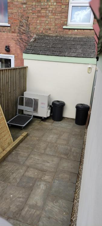

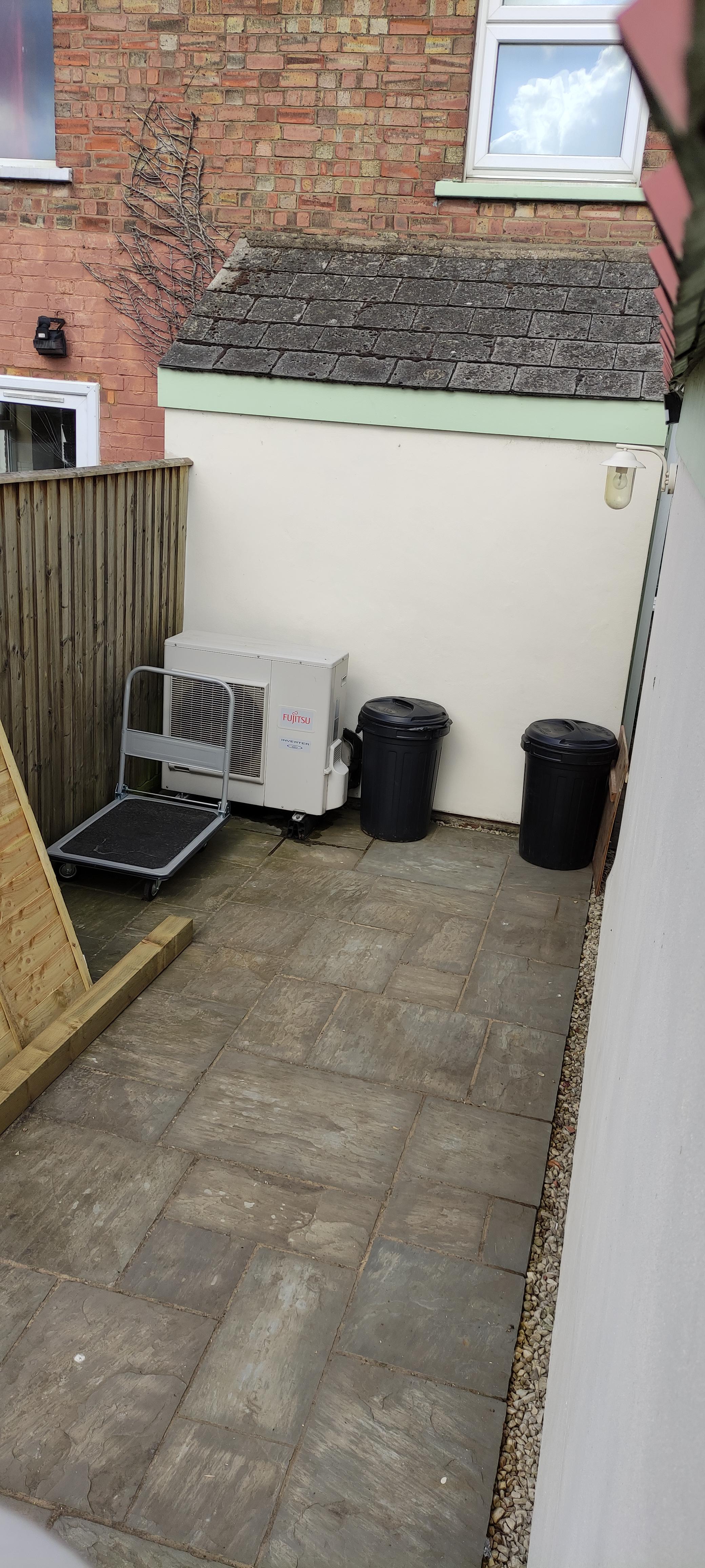

Another question someone may be able to help with.  The actual system in the garden must be ten years old at least, are the newer systems more efficient?.  Mine is mitsubishi see pic
Says Fujitsu on it ..? Probably not inverter driven but split systems (assuming there is a big box in the attic somewhere..??) which will have the refrigeration pipe work to it are usually a bit more efficient. The good thing is that this sort of product is pretty easy to find a service engineer for as they are well supported - would probably be worth getting the gas pressure checked and the condenser /evaporator coils checked and cleaned.
Not significantly. They all work the same.
Don't get temperature and energy mixed up, there is a reason that the words are different.
My mistake I did mean Fujitsu, no idea why I put Mitsubishi.
Yeah has the big box in loft with vent into hall upstairs.
