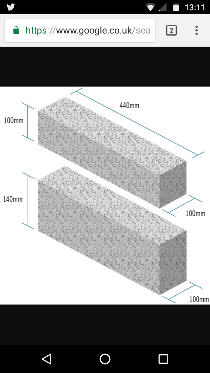

Pocster Posted April 12, 2017 Posted April 12, 2017 Hey all, My timber frame supplier wishes me to build a base for the frame. He said you can get 140x140mm concrete blocks (the width of the timbers). I can't see any online nor does my local builders merchants know of any. Rather than cut umpteen standard concrete blocks in half - anyone come across these before?? thanks in advance
Barney12 Posted April 12, 2017 Posted April 12, 2017 Are you sure he didn't just mean 140mm blocks? http://www.carvers.co.uk/products/CONCRETE-BLOCK-SOLID-STANDARD-140MM-7N-48-PER-PACK-12-PER-LAYER/P104304
Declan52 Posted April 12, 2017 Posted April 12, 2017 You don't want to lift full size 6 inch blocks, they are a ton. Called farmers friends as only they use them for pig houses and the like. You are looking for a soap bar block that will be 440mm*100mm*140mm. You want the bottom one in the pic. 1
Pocster Posted April 12, 2017 Author Posted April 12, 2017 (edited) 32 minutes ago, Declan52 said: You don't want to lift full size 6 inch blocks, they are a ton. Called farmers friends as only they use them for pig houses and the like. You are looking for a soap bar block that will be 440mm*100mm*140mm. You want the bottom one in the pic. Yeah that's more like it ! id have to lay it flat as the timber is 140 wide. i will now Google soap bar block :-)))) appreciated ! Edited April 12, 2017 by pocster
Declan52 Posted April 12, 2017 Posted April 12, 2017 Make sure you state the dimensions above that you want before ordering. You don't want the top block in the pic. Soapbar term might be just an Irish name for them. 1

Declan52 Posted April 12, 2017 Posted April 12, 2017 Get whoever you got your blocks from a phone and see if they stock them. Used mainly to get your walls back on coursing after you put lintels etc in. Easier to lift one soapbar than 4 brick.

Pocster Posted April 12, 2017 Author Posted April 12, 2017 2 minutes ago, PeterW said: Why not use a 140 wide lightweight standard block ..?? Not exactly heavy and you can get them in 7N strength I think the timber guy wants height of 140 and also width 140. He said a 140x140mm block (which I can't find). I could just lay a block 'flat' ( Concrete Block, 440x215x140mm) ; so it's 215mm height rather than 140mm. What worries me is the step in width i.e. 215. Does that matter??; means for example UFH won't 'reach' the wall....
PeterW Posted April 12, 2017 Posted April 12, 2017 http://forterra.co.uk/thermalite-and-aggregrate-blocks/thermalite-aircrete-block-detail/thermalite-aircrete-hi-strength-coursing-block Just bear in mind they need to be level across the slab to +/- 5mm for most timber frame companies so I would suggest using two courses of 65mm and get you pretty close (145mm) with a couple of thin mortar beds to level out any uneveness
