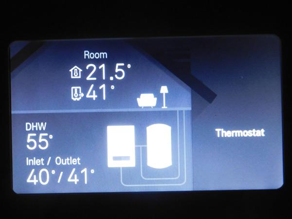

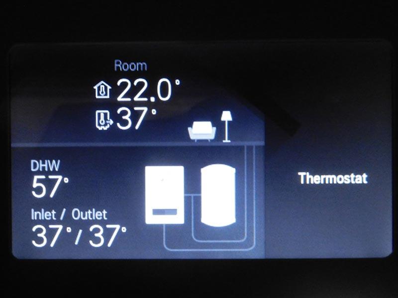

Hogboon Posted November 17, 2021 Author Share Posted November 17, 2021 Well, having spent a few more fruitful minutes in the broom cupboard, the current settings for your suggestions are: Outdoor temp for auto mode: min -10º max 15º Indoor temp for auto mode: min 16º max 21º LWT for auto mode: min 20º max 50º These are obviously different from your suggested values, but what I have no understanding of is whether the differences are significant or only minor? Link to comment Share on other sites More sharing options...
J1mbo Posted November 17, 2021 Share Posted November 17, 2021 Progress! Since outdoor temp for auto mode min is -10, it will almost never reach the max flow and the general flow temp will be lower. Change it to -1. Indoor temp probably shifts the whole curve up and down. Try 18/23. LWT are the flow temps themselves. Change the min to something higher eg 30. Link to comment Share on other sites More sharing options...

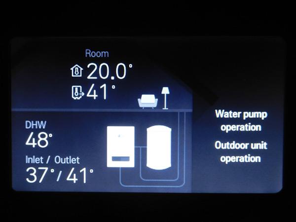

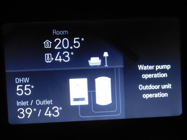

Hogboon Posted November 17, 2021 Author Share Posted November 17, 2021 I adjusted some of the settings as per your suggestions as follows; Outdoor temp for auto mode: min -10º max 15º changed to -1º/15º Indoor temp for auto mode: min 16º max 21º changed to 18º/23º LWT for auto mode: min 20º max 50º changed to 30º/50º The house temperature at the time, according to the Hive, was 19.9. Having made the changes the system fired up and I took an image [below] of the LG controller. Moments later the system had evidently executed whatever it had been set to accomplish as stopped and I took another image. The Hive showed the house temperature = 20º The first 'real' test will be to morrow a.m. when I will note times and temperatures as per my initial post for comparative purposes. Thanks again for all the help. 1 Link to comment Share on other sites More sharing options...
J1mbo Posted November 17, 2021 Share Posted November 17, 2021 Set the hive to well above where you want the room as well. Link to comment Share on other sites More sharing options...
Hogboon Posted November 18, 2021 Author Share Posted November 18, 2021 Only just seen your last message about the Hive setting J1mbo, so the following is as per the original set-up: target temp of 20ºC required starting at 07:00hrs. Here's the data. 17 Nov 2021 00’ 30’ 07:00 18.4º 18.3º 08:00 18.8º 19.3º 09:00 19.7º 20.0º Outdoor temp was about the same as for the original data set, about 10ºC at a guess. Household usage was also about the same but whereas no shower etc was run during house heating the water heating was already in progress at 07:00. And I confirm that the house temperature appeared to go backwards during the first half hour. However, today's performance seems to me a considerable improvement and I await with interest the promised cold spell! Below are 4 images of the controller; the first was taken at 07:00hrs, second and third at 08:00 and 09:00 and the last about 09:30 once the target temperature had been reached and the system powered down. I'm not sure why the room temps. according to the LG controller [images above] are shown as higher than the Hive temperatures [noted in the table] unless it is because the LG Controller has its own temp sensor in which case the difference is probably accounted for by the controller being in a smallish 'cupboard' in which the hot water tank is located and thus a degree or so warmer than the bulk of the house. Link to comment Share on other sites More sharing options...
Hogboon Posted November 18, 2021 Author Share Posted November 18, 2021 On 16/11/2021 at 20:09, J1mbo said: The final consideration is the Hive controller. I suspect this is a big part of the problem. Anything with a TPI program is unsuitable for a heat pump with weather compensation as the TPI program will introduce short-cycling by design, which is the worst possible operating condition for a heat pump. My advice would be to replace it with LG's native controls. However, for now, just set it to something really high like 30°C all the time which will effectively eliminate the TPI as the room temperature will be so far from the target and let the heat pump weather compensation control the living space. What is TPI? and by the same token what is short-cycling? We are presumably not talking about a bloke on a bike in lycra! Does it mean the 'system' will be starting and stopping all the time? If so I can't say I have noticed it doing so. I don't know what sort of drop in house temperature is required to trigger the heatpump. Would that be in the controller's settings somewhere? I'll see if I can catch it in flagrante next time it starts up and make a note of the temperature. Link to comment Share on other sites More sharing options...
J1mbo Posted November 18, 2021 Share Posted November 18, 2021 TPI is an algorithm used to reduce overshoot by on-off thermostats. Basically it cycles the heating on-off periodically as the set point is approached, thereby reducing the average surface temperature of the radiators. Heat pumps with weather compensation are always controlling the surface temperature and hence the two conflict. Short cycling is the compressor running for short intervals. Since there are losses in the pre-run and as the pressure builds, each compressor start costs efficiency. Running the compressor for less than about 10 minutes each cycle will reduce COP and therefore increase running costs. The TPI programme probably only takes effect within 1 degree of the set point (either side). Therefore you want the Hive to be at least two degrees above your actual desired temperature to eliminate the short cycling risk. The house temperature dropped initially because the heat pump was heating the DHW. Link to comment Share on other sites More sharing options...
Hogboon Posted November 18, 2021 Author Share Posted November 18, 2021 (edited) While I scratch my head over this, wouldn't setting the Hive 2º about my desired temperature simply result in the house being 2º warmer than I want it? And wouldn't the system simply continue its bad behaviour but 2º higher? Is the TPI 'in' the LG Controller? the heatpump itself? or the Hive? Sorry to be so dim! Edited November 18, 2021 by Hogboon Link to comment Share on other sites More sharing options...

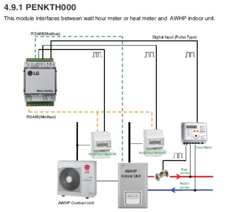

J1mbo Posted November 21, 2021 Share Posted November 21, 2021 @Hogboon - possibly on the main controller there is an 'energy' menu with the electric consumption data: Information Of Meter Interface - LG Therma V series Owner's Manual [Page 36] | ManualsLib Link to comment Share on other sites More sharing options...
Hogboon Posted November 21, 2021 Author Share Posted November 21, 2021 SteamyTea: Thanks for the link. Looks like a lot of heavy lifting involved to me. J1mbo: I have already hunted for anything resembling the 'Energy' symbol and menu shown on p.36 on my controller and concluded that it is a feature that for some reason is not included. However, a cursory read of p.35 suggests I may have to initiate it through the installer menu so will have a closer look tomorrow and see if I can goad the thing into revealing itself. Thanks both. Link to comment Share on other sites More sharing options...
Hogboon Posted November 22, 2021 Author Share Posted November 22, 2021 I stumbled across the Meter Interface Settings in the LG Controller last week when tweaking the temperatures and shied away having no idea as to what Modbus or Port settings might be in use etc. I am in much the same predicament now! Apart from the Hive thermostat there are PV panels which supply power a] direct to the heat pump, b] to hot water heating and c] assign any spare capacity to the grid. That side of things is controlled by something called iBoost. And for all I know there may be other bits of kit hogging a modbus or port. So my questions are: 1. Does it matter what modbus address and port settings I use? Nothing is recorded in the LG Control Panel which resembles https://www.manualslib.com/manual/1511067/Lg-Therma-V-Series.html?page=35#manual 2. If getting the correct modbus and port settings is critical have you any suggestions? Or can they be gleaned from somewhere in the controller or elsewhere? My objective in this being to have a ‘real time’ record of energy consumption by the heatpump. Many thanks. Link to comment Share on other sites More sharing options...
J1mbo Posted November 22, 2021 Share Posted November 22, 2021 It sounds like the meter monitoring is dependent on some external piece of hardware. Contact the installer as having some form of metering for the heat pump is a requirement for the RHI. They should have shown you this as it is part of the RHI annual declaration. Link to comment Share on other sites More sharing options...
Hogboon Posted November 22, 2021 Author Share Posted November 22, 2021 (edited) Apologies but my brief reply to your last post J1mbo has gone awry. But fear not; you didn't miss anything. More to the point you are right in assuming "some external piece of hardware." I had this from LG today. "In order to monitor or read energy consumption watt-hour meters must be fitted in the power supply of each of the following. · Immersion heater · Boost heater · Heat Pump Unit(s) · The Outdoor package in the case of a Monobloc AWHP Unit · Both the Outdoor Unit and Indoor Unit's in the case of a Split-Type AWHP Unit. "In addition, a Flow Sensor is used to record the water flow rate. "These provide signals to a 'Heat Meter', and/or the LG Meter Interface [PENKTH000] which in turn sends a Modbus communication signal to the AWHP which can be displayed on the LG Controller. Although the below PENKTH000 Accessory provides a means of measuring and displaying the power consumed, this device is not approved by the RHI for metering and subsidy payments. Whereas the products shown in the previous email were approved for use, and allowed subsidies to be paid. Quote "There is nothing included in the product as standard, which allows metering and consumption to be AWHP equipment." Which doesn't quite make sense but I have the gist of it. Just to be clear; the set-up here is a monbloc unit - no indoor unit. The 'previous' email referred to in the above had information about an installation approved by RHI which looked hugely complicated compared to the above and presumably has a suitably impressive price tag. So the long and the short of it looks like no energy or efficiency monitoring is possible in my current set-up. The only performance criterion [singular - I can only think of the one!] available to me seems to be to monitor time taken to achieve a target temperature based on primitive trial and error adjustments to temperature settings in the LG Controller. How much lower can the tech get than that? Edited November 22, 2021 by Hogboon Link to comment Share on other sites More sharing options...
J1mbo Posted November 23, 2021 Share Posted November 23, 2021 Get back to the installers. The system must have metering to qualify for RHI (assuming it was installed on or after 22-May-18). Probably you need to be metered for performance and not payment unless there are secondary heat sources installed. Factsheet_DoINeedMetering_RPIIA (ofgem.gov.uk) Link to comment Share on other sites More sharing options...
