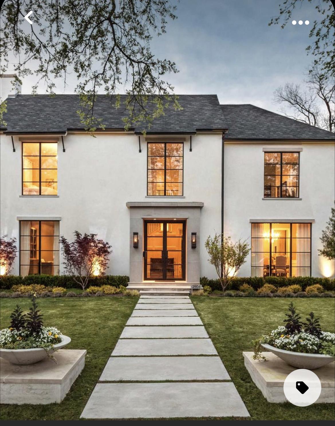

richo106 Posted November 8, 2021 Posted November 8, 2021 (edited) Hi For our upcoming project we are considering the black steel look framed windows. I’m guessing these will be made from aluminium as the steel would be really expensive!? Has any one got any recommended suppliers for anything like this? Many Thanks Edited November 8, 2021 by richo106
Nick Laslett Posted November 8, 2021 Posted November 8, 2021 (edited) Just a heads up, we went with Smarts Alitherm Heritage system, which is the basis for a lot of these steel look aluminium frames. The frames are not deep enough to take a PAS24 compliant triple glazed unit. This may not be an issue, but worth knowing that these are double glazed only, anywhere you need 6.8mm laminated panes for PAS24. The best U-value you will get is 1.5. Edited November 8, 2021 by Nick Laslett

RomyD Posted November 9, 2021 Posted November 9, 2021 You could try Origin. They are aluminium with quite thin (49mm iirc) frames. I love the style of Crittals but cannot find any with sub 1.0 u-values. 1

Adsibob Posted November 9, 2021 Posted November 9, 2021 Have a look at MetTherm. Ag210. They manufacture and install them, though lead times are long. alternatively exactly same windows are supplied and installed by Govette for slightly more. Quicker lead times. Their windows are very nice, but if you specify PAS24 there is a risk you will get some roller wave distortion, as their glass supplier had a problem with this on one of the windows I bought, still not rectified. I bought 12 windows from them.
