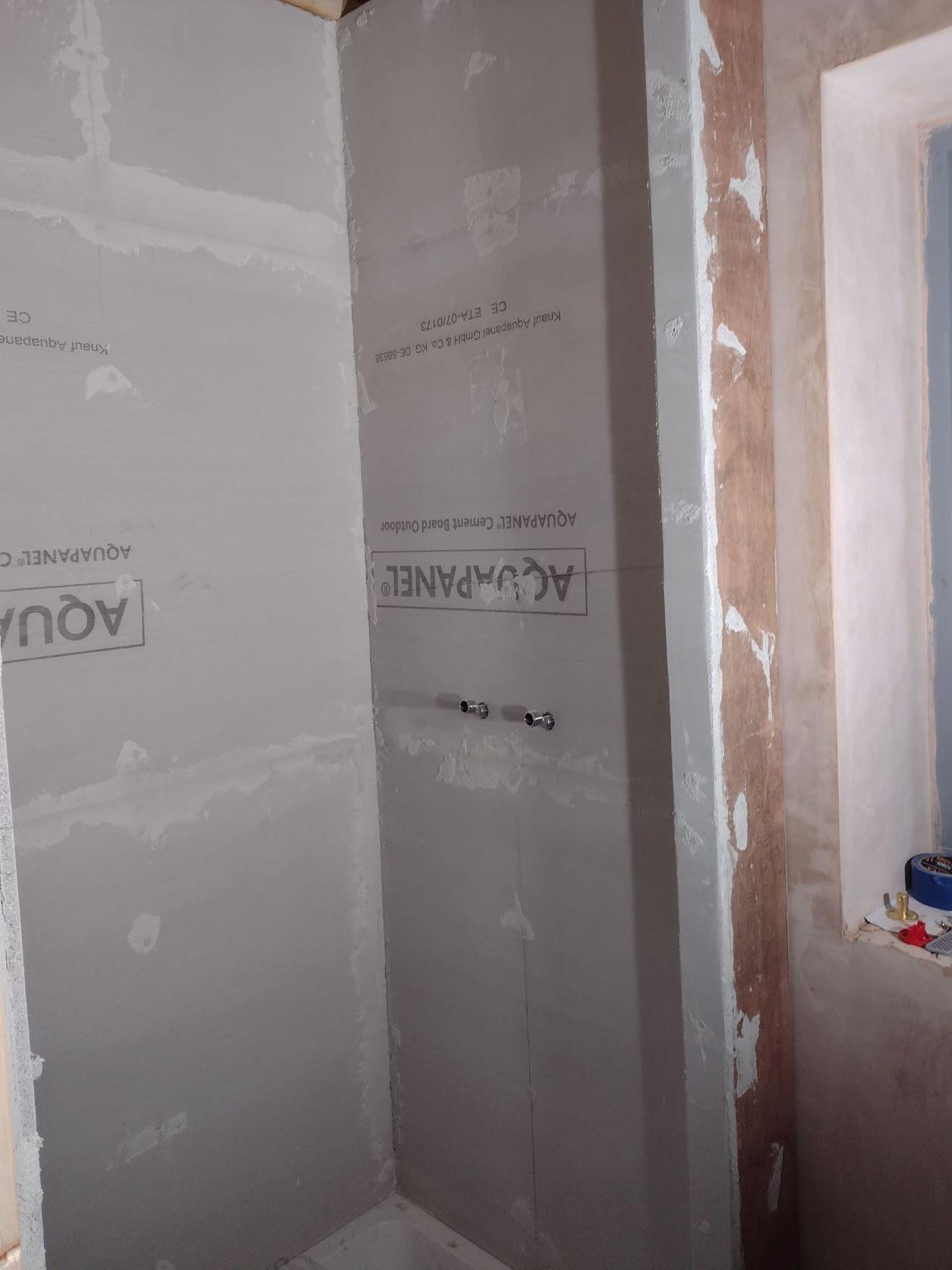

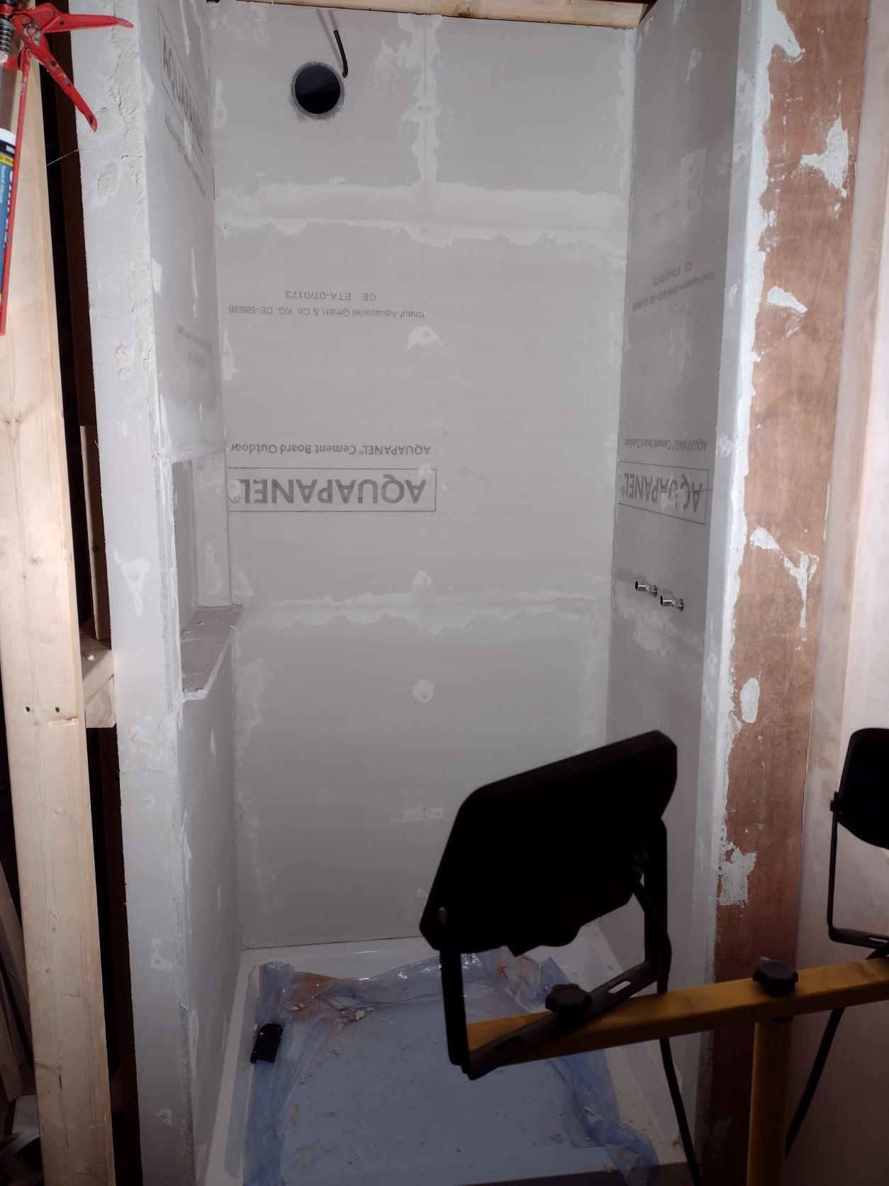

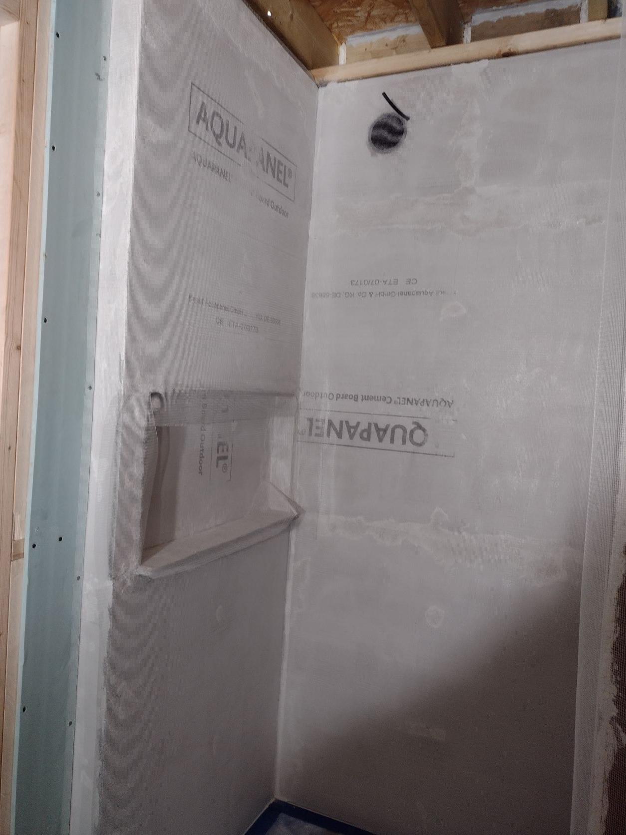

I've just started with microcementing a shower now. Decided to use an ensuite for the experiment so if it goes wrong, nobody's really going to notice
Here are photos of 1st stage - boarded with Aquapanel Outdoor as the base because I had 3 panels knocking around, but you can use plaster and skim, plasterboard, and even plywood as the base.
At this point I've just filled the countersunk screw wholes, joints and gaps with the microcement base coat. Nothing out of the ordinary just recording the steps for anyone interested. Tomorrow will be sanding it all down and then hopefully applying basecoat and mesh.

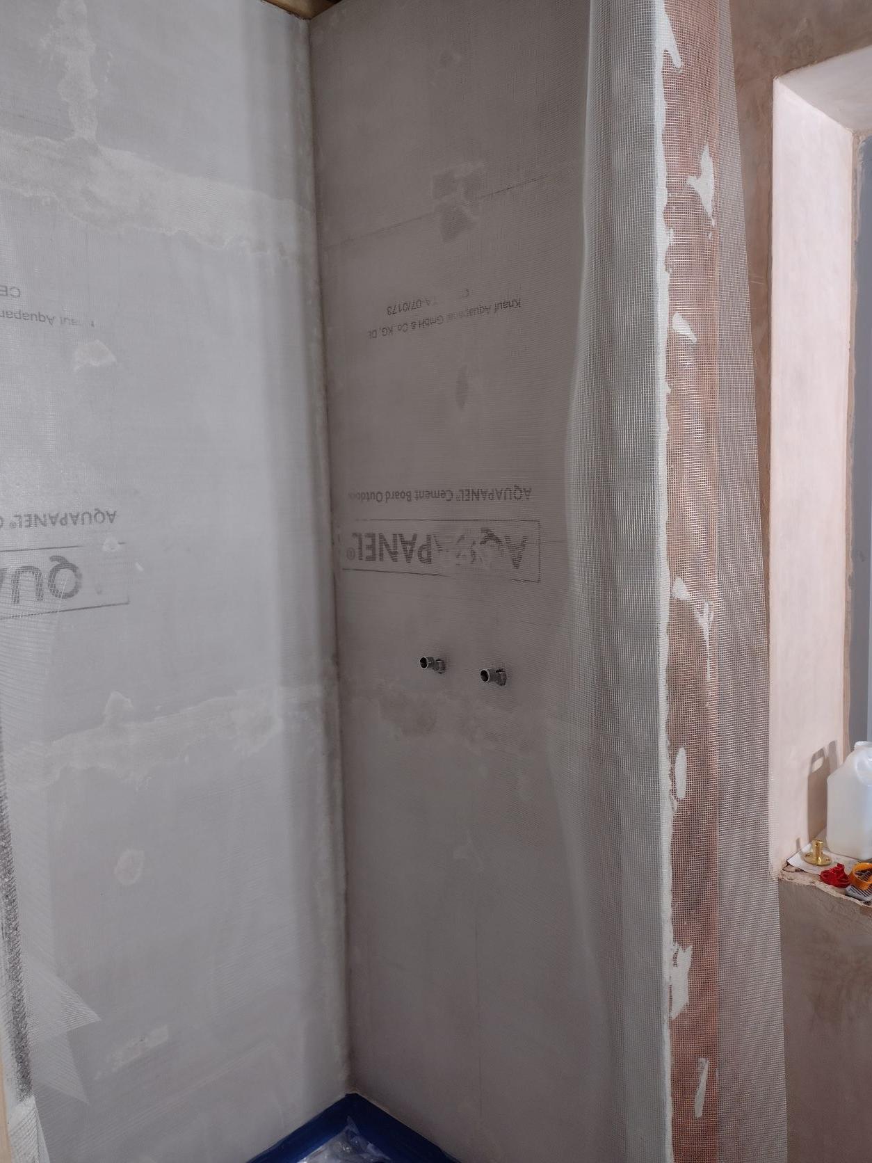

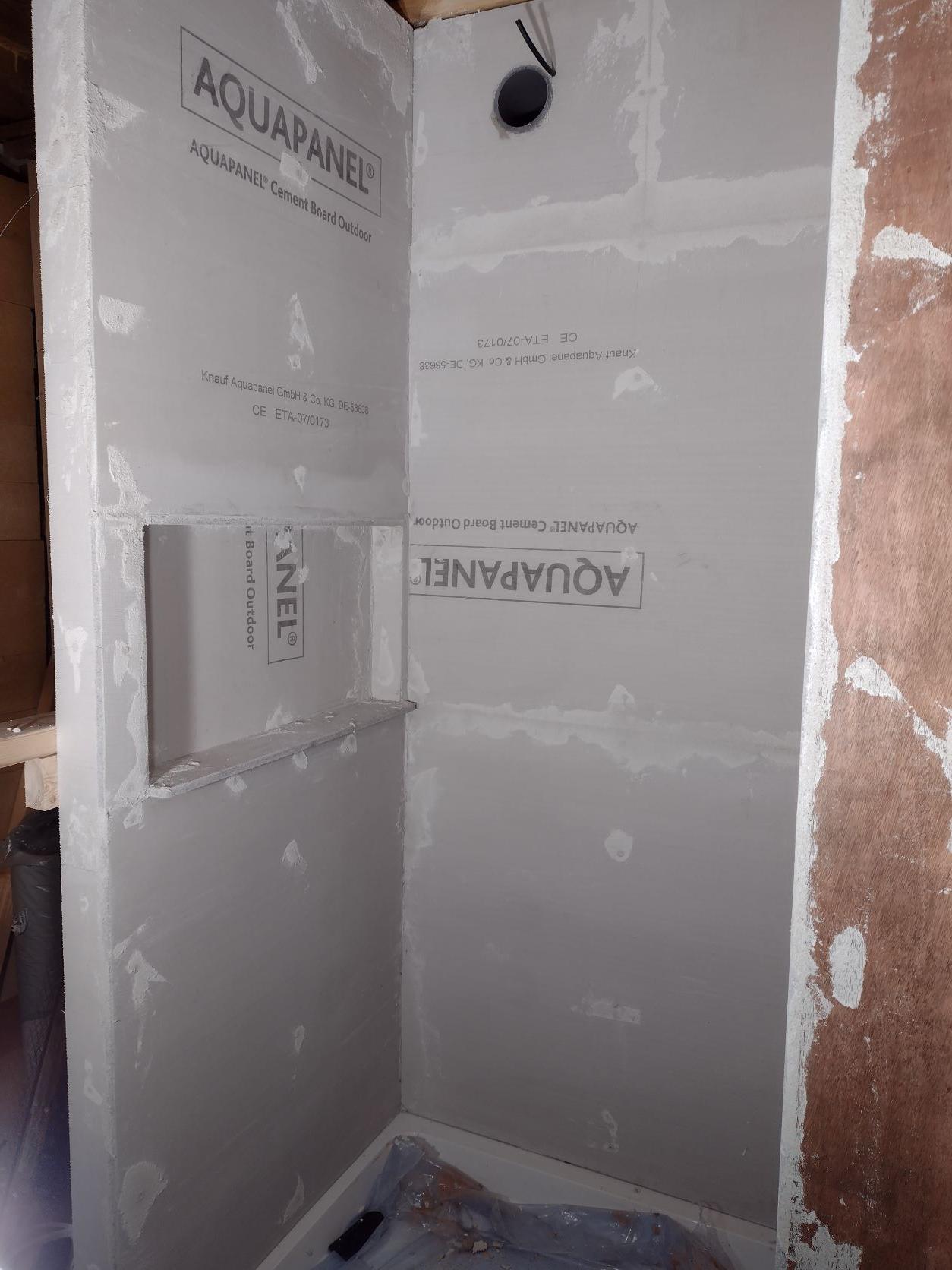

Day 2 of the ensuite now with step 2, 3 and 4 of microcement preparation.
Step 2 was to sand down the basecoat used to fill the countersunk screws and joints, but I have to say this was a pain. Next time, I think I'll use the Knauf Aquapanel skim and/or filler as the microcement basecoat has aggregate in it so it's impossible to feather out the edges and it's really hard so destroys the sanding pads on the orbital sander. Took ages to only get a moderately good finish here. I'm hope the minor blemishes will be filled when coating.
Step 3 just to apply the primer to the boards.
Step 4 to add the reinforcing mesh which basically gets stuck to the primer (kind of - it just holds it in place for the microcement basecoat.
Next step is to apply two coats of the basecoat, one uncoloured, the other coloured.
Pictures attached of the stages completed today.

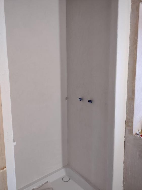

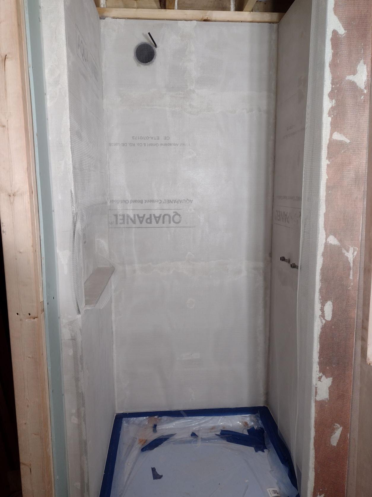

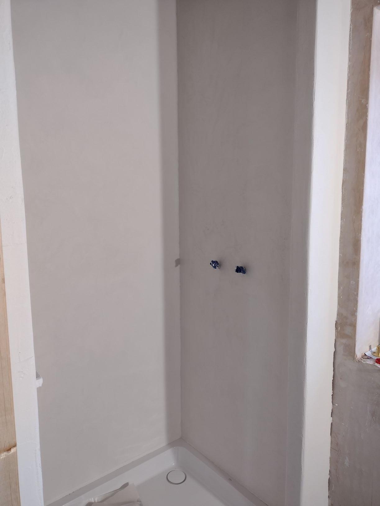

Okay, so next stage done now with 2 coats of the basecoat.
I've some mistakes in that I used the basecoat to fill joints and countersunk screw holes and I used the microcement mesh across all the corners. This meant that I used a bit too much basecoat and ran a bit short on the second coat! I also used the mirocement mesh on both internal and external corners, which was not great. Next time I'll use normal scrim tape on any corners. Having never done this before I may have applied the first coat slightly too thick too. Anyway, not too much of a disaster. All that has happened is the small wall area within the built in shelf will need to be tiled at the back and sides.
Applying the basecoat is really quite similar to applying thin coat render on external wall insulation, but it's a lot thinner, with each layer being only approx. 1mm.
I'm going to allow this cement to set overnight and tomorrow, first sand down this layer and then apply two more layers of a slightly different cement layer with what looks like a finer aggregate, but is still trowelled on like the basecoat.
Overall, I'm quite  happy with how it's turning out.

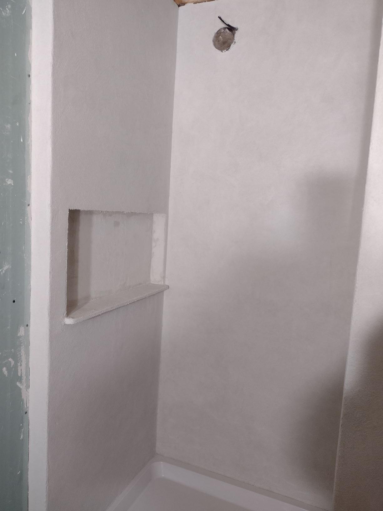

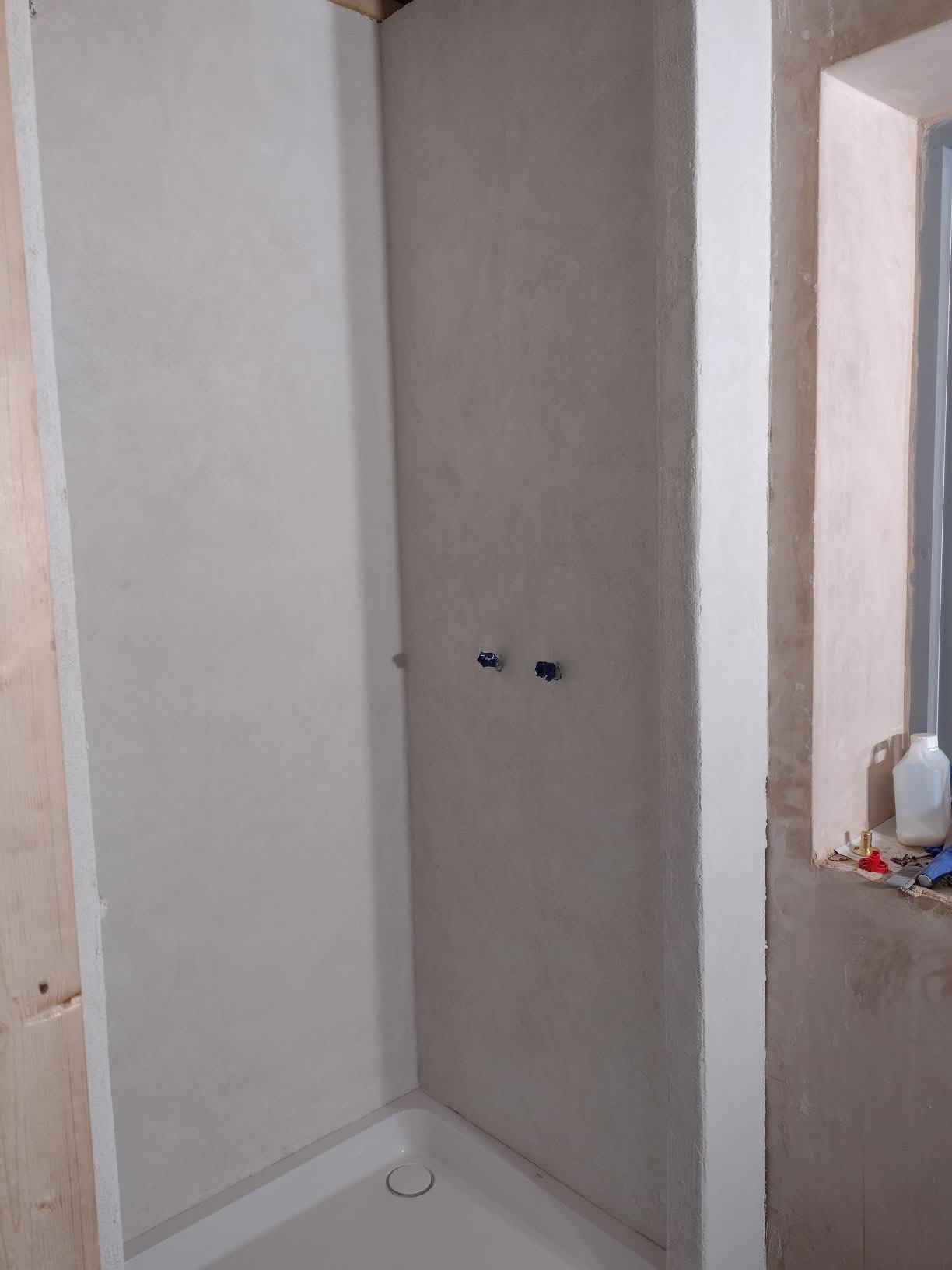

Next stage finished and allowed to set for 24 hours. This layer was much easier to apply than the 2 basecoat layers, buttered on nicely and gives a nice texture to the wall - you may not see it in the photos but the white has soft whisps of grey so it's not an entirely uniform white. Now I just need to sand this down lightly and apply what look to be runny types of resin, not quite the same as epoxy resin.
The instructions are slightly confusing as with this kit I have 2 types of finishing coat, one durable, one extremely durable. I've been supplied with enough to apply two coats of each but the instructions only suggest one coat of each. If I apply 2 coats of each, I'll have to wait 12 hours between each coat, which obviously extends the finish time by quite a bit, but I'm erring on the side of caution so leaning towards 2 coats of each, just to be thorough.
Pics of the second microcement layer:

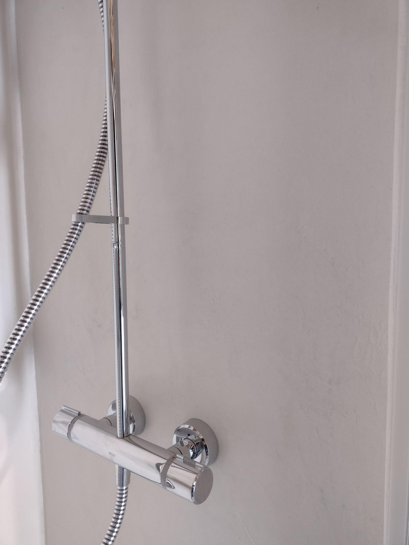

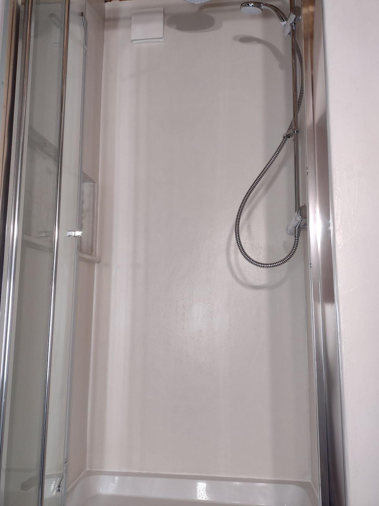

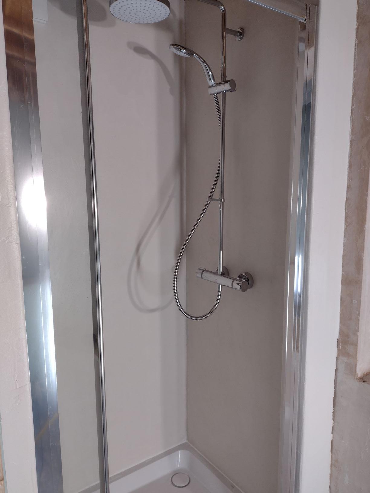

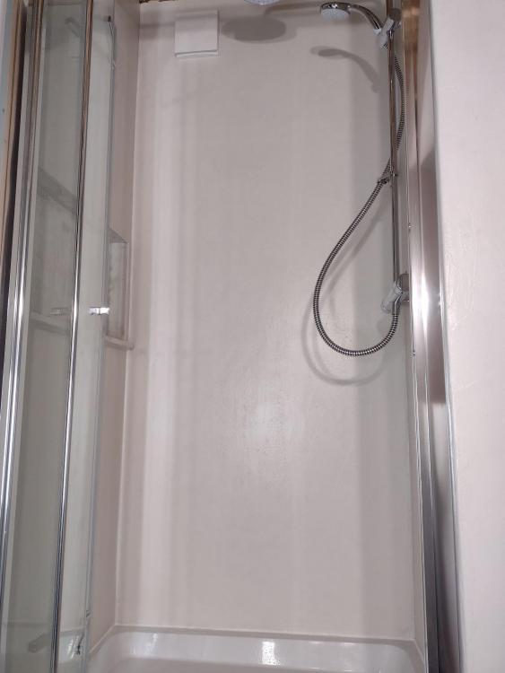

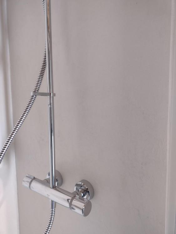

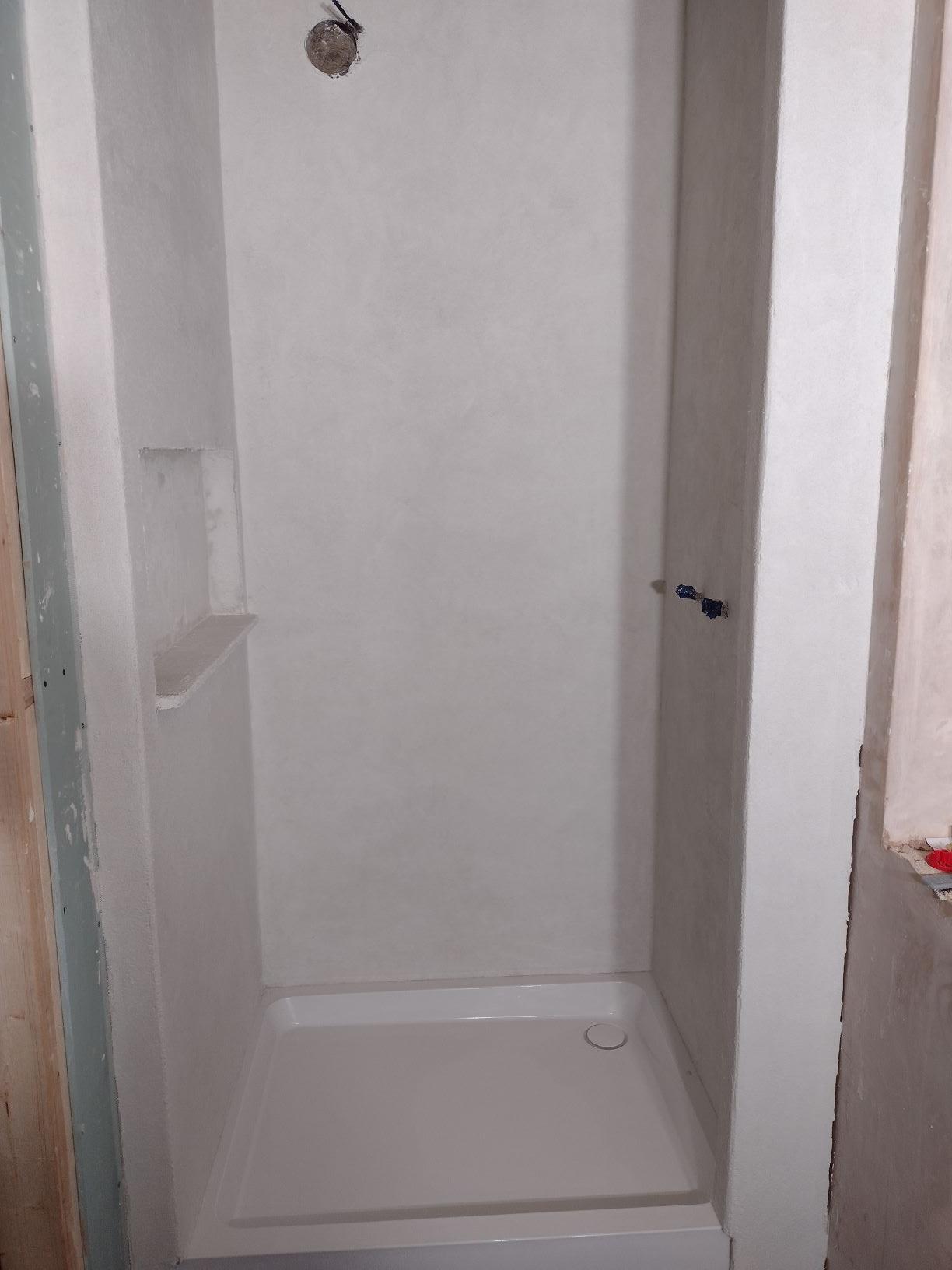

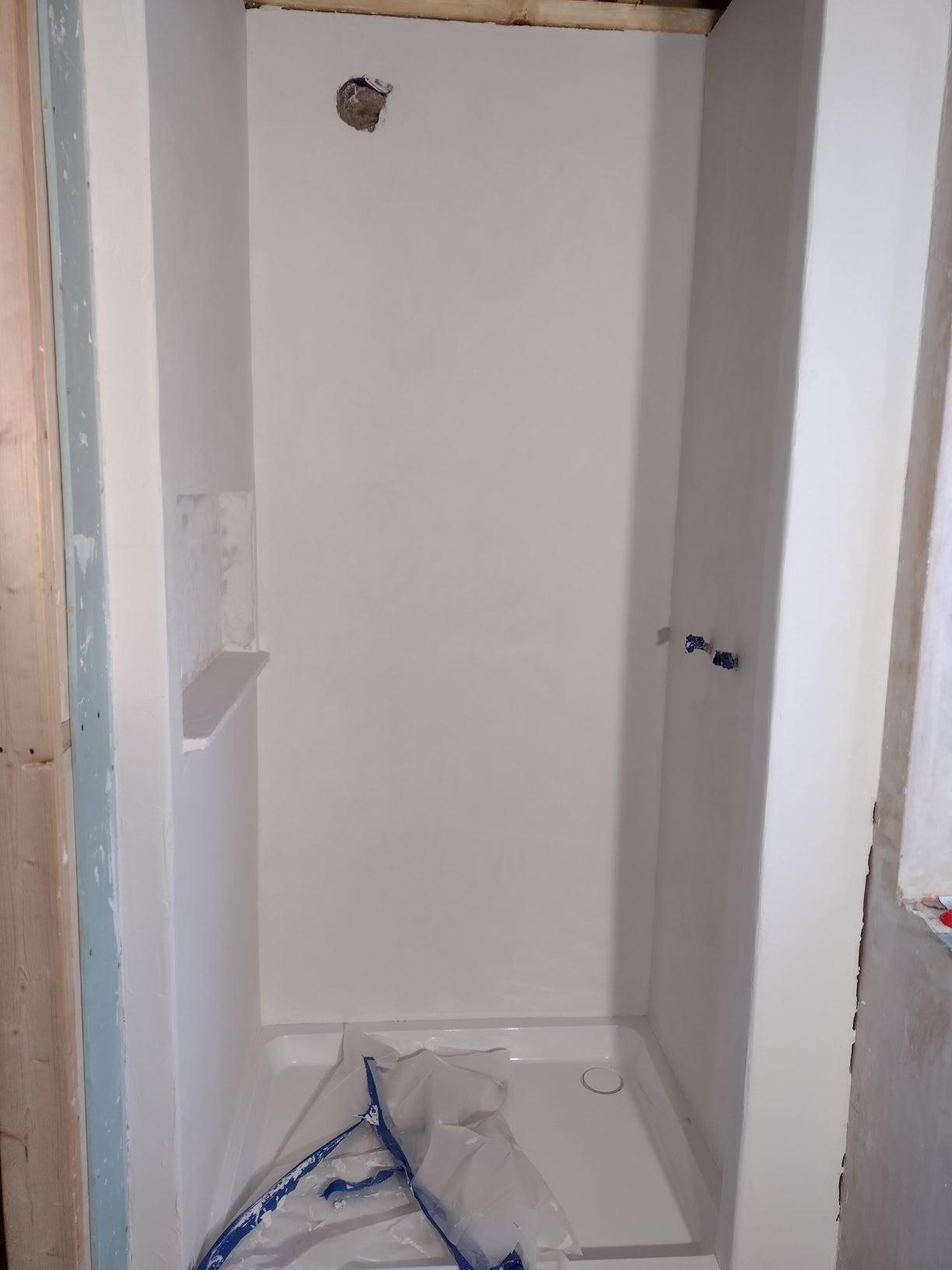

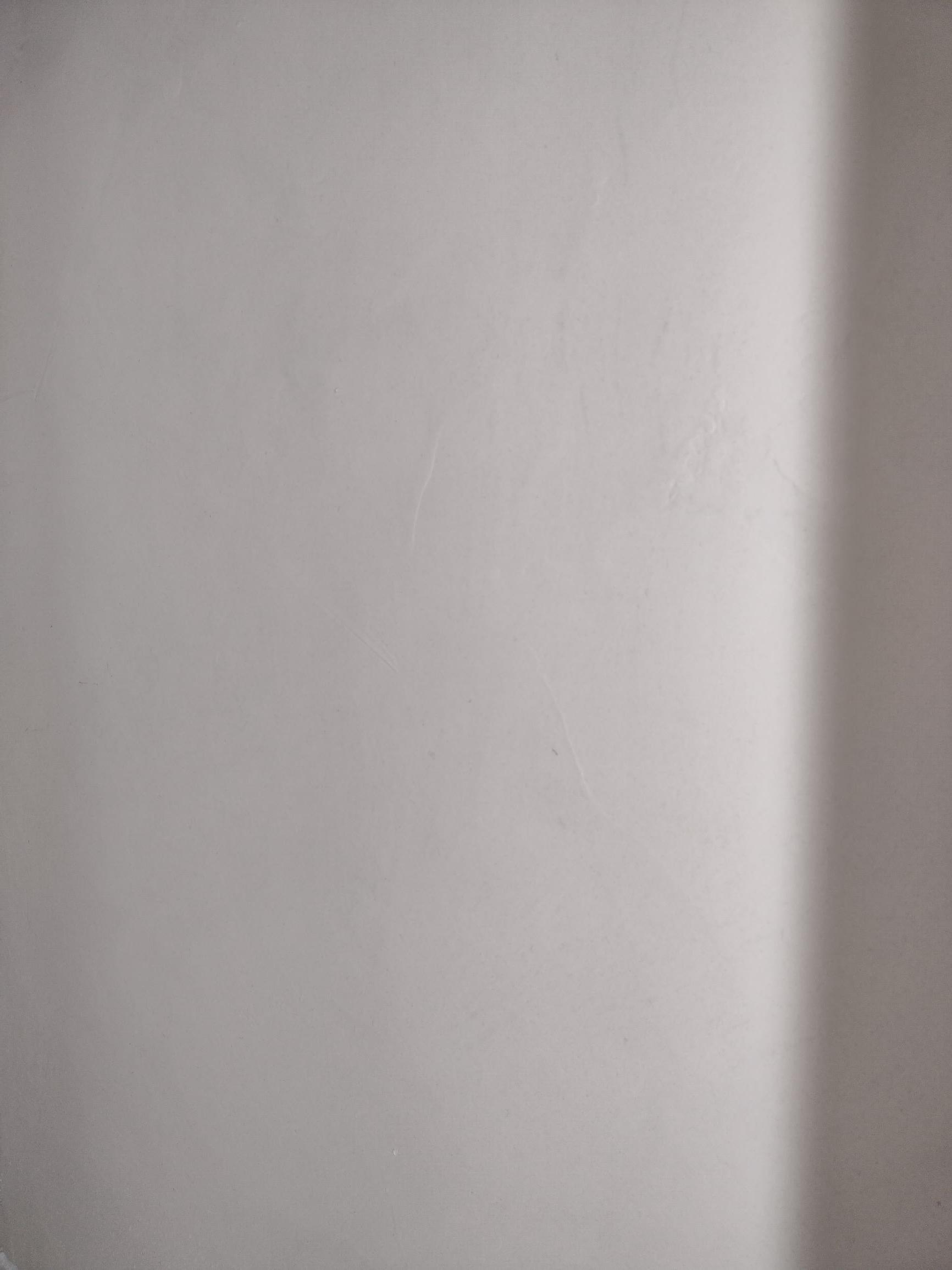

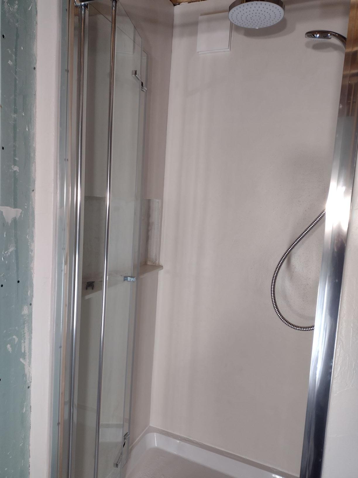

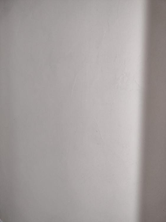

Okay, I've done the shower enclosure now. In total 4 coats of finishing resin since my last post, two coats each of a different type. Each coat sanded with 400 grit paper. I'm ever so slightly worried about the final coat as I was slightly short on hardener for this coat so I hoping it is hardy enough. However, if it isn't I can always get some of the same 2 part resin and re-coat.
I've also put in the shower, shower door etc. but just waiting for tiles to put into the back and side of the built-in shelf.
I'm very happy with how it's turned out. I like both the look and the colour (Montblanc White). Now we just have to see how it stands up to some abuse and I'll report back over time.
Below are final photos where I've added a couple in the hope it shows the colour and texture in close up, but may not work.
Hopefully this may help anybody looking at microcement in their shower.

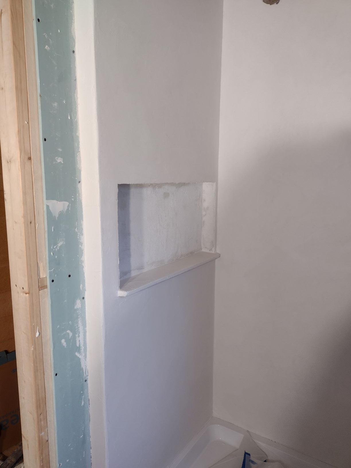

I’m thinking of doing our niche with microcement finish. @SimonD is your noche made of cement  board or something else?
Yes, mine uses Knauf Aquapanel, but you can just as readily use skimmed plasterboard, or even plywood as the base.
