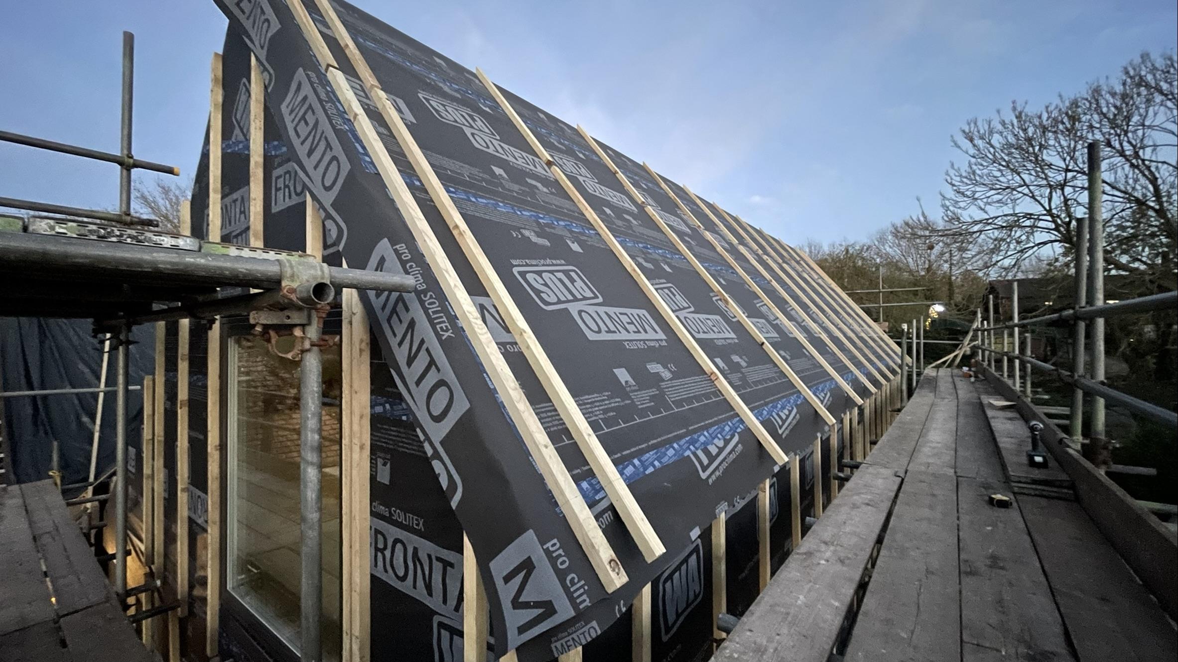

BenP Posted December 6, 2021 Posted December 6, 2021 Hi, We've just today put the final fixing in for our wood fibre sheathing board on roof and wall. 60mm on the walls too. As you suggested, we've used the Ejotherm fixings to hold the sheathing board back to the timber frame. Typically a couple per board. We're now in the process of fixing back the vertical battens with Heco fixings (https://www.heco-schrauben.com/screws-accessories/screws/heco-topix/). 180mm perpendicular (straight in) and 200mm at 60 degrees (for suction and sheer). We ordered the insulation through Ecological Building Systems who organised a fixing plan from Heco. I think you can go direct though. The plan basically says where fixing centres are closer together (i.e. corners of the building). Whereas the middle of the long walls the spacings are much further apart saving on screws. Couldn't quite believe the cost of the them though..... Pic for good measure.... (every other batten done for now as I'm working through limited stock!) Cheers 1

BenP Posted January 6, 2022 Posted January 6, 2022 On 19/12/2021 at 21:46, hotnuts21 said: @BenP have you used doubled up batten around the Windows to give a 50x50 perimeter? Did you have to wrap them in dpc? Hey - sorry for the delayed reply - it's been a busy yet productive Christmas. Remaining windows are finally going in today too! Not quite sure understand the question.... The double batten you can see it just two close to each other to ensure 600 fixing centres for the cladding and as per the timber frame within. No DPC either although I have decided I'm going to redo some of the battens to leave a small gap so I can introduce a small 'tray' to get any water coming down the membrane away from the window head.
