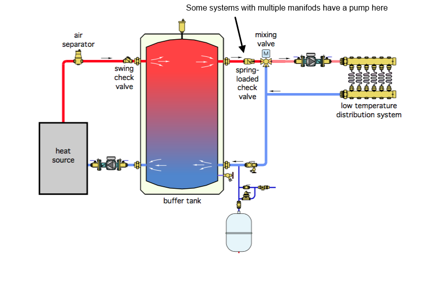

owh2021 Posted October 31, 2021 Author Share Posted October 31, 2021 Many thanks both. Stones, I think I understand what you are saying re. running as a single zone. The problem with that for the way we live is that we tend to have the bedrooms quite cold and the bathrooms/living rooms warm. That makes running the first floor as a single zone particularly difficult. I could also see some difficulty balancing things whereby we would have some rooms overheating whilst the bathroom is still trying to play catch up - as I'm convinced there isn't enough ufh pipework in there. How exactly would it work installing a buffer? As simple as 2 ports - return-in and return-out on the primary return? That would solve the volume issue but would it do anything to improve flow rate with only one or two small circuits calling for heat. Presumably given enough time with low demand, the buffer temp would also match the flow temp, then the unit goes back into cycle mode, and the UFH loops can't benefit from all the hot water in the buffer because for some reason the heating pump also turns off with the cycling. OR perhaps the pump will continue to run, supplying heat to the ufh because there will no longer be such a flow restriction... Clearly I'm confusing myself, but I can at least approach the installer now and see what they suggest. Link to comment Share on other sites More sharing options...

Temp Posted October 31, 2021 Share Posted October 31, 2021 (edited) We effectively have a 4 port buffer (actually a TS) so I can describe that.. The boiler and UFH sides of the TS are totally independent. They only share a fused spur. The boiler (in our case oil fired) and its pump is controlled by a thermostat on the TS. If the TS is cold it fires the boiler which runs flat out until the TS is hot. Ours set up relies on the hysteresis of one mid height thermostat but its probably better to have two stats one nearer the top and one nearer the bottom of the tank to control the boiler/ASHP. Ours seems to work fine though. On the output side.. There is a pump on the output side of the TS that circulates water from the TS to the UFH manifolds and back to the TS. This is controlled by the room stats. Our UFH manifolds have a control box that performs a logical OR on the room stats to control the manifold loop pump and this also generates a Boiler Enable (BE). Its called BE because without a TS it would normally control the boiler. In our case these 2 BE signals are OR'd together to control the pump on the output of the store only. So the UFH treats the TS as if it was a boiler. It calls for heat as and when the room stats demand. The boiler only fires up when the TS becomes depleted. Our TS also supplies DHW and powers a towel rail in much the same way as the UFH. eg If someone has a shower the TS might become depleted and trigger the boiler but a bit of hand washing probably wouldn't. Difference between 2 and 4 port.. There is little difference between a 2 and a 4 port in the way they work and are controlled. With a 2 port the hot goes in and out of the same ports on the buffer where as on a 4 port it flows "across" buffer tank. (I think there might be an additional one way valve on the 2 port to make sure water is drawn from the buffer not the ASHP when the ASHP is off?) The 2 port has some advantages which make it better if you just need a buffer... 1) The flow rate into the buffer is lower as some goes direct to the UFH. This is claimed to reduce turbulence and provide better stratification. 2). The UFH gets access to the hottest water direct from the source some of the time. Perhaps more important for ASHP than an oil boiler? 3) The tank is slightly cheaper to make. 4 Port 2 Port Source: https://blog.heatspring.com/2-pipe-versus-4-pipe-buffer-tank-configurations/ Edited October 31, 2021 by Temp Link to comment Share on other sites More sharing options...
owh2021 Posted November 1, 2021 Author Share Posted November 1, 2021 Thanks Temp, really helpful. Looks like I had totally misunderstood how a 2-port buffer works. I think that looks like the best solution if we have the space for it. Time to see whether the installers agree if a buffer should have been designed in. Link to comment Share on other sites More sharing options...
