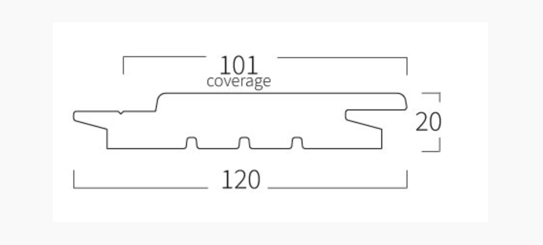

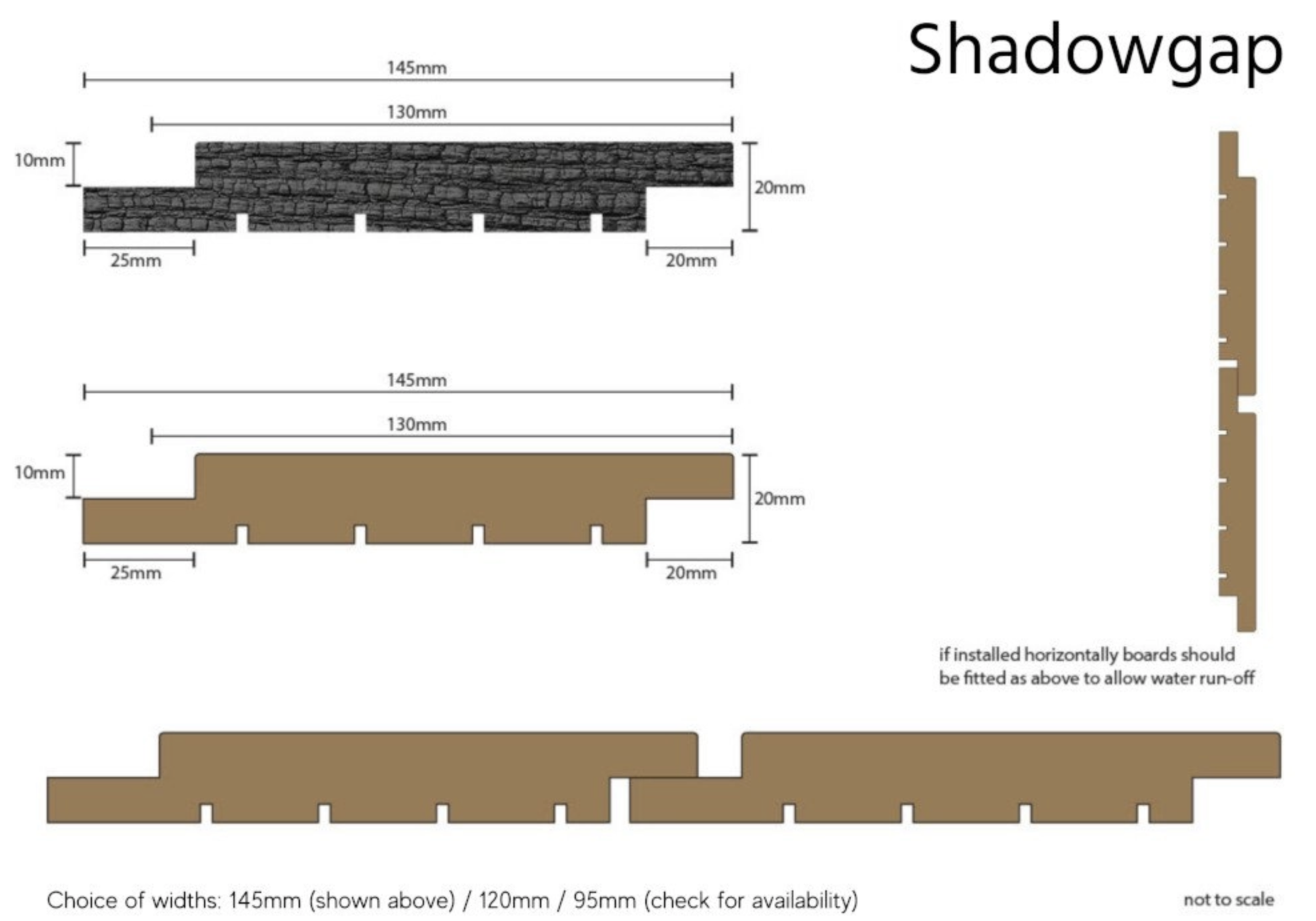

Thorfun Posted October 29, 2021 Share Posted October 29, 2021 We're planning on Shou Sugi Ban timber cladding (https://shousugiban.co.uk/range/charred-larch-cladding/) on the majority of the outside of our house with a shadow gap. We already have a black breathable membrane so we will need to paint the timber battens black to ensure they don't show through the shadow gap. I was just wondering if anyone had any experience as whether it's best to use an exterior paint or a wood preserver type product? and if any particular product is better than any other? and any other recommendations? Link to comment Share on other sites More sharing options...

shirebuild Posted June 8, 2022 Share Posted June 8, 2022 There are 8mm gaps between each plank of timber and depending on which way the sun is shining you can see the battens through those gaps to a greater or lesser degree. Now it’s done I feel it was 100% the right decision to paint em. @Mr Punter not sure what you mean about getting the cladding to line up with the brickwork? 1 Link to comment Share on other sites More sharing options...
Mr Punter Posted June 8, 2022 Share Posted June 8, 2022 10 minutes ago, shirebuild said: There are 8mm gaps between each plank of timber and depending on which way the sun is shining you can see the battens through those gaps to a greater or lesser degree. Now it’s done I feel it was 100% the right decision to paint em. @Mr Punter not sure what you mean about getting the cladding to line up with the brickwork? That makes sense. I didn't notice the gaps in the photo. Be interesting to see how much the gaps grow and shrink with the seasons. I have some 140mm wide hardwood ipe decking that we fitted butted up and it can have now have gaps of about 15mm in the summer. I thought this may be a timber frame and you were wanting the cladding to be flush with the face of the brickwork below? Link to comment Share on other sites More sharing options...
shirebuild Posted June 9, 2022 Share Posted June 9, 2022 19 hours ago, Mr Punter said: That makes sense. I didn't notice the gaps in the photo. Be interesting to see how much the gaps grow and shrink with the seasons. I have some 140mm wide hardwood ipe decking that we fitted butted up and it can have now have gaps of about 15mm in the summer. I thought this may be a timber frame and you were wanting the cladding to be flush with the face of the brickwork below? The gaps are pretty unnoticeable until you get closer. I would have had them bigger but felt it didn't look quite right up close (i.e. when sitting on the future patio) and also nervous about increasing exposure of the membrane to the elements. Ooh good to know, yes it will be interesting to see how the gaps behave at different levels of moisture. It is a timber frame and yes there are counterbattens to bring it out to the correct depth for the windows. The first floor is bigger than the ground floor though, so on that elevation pictured, the upstairs overhangs by 60cm. At the front it's just over 2m. Link to comment Share on other sites More sharing options...
