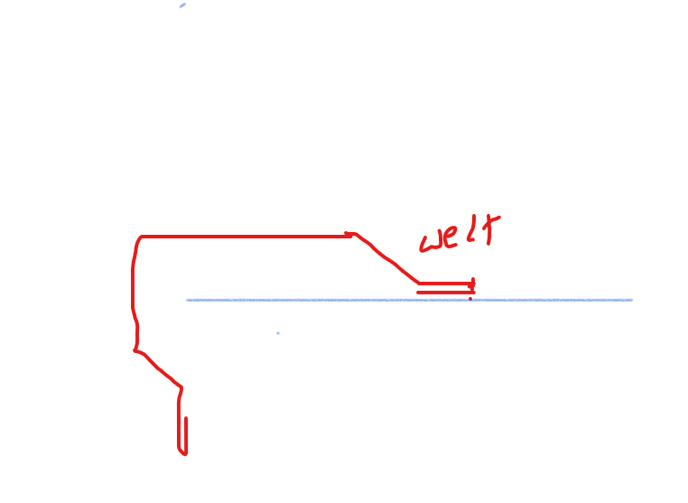

saveasteading Posted October 28, 2021 Posted October 28, 2021 Agreed with Iceverge. OR you need a decent slope and also an utterly watertight seal of metal to roof, using mastic and lots of screws (which you should anyway. I would lap the roofing over the edge so that any stray dribbles go outside your wall cladding. Even better would be to dress the roof covering up a batten that forms an edge. the metal trim is best not being 2 flats faces like that, as that will distort when screwed. better to have it shaped like my dodgy sketch attached. the 180 returns are 'welts' and stiffen considerably, as do the other bends. That will look much stsraighter and allow much tighter (and more watertight) fixing, with a bead of special mastic underneath. That will cost twice what a 90 deg one will, so is up to you.

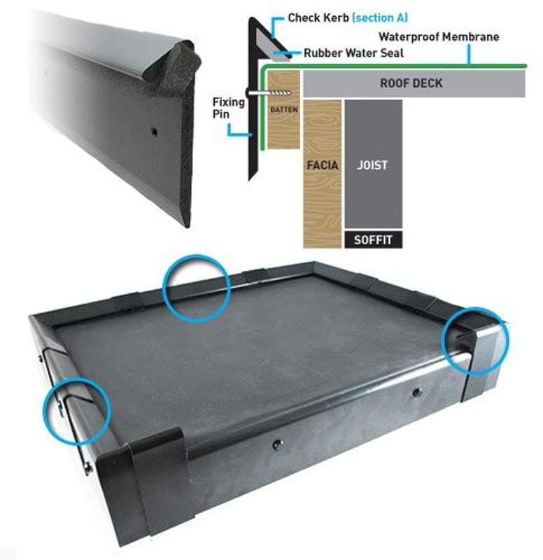

Gordo Posted October 28, 2021 Posted October 28, 2021 (edited) Haven’t seen that trim before. Big improvement on what I saw in past. Not a fan of EPDM flat roofing due to the weakness sealing joints. You will need a ballast also to hold it down if I recall correctly. Haven’t seen this used much nowadays. Best go for PVC or GRP in my humble opinion. Particularly PVC where I have experience of giving 40 years leak free service Edited October 28, 2021 by Gordo

SimonD Posted October 29, 2021 Posted October 29, 2021 20 hours ago, jamesmonk83 said: My query concerns where the wall build-up of battnes/cladding sheets meets the roof/roof trim. What metal cladding are you using? Basic corrogated sheets or standing seam? If it's standing seam you need a board directly behind the cladding, ideally with a membrane behind it. You also need to make sure you have a continuous 25mm ventilation gap at the top and bottom of the cladding. Check curb looks good but you can also rip some chamfered timber and take the epm over that. That would be my preference as you then don't need the rubber water seal or mastic sealant.
