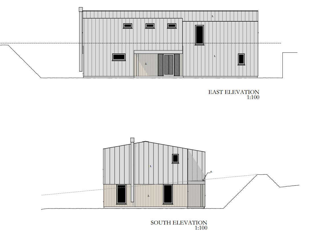

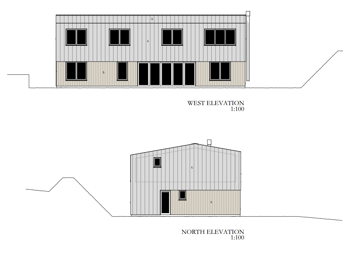

TBlew Posted October 28, 2021 Share Posted October 28, 2021 Hi, Just a quick introduction to myself and why I'm on here. My wife and I have just started a self build down in Cornwall. Using insulated raft, ICF wall construction with a SIP roof. Aiming for an efficient, air tight build with low running costs. That's the dream anyway. Lots to learn & get your head around. So I'm sure I will have lots of questions and will try to help as much as possible where I can. Our project is a barn type build, that we are trying to do as much as we can ourselves. We've already excavated the site, started our gabion basket retaining wall and had our first 2 utilities connected last weekend. Cheers! Link to comment Share on other sites More sharing options...

Iceverge Posted October 28, 2021 Share Posted October 28, 2021 Looks good. Any plans to share? Have you thought about provisioning for overheating, lots of westerly glazing. Maybe Aircon or external blinds. Link to comment Share on other sites More sharing options...
SteamyTea Posted October 28, 2021 Share Posted October 28, 2021 Just had a better look at your plans. Roof not the best angle for PV. 1 Link to comment Share on other sites More sharing options...
ProDave Posted October 28, 2021 Share Posted October 28, 2021 6 minutes ago, SteamyTea said: Just had a better look at your plans. Roof not the best angle for PV. It would do an E/W split which would give lower peak generation but more early and late generation which is better for self usage. Link to comment Share on other sites More sharing options...
TBlew Posted October 28, 2021 Author Share Posted October 28, 2021 2 minutes ago, ProDave said: It would do an E/W split which would give lower peak generation but more early and late generation which is better for self usage. We have a south facing roof on our detached garage that we are planning to utilize first, and then the rest split over the house as you have suggested. Just in talks with solar company for our arrangements etc. 16 minutes ago, Iceverge said: Looks good. Any plans to share? Have you thought about provisioning for overheating, lots of westerly glazing. Maybe Aircon or external blinds. Thanks, yes something i have thought about, hoping to add a cooling unit to our MVHR system. Do you know how effective these are? External blinds/sun shades could be added if needed. 19 minutes ago, SteamyTea said: Welcome. Cornwall is a big country, which part you in. There are a few members building at the moment in SE Cornwall, and one or two up NE. Not many down in Penwith. Carrick, Mid Cornwall, North Coast Link to comment Share on other sites More sharing options...
Iceverge Posted October 28, 2021 Share Posted October 28, 2021 15 minutes ago, TBlew said: Do you know how effective these are? External blinds/sun shades could be added if needed. Not great. MVHR is a good for ventilation, not much else. Shades only work on southern elevations really due to the low sun angle east/west. 2 Link to comment Share on other sites More sharing options...
SteamyTea Posted October 28, 2021 Share Posted October 28, 2021 4 hours ago, ProDave said: It would do an E/W split which would give lower peak generation but more early and late generation which is better for self usage. Was thinking more of the altitude angles than the azimuth angles. But if it is near St. Agnes it won't make much difference. If you can see St. Agnes Head it is about to rain, if you can't see it, it is raining. Link to comment Share on other sites More sharing options...
