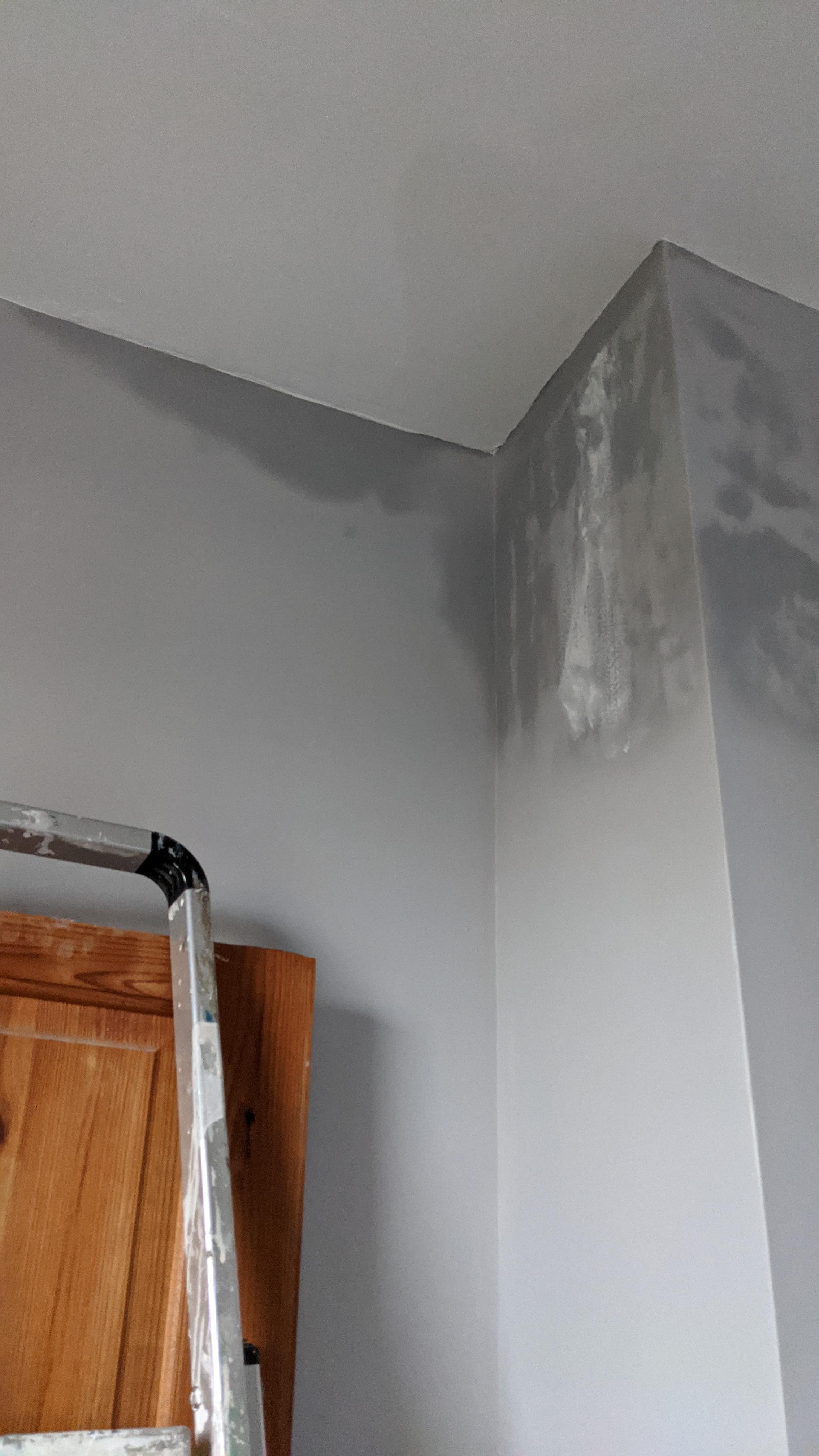

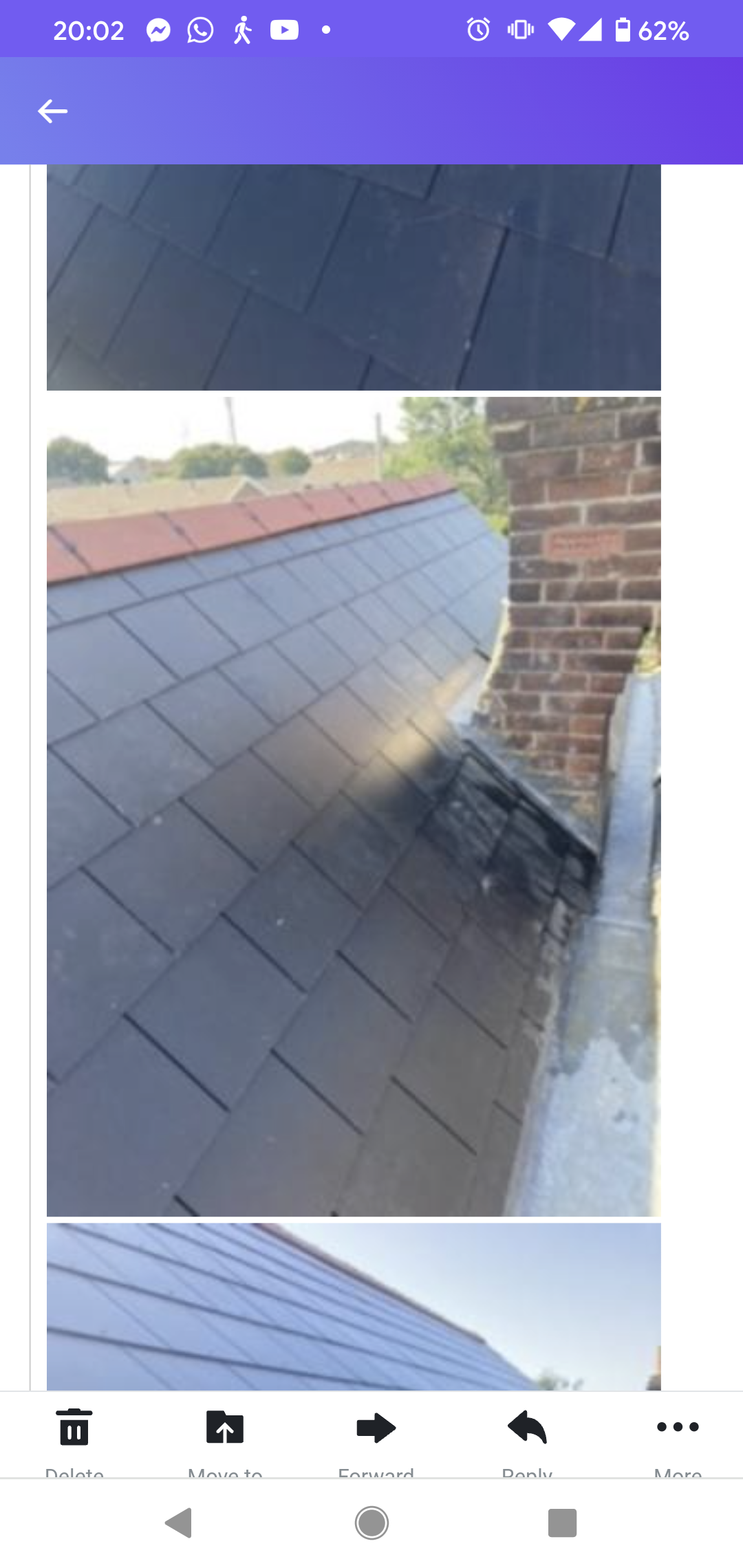

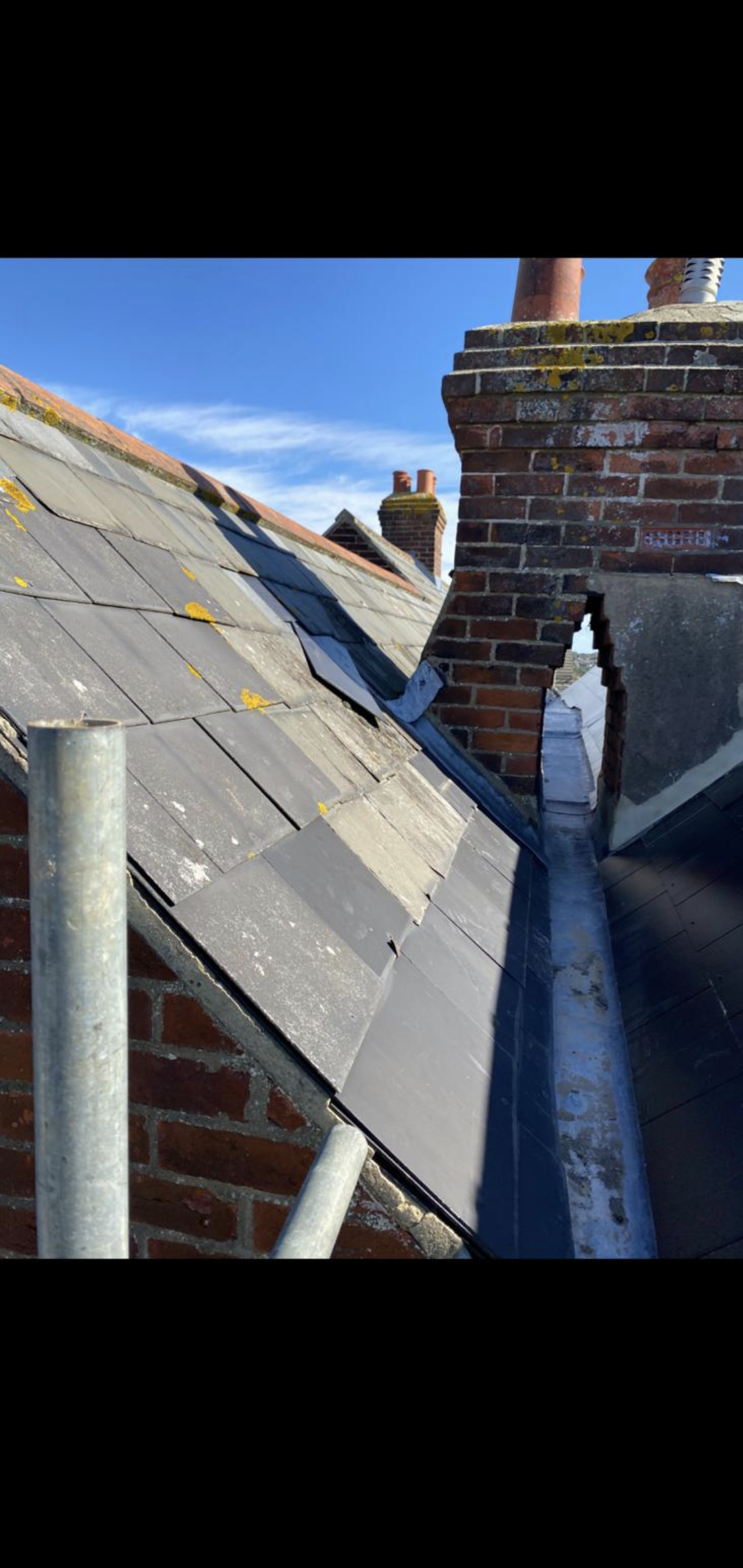

Kayte Posted October 23, 2021 Share Posted October 23, 2021 Hi! I noticed a few helpful posts on here previously about other spots of bother we've had in our house. And found these forums quite valuable. Here I am to ask my own question this time. We have evidence of water coming in around our chimney. Pretty significant amount since the weather's changed. We asked next door, as this chimney is connected to theirs, and they said that have no evidence of damp or water marks. We had our roof redone last year, so had convinced ourselves it must be their side. (This roofer is uncontactable since trying to contact about this incident). Upon consulting 2 new roofing companies, we have had 2 conflicting answers. Roofer 1, said firstly, the flashing job on our chimney is little to none. So that's one issue. The other is that ours and our neighbours do not have lead trays - which is the bigger problem overall. He said to fix the issue completely we should remove the stacks entirely, or rebuild. No other options. Roofer 2 said the issue causing the water will be the lack of soakers and flashing, no real need to remove the stacks. My question is. By keeping the stacks, would I be fixing the issue short term? We plan to talk to the neighbours tomorrow. We would ideally like to remove our stacks to under roof level and slate over. But if they refuse to have it removed, we will have to pay for their rebuild fees (roofer 1 said its a lot more ££ to rebuild). I am struggling to find rights regarding joint chimneys. It is in their best interest to have it removed, so I hope they see sense. They don't use their chimney. Neither do we. The photos are for reference. If anyone can offer advice I would be greatful. Our roof is the side with the new tiles. Will we be ok if we leave them and just add better flashing and soakers? Link to comment Share on other sites More sharing options...

nod Posted October 23, 2021 Share Posted October 23, 2021 I haven’t read the above answers So apologies for any contradictions My first thought with that amount of water ingress would be the tray or lack of I would only take the chimney down as far as the red brick in the first pic Add the tray and weeps and rebuild Link to comment Share on other sites More sharing options...

Brickie Posted October 23, 2021 Share Posted October 23, 2021 Was the lead valley redone as part of the other works carried out? Yes,a lead tray is desirable but on the other hand there are literally thousands upon thousands of chimneys like yours without them & theyre not causing damp penetration to the extent you have. Link to comment Share on other sites More sharing options...
Temp Posted October 23, 2021 Share Posted October 23, 2021 4 hours ago, Kayte said: Roofer 2 said the issue causing the water will be the lack of soakers and flashing, no real need to remove the stacks. If there really is a lack of soakers that would explain a lot. I can see they replaced the cut in flashing with stepped flashing but its the soakers that do 90% of the waterproofing. The soakers stop water running down the roof from getting in. The flashing basically just stops rain getting down behind the top edge of the soaker (eg rain running down the side of the chimney). I don't suppose any of them took better close up photos to show you soakers were missing? Video on soakers and flashing.. https://youtu.be/7PB0yLt5v3k https://youtu.be/j3pQ5cEoacE Link to comment Share on other sites More sharing options...
