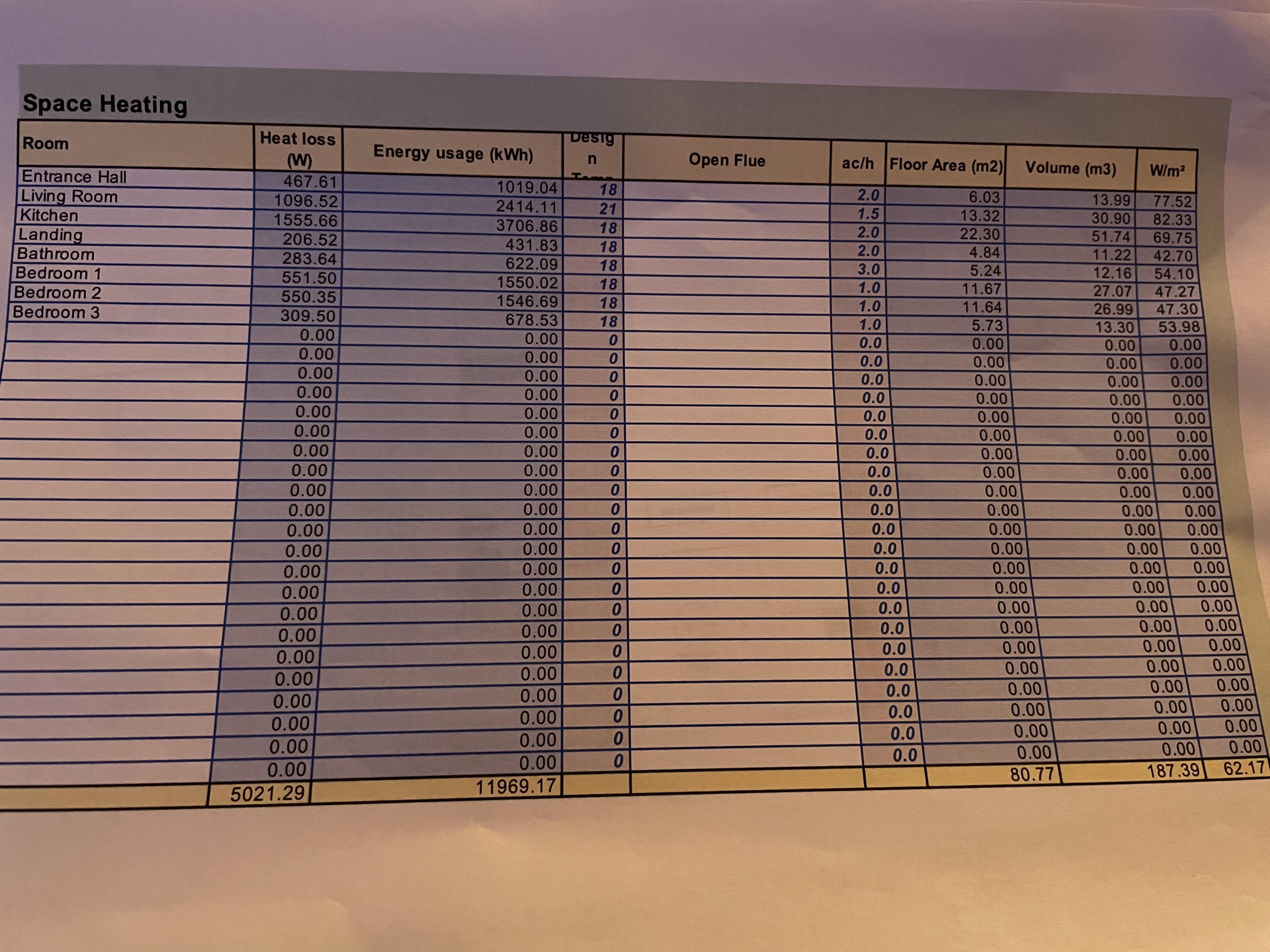

Jordan Posted October 20, 2021 Author Share Posted October 20, 2021 I haven’t found this from the paperwork the installers sent be I assuming this is the heat loss calculations they have done however I have no idea how to make sense can anyone help to see if a 6kw ashp is sufficient Link to comment Share on other sites More sharing options...
IanR Posted October 20, 2021 Share Posted October 20, 2021 (edited) 27 minutes ago, Jordan said: I haven’t found this from the paperwork the installers sent be I assuming this is the heat loss calculations they have done however I have no idea how to make sense can anyone help to see if a 6kw ashp is sufficient 18°C Design Temp seems a little low to me, did you give them this as your target internal temp? It would be good to know what outside temp this was done for. Are you very air tight? The Air changes per hour ranging 1.0 - 3.0 is low for a "normal" house. The 5021.29 kW figure is the Total energy loss (assuming all rooms are shown on the sheet), at whatever outside temps they've allowed for. So you need 5kW of energy from your heating system to maintain the Design Temp. A 6kW ASHP doesn't provide much headroom for hot water production, nor raising the temp if you've let the temp drop. If they've used a very low outside temp, say -10°C, then maybe this would cover the lack of headroom. But, with the low design temp, low AC/h, and lack of headroom, at first sight the heat pump looks a little undersized. Edited to add: Do you historic data for how much Gas/Oil/LPG you used to use annually? Edited October 20, 2021 by IanR Link to comment Share on other sites More sharing options...
Jordan Posted October 20, 2021 Author Share Posted October 20, 2021 Thanks again for your reply we didn’t specify a preferred room temp this is just what they have done on there on own back. we are certainly are not very air tight built in the 1960’s 10 years plus double glazing and no cavity wall and poor loft insulation. this document shows some other data that may be helpful thanks again EPE - Nuttall NG4.pdf Link to comment Share on other sites More sharing options...
Jordan Posted October 20, 2021 Author Share Posted October 20, 2021 I think I was told all the calculations are done at -3 Link to comment Share on other sites More sharing options...
Jordan Posted October 20, 2021 Author Share Posted October 20, 2021 A thing also to add here is that the EPC was completed incorrectly sighting that we have good cavity wall and loft insulation, will this affect the calculations also? Link to comment Share on other sites More sharing options...
IanR Posted October 20, 2021 Share Posted October 20, 2021 It doesn't sound good. They should have used around 10 AC/h for your air tightness, and -3° is not low enough for worst case energy loss calcs. I'd ask them to take you through their calcs. Maybe they'll have an explanation. Link to comment Share on other sites More sharing options...
Jordan Posted October 20, 2021 Author Share Posted October 20, 2021 Ok I will speak with them tomorrow thank you for your advice, does the EPC affect these calculations? Link to comment Share on other sites More sharing options...
Jordan Posted October 20, 2021 Author Share Posted October 20, 2021 Is there anyway I can prove that they should have used a higher ac/h? Link to comment Share on other sites More sharing options...

IanR Posted October 20, 2021 Share Posted October 20, 2021 (edited) 47 minutes ago, Jordan said: Ok I will speak with them tomorrow thank you for your advice, does the EPC affect these calculations? The EPC also also states your properties heat/energy loss calcs, but they are done in a different piece of software, so should directly effect these calcs. 46 minutes ago, Jordan said: Is there anyway I can prove that they should have used a higher ac/h? Air tightness is measured at a 50Pa pressure difference, between inside and outside the house. This way of measuring is common across Building Regs, EPC, SAP calcs. They don't state their AC/h figures are @ 50Pa, but I'd assume that they are. I guess their software could calculate energy losses with air tightness at a lower pressure difference, but it's unlikely. Building Regs, EPC and SAP calcs actually use a different unit to AC/h (Air Changes per hour). m³/m².h @ 50Pa is typically used. AC/h is measuring how many times an hour the entire volume of air is exchanged in the property, and the other is measuring how many cubic meters of air, for every square meter of the thermal envelope (ground floor, external walls, top floor ceiling) are exchanged every hour. By coincidence AC/h figures are generally quite similar to m³/m².h figures, for normally proportioned houses. Maybe 1 AC/h = 1.25 m³/m².h in average terms (although this will vary from house to house). Max Air Infiltration to meet Building Regs for a new build is 10m³/m².h, A well built (mass produced) new build will be around 5m³/m².h Older properties will be much, much worse. If you drop below 3m³/m².h, building regs expects you to have whole house mechanical ventilation, to ensure enough fresh air is entering the house Putting 1 AC/h, the equivalent to 1.25 or 1.5 m³/m².h for your property is under-estimating the energy losses due air infiltration, I believe. Edited October 20, 2021 by IanR Link to comment Share on other sites More sharing options...
