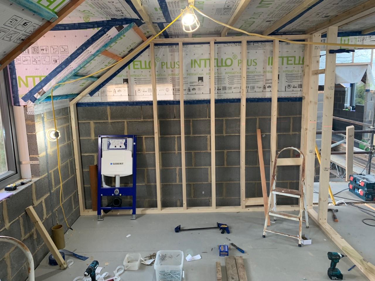

James94 Posted October 30, 2021 Author Share Posted October 30, 2021 Received the two UP320 frames and this is where were up to at the moment. Thinking of having the soil vent pipe just to the left of toilet with an aav, not sure if we will have enough room to tap into waste pipe above floor or might have to go straight down and tap in below floor level. How do you work out what height to put frame to if you don't have the toilet? Regards James Link to comment Share on other sites More sharing options...

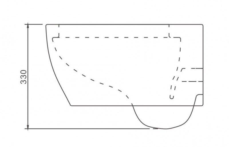

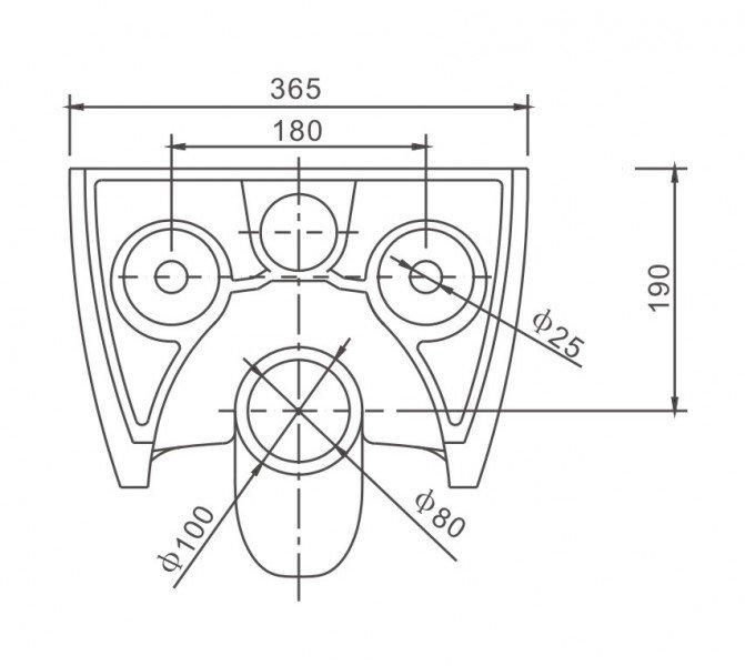

Onoff Posted October 30, 2021 Share Posted October 30, 2021 You need to get the section drawing drawing for the pan! Something like this: Even then mine didn't quite match up. I only set the frame height once I had the pan. 1 Link to comment Share on other sites More sharing options...
vala Posted October 30, 2021 Share Posted October 30, 2021 36 minutes ago, James94 said: Received the two UP320 frames and this is where were up to at the moment. Thinking of having the soil vent pipe just to the left of toilet with an aav, not sure if we will have enough room to tap into waste pipe above floor or might have to go straight down and tap in below floor level. How do you work out what height to put frame to if you don't have the toilet? Regards James the sectional drawing for my toilet shows the height from finished floor so I used that as a guide. Cut a bit of ply to use as a template, adjusted slightly and then screwed it all up. Link to comment Share on other sites More sharing options...
Onoff Posted October 30, 2021 Share Posted October 30, 2021 20 minutes ago, vala said: the sectional drawing for my toilet shows the height from finished floor so I used that as a guide. Cut a bit of ply to use as a template, adjusted slightly and then screwed it all up. You need to know the dimns between centres of flush and poo pipes to make sure they match the Geberit frame. You then need the dimn from top of porcelain to say poo pipe to set your frame. Link to comment Share on other sites More sharing options...
Onoff Posted October 30, 2021 Share Posted October 30, 2021 Remember to account for the thickness of floor tiles and adhesive! Link to comment Share on other sites More sharing options...
James94 Posted October 30, 2021 Author Share Posted October 30, 2021 (edited) Never anything simple, do i have to buy the pan now or are they all similar dimensions. don't want to be sat on it with my head between legs, we are both over 6". Regards James Edited October 30, 2021 by James94 poor spelling Link to comment Share on other sites More sharing options...
