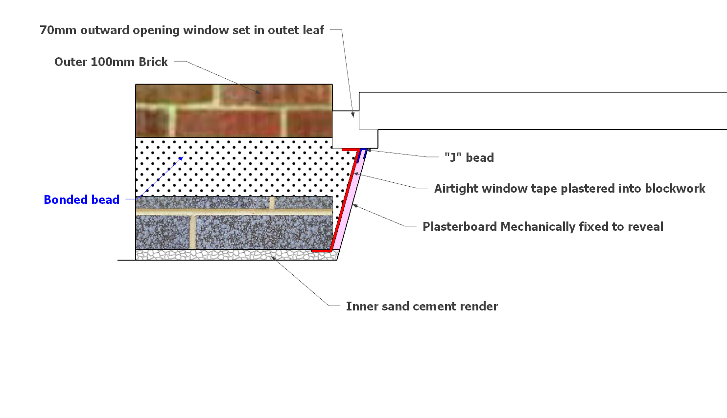

WWilts Posted October 16, 2021 Share Posted October 16, 2021 (edited) Trying to find detail drawing of a window reveal. To get it as airtight and thermally sound as possible (on a budget). Not encouraged by parts of the brickwork around the opening. Builder says that's the inside, there will be an insulated closer and nobody will see the broken bits. Trying to understand how a reveal works for deep set windows, so that I can talk sense in our conversations. On what does a deep set window sit? Skins from out to in: 100mm brick 110mm cavity (bonded EPS beads insulation) 100mm aircrete PS for context: the external face of the brickwork looks good generally. Concave tooled joints. This bit was done by the labourer practising his skills. Edited October 16, 2021 by WWilts added pic with question Link to comment Share on other sites More sharing options...

WWilts Posted October 17, 2021 Author Share Posted October 17, 2021 (edited) 38 minutes ago, James94 said: cavity closer sealing Trying to understand how cavities are closed. So that I can talk sense in conversations with builder. The "plan view" pic I drew to show what the builder described. Not sure if that is realistic, will look ok (concealing the brick reveal), or even if that is really what he described. Will the bonded EPS beads suffice to close the cavity? Edited October 17, 2021 by WWilts added question Link to comment Share on other sites More sharing options...
Iceverge Posted October 17, 2021 Share Posted October 17, 2021 Have you read the blog post I put up? It's quite good. Here is a sketch of the detail. Cheap, easy to build, airtight, thermally sound. 1 Link to comment Share on other sites More sharing options...

WWilts Posted October 17, 2021 Author Share Posted October 17, 2021 48 minutes ago, Iceverge said: Have you read the blog post I put up? It's quite good. Here is a sketch of the detail. Cheap, easy to build, airtight, thermally sound. Great, tks. Did read the blog post but a lot went above my head. The pics assumed knowledge that I don't have. Your drawing makes things clear for me. Before I saw it I was sketching my own understanding. The builder will have a go at whatever drawing I give him, within reason. Don't know if my drawing makes sense or is buildable. Link to comment Share on other sites More sharing options...
Iceverge Posted October 17, 2021 Share Posted October 17, 2021 That marine ply won't hold up a large window. The Denby Dale one was able to because they made a box. The sides supported the bottom. I think you're overthinking this. With a 110mm cavity you're short of bregs not to mind PH. With low insulation levels thermal bridging isn't as much of an issue. I would pursue whatever kind of window installation the builder knows and is comfortable with and will definitely keep out water. The only low hanging fruit on your build is airtightness. Concentrate on this and your house will be warm. 1 Link to comment Share on other sites More sharing options...
WWilts Posted October 17, 2021 Author Share Posted October 17, 2021 (edited) 43 minutes ago, Iceverge said: I would pursue whatever kind of window installation the builder knows and is comfortable with and will definitely keep out water. Makes sense. Can push on things that will really make a difference. Besides, seems wise to have people doing their best rather than sulking because they were pushed on iffy things. Incidentally, can get to wall U value under 0.23 with the 110mm cavity blown EPS beads, aircrete blocks (even 7N), plasterboard on dabs & brick outer. There is however one 2.6m wide window that is important for heat loss. That's where the broken brick was (original pic). Will see if there are obvious opportunities for improvement in the builder's methods, perhaps a little more attention to airtight taping etc. esp around that window. The broken brick was already flagged as a concern. I'd already sketched the attached modification of my original drawing. Both are now an academic exercise. But all this has certainly helped me understand what a window reveal actually is and how it can work if done well. Might gain a little airtightness and a tad less thermal bridging as a result. Edited October 17, 2021 by WWilts Link to comment Share on other sites More sharing options...
