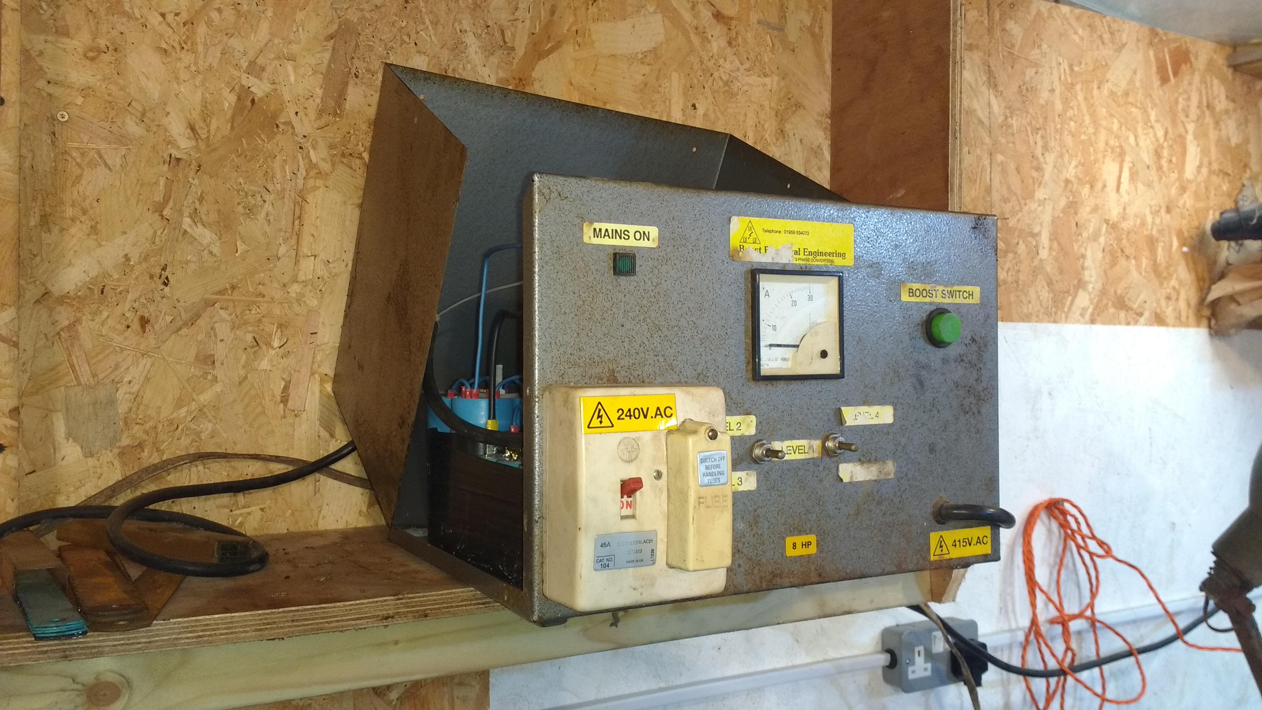

Onoff Posted October 16, 2021 Author Share Posted October 16, 2021 19 minutes ago, dpmiller said: Delving into the converter is your next stop. What variety is it, transistorised or rotary? Transistorised with lots of caps in there I think. Link to comment Share on other sites More sharing options...
dpmiller Posted October 16, 2021 Share Posted October 16, 2021 Ewww. Careful. Nasty things. 1 Link to comment Share on other sites More sharing options...

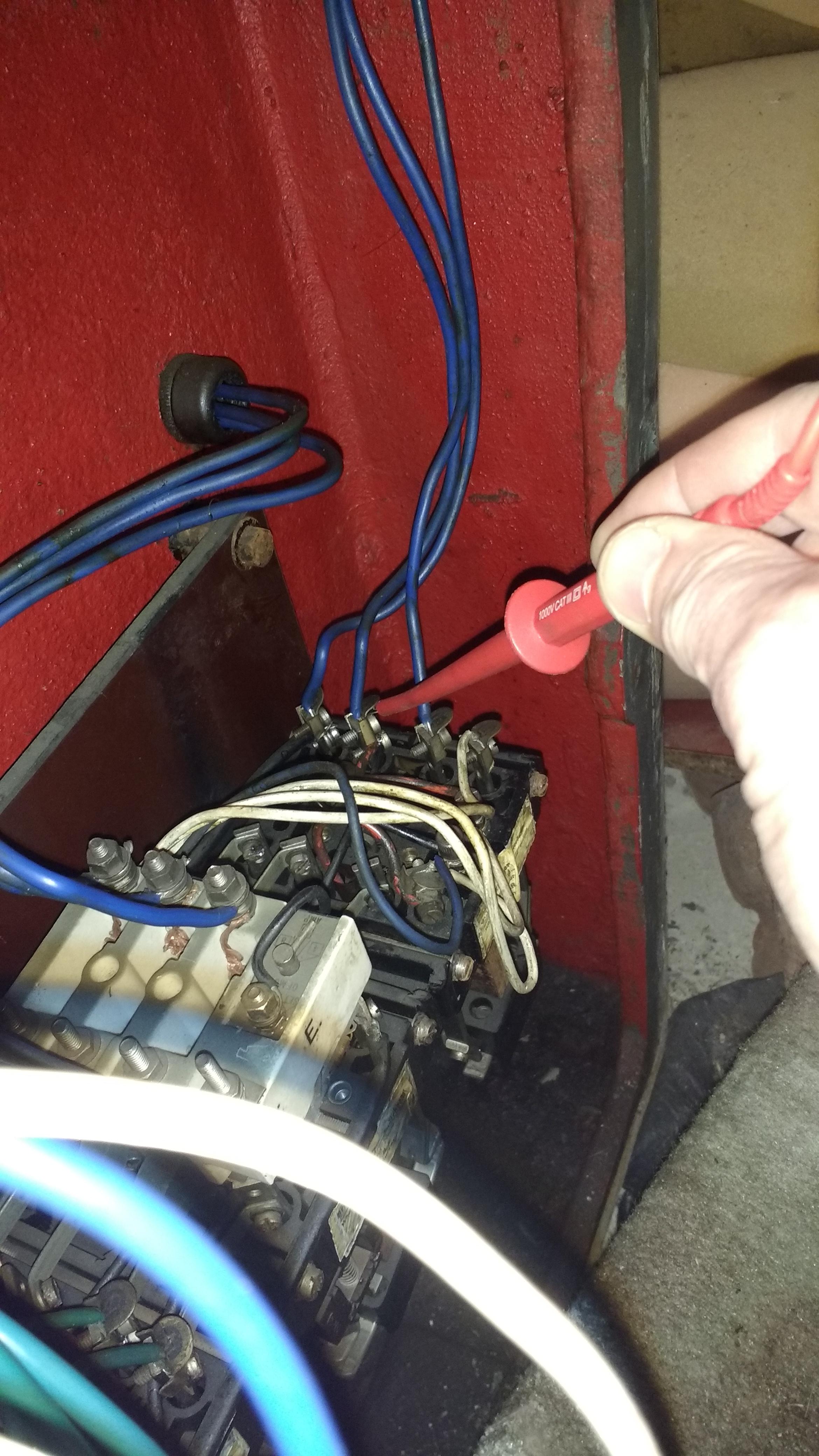

Onoff Posted October 16, 2021 Author Share Posted October 16, 2021 (edited) I ran the pillar drill that starts fine. Readings: OFF. FWD REV R1- S2 430 430 390 S2 - T3 430 430 430 R1 - T3 0 450 460 R1- E 0 450 460 S2 - E 430 430 435 T3 - E 0 0 0 Edited October 16, 2021 by Onoff Link to comment Share on other sites More sharing options...

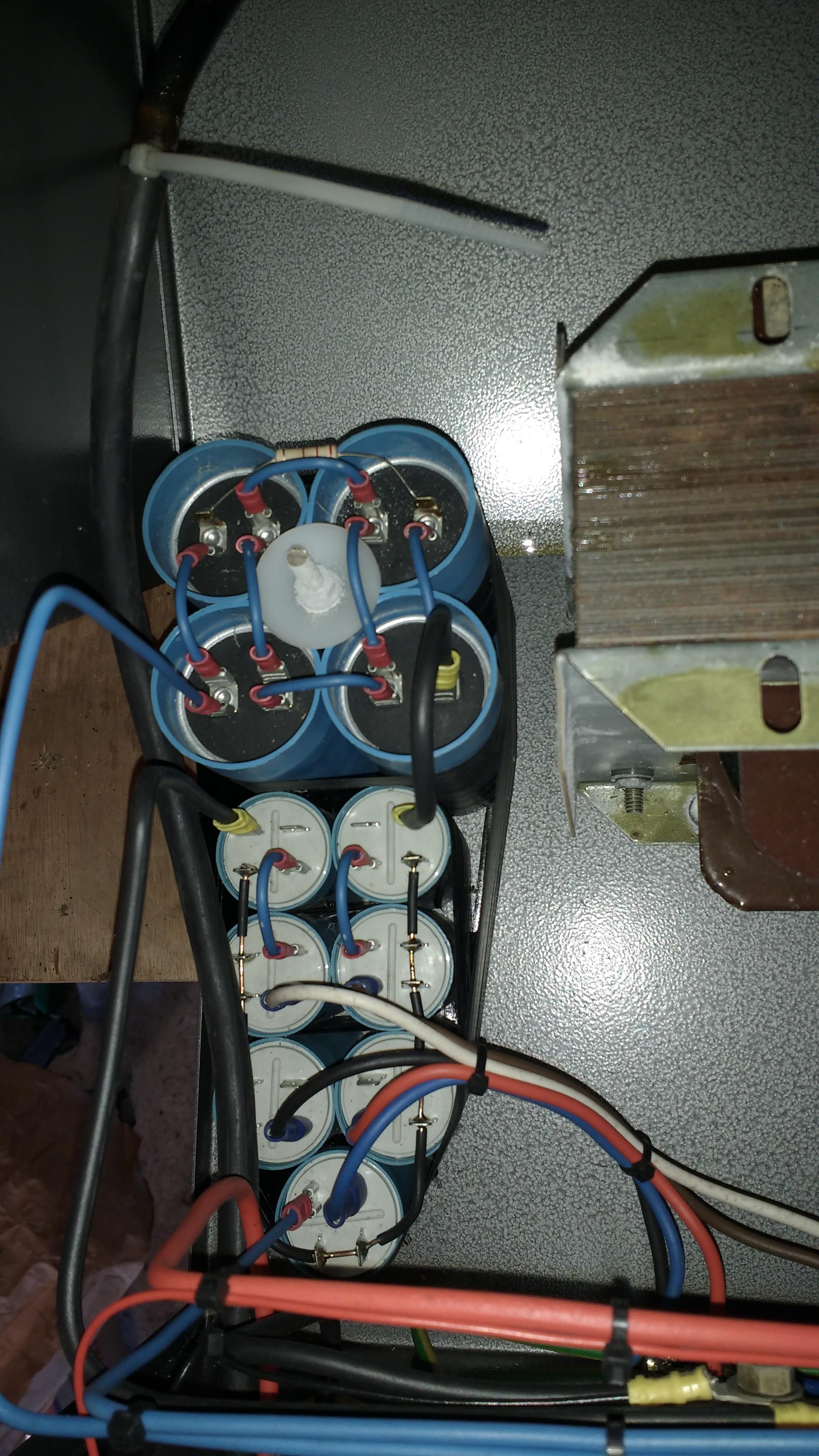

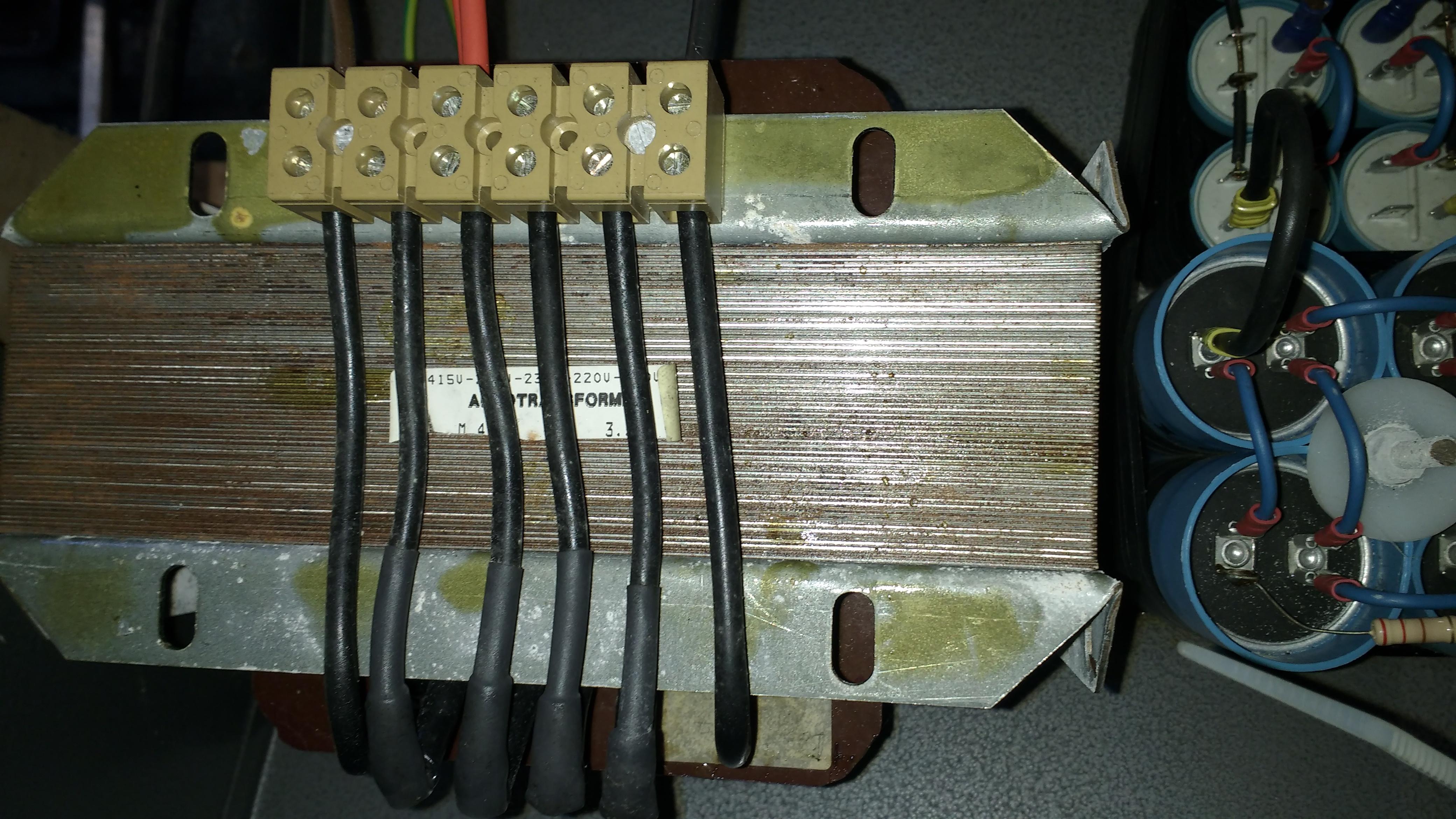

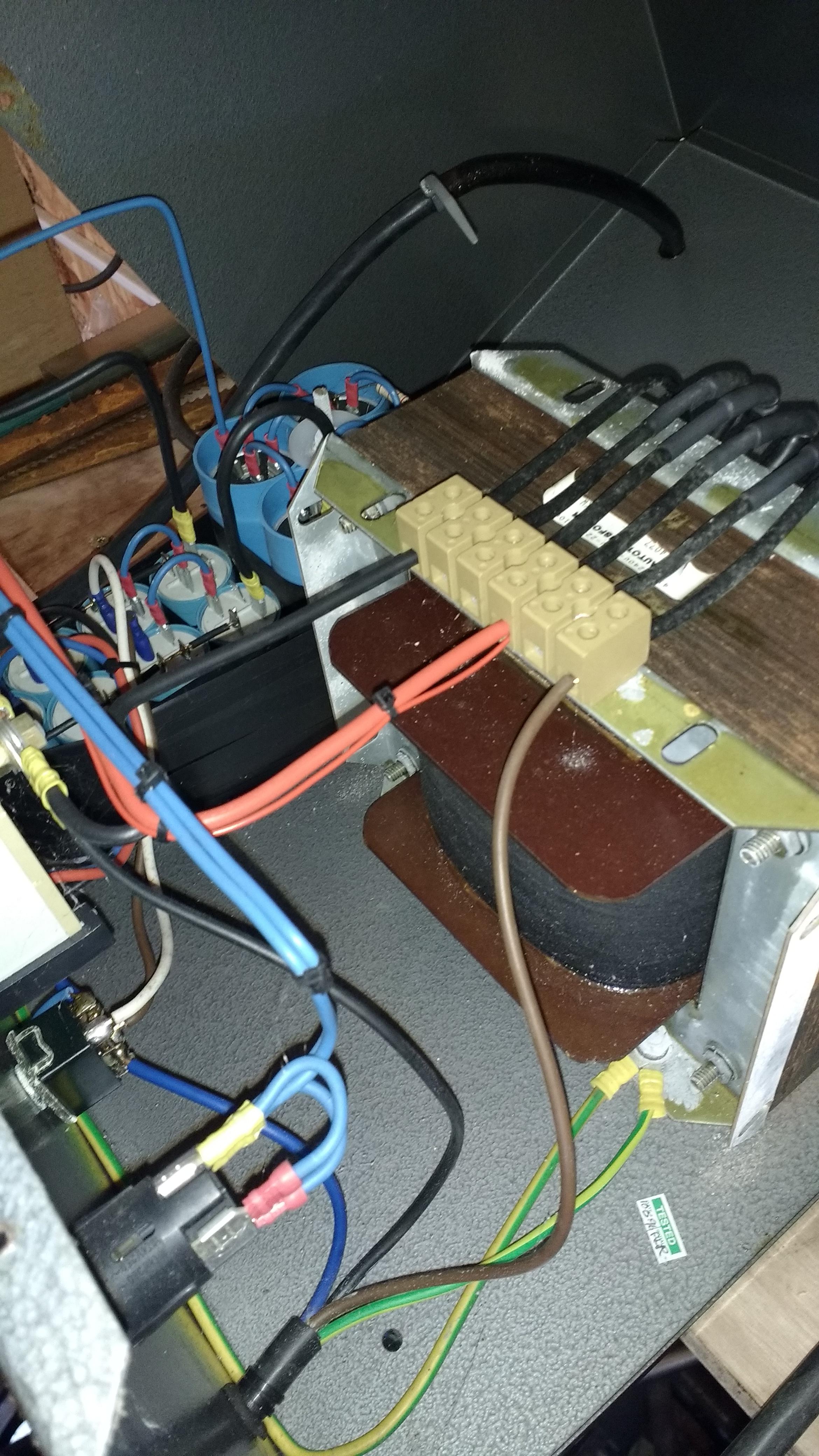

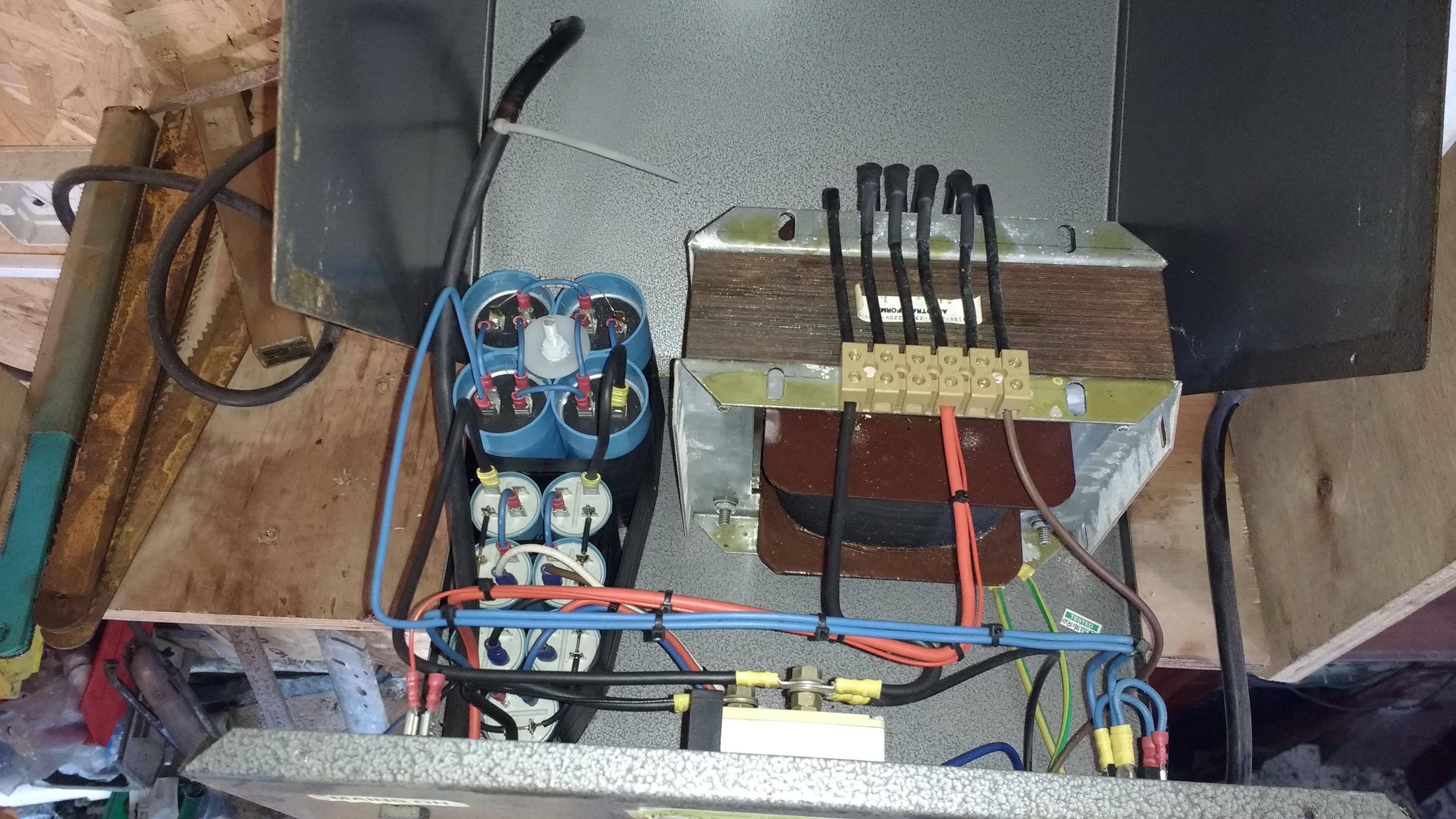

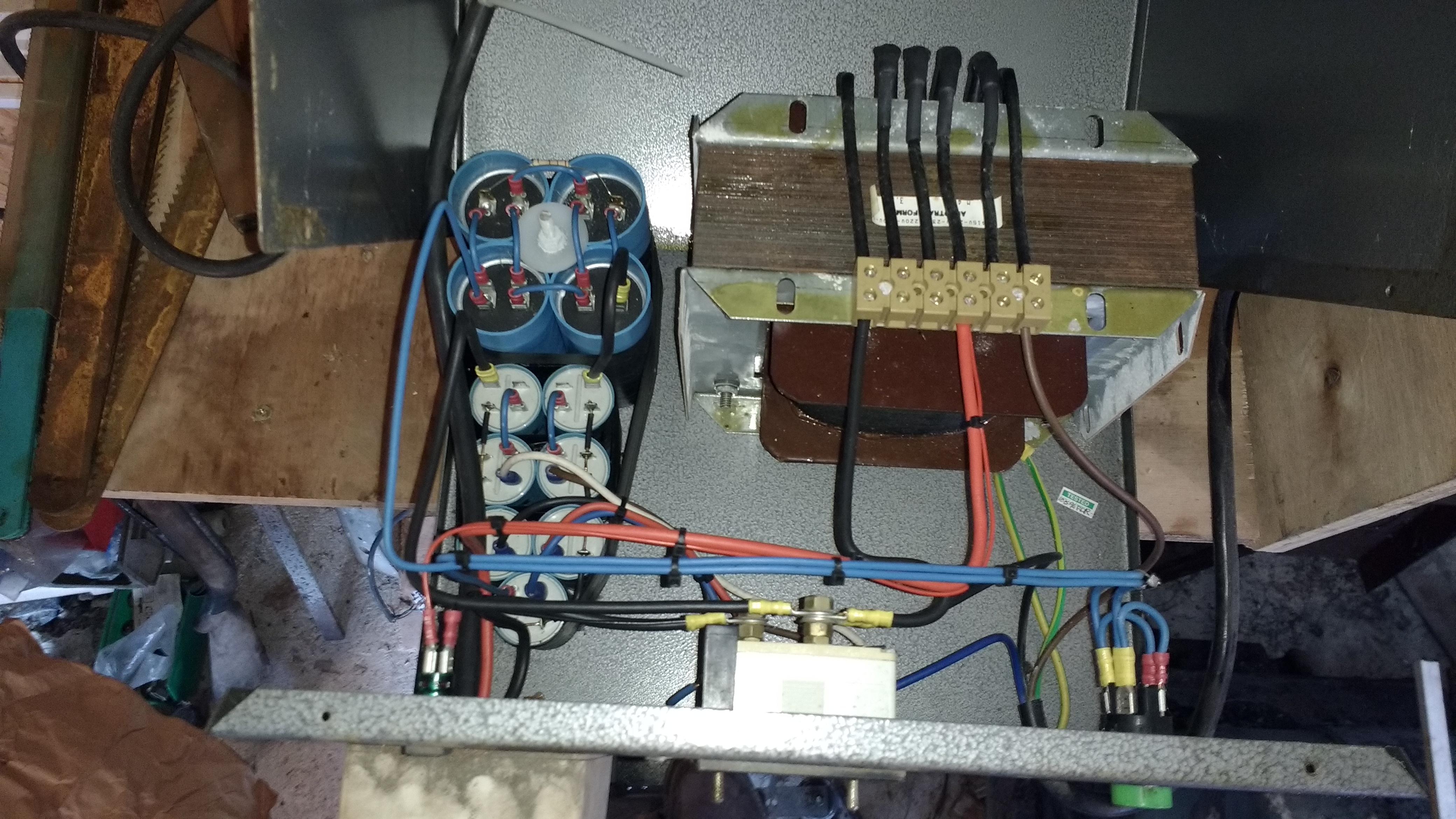

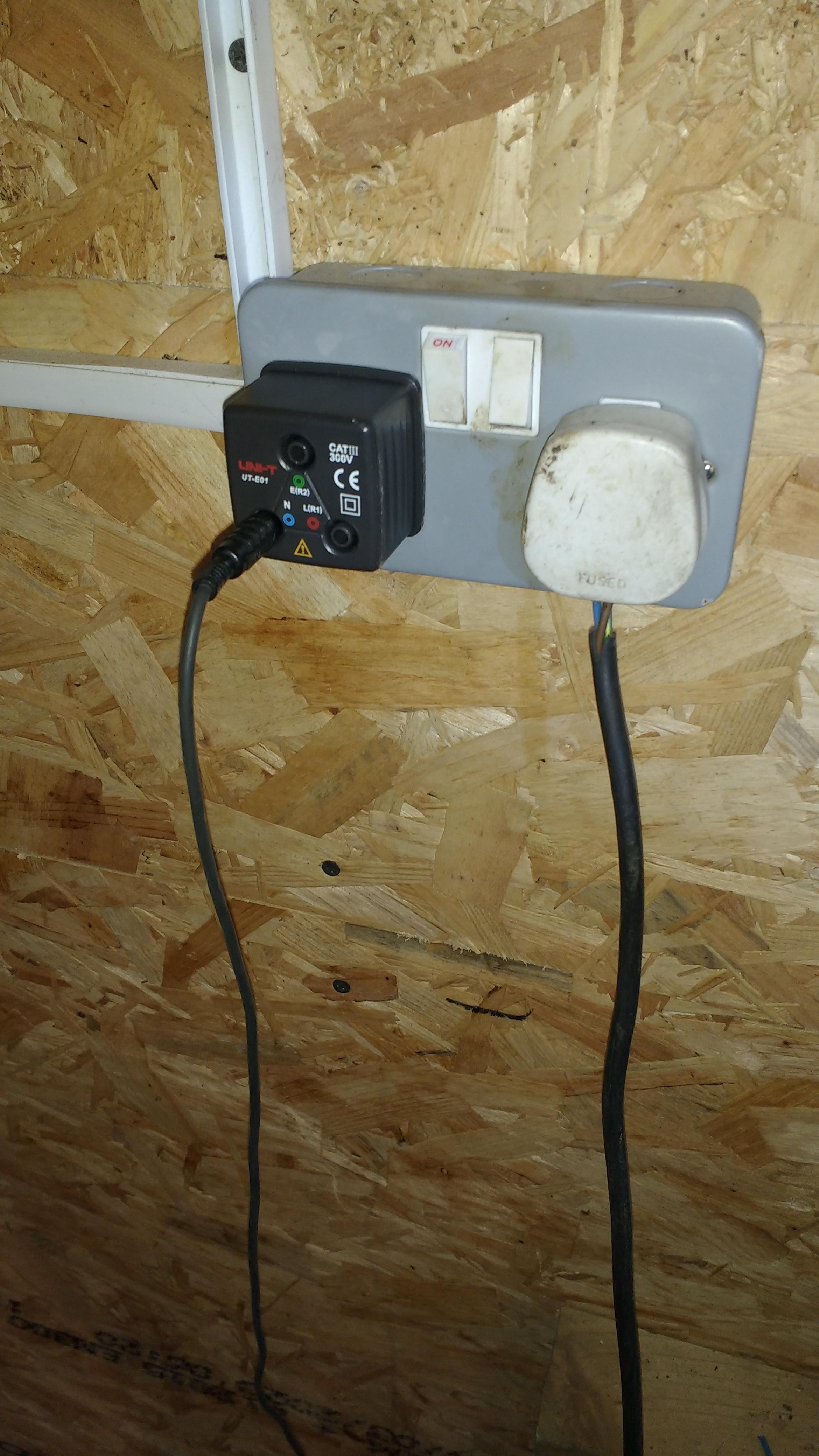

Onoff Posted October 17, 2021 Author Share Posted October 17, 2021 A few random pics inside the phase converter. Bfo trannie in there and lots of caps. Incoming L&N appear to go to the transformer and take 230V up to ""415" out on the brown. Across the red and black to the transformer 230V. Out on the brown 430V. Measuring from a wall socket between N or E to the phase converter outputs. One phase to E or N. Circa 400V. Other two phases to E or N at the socket, zero volts. Link to comment Share on other sites More sharing options...
TonyT Posted October 17, 2021 Share Posted October 17, 2021 The inside looks well built. I would safely discharge the capacitors and measure the rating, or just replace as just like humans they get old and tired! Link to comment Share on other sites More sharing options...
Onoff Posted October 17, 2021 Author Share Posted October 17, 2021 7 minutes ago, TonyT said: The inside looks well built. I would safely discharge the capacitors and measure the rating, or just replace as just like humans they get old and tired! Do you think a duff cap(s) could be why I'm getting this unexpected 430V to earth? Debating dropping any control voltage to either 42 or 48V. I've 400v trannies to do both. Link to comment Share on other sites More sharing options...
TonyT Posted October 17, 2021 Share Posted October 17, 2021 What’s the S2 terminal? Link to comment Share on other sites More sharing options...
TonyT Posted October 17, 2021 Share Posted October 17, 2021 Sounds like the set of capacitors for phase 3 is shot Link to comment Share on other sites More sharing options...

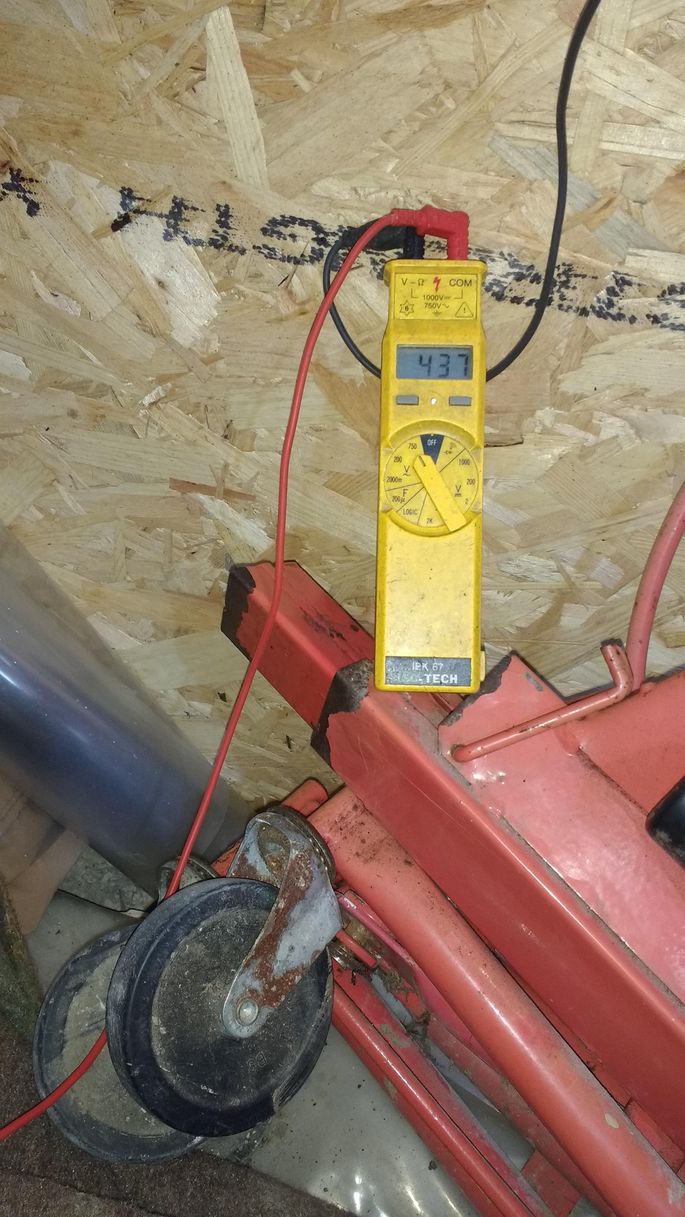

Onoff Posted October 19, 2021 Author Share Posted October 19, 2021 I've just emailed the author of this to see if he has any idea on these weird readings I'm getting on the phase converter. That 430V to earth on one phase is "correct" in that's how the phase converter is built. I measure it between the 415V output in the big transformer and earth. Brown and earth on the right go to the output. So it's "correct" I just don't understand! Well, I understand how the trannie steps it up from 230 to 415 but not how it doesn't upset the machines. Link to comment Share on other sites More sharing options...
SteamyTea Posted October 19, 2021 Share Posted October 19, 2021 27 minutes ago, Onoff said: I just don't understand Don't it work because it takes time to charge up the capacitor, this is what shifts the phase. I take it that the capacitor/s are after the transformer/s. Can you work out the RMS voltage? 1 Link to comment Share on other sites More sharing options...
