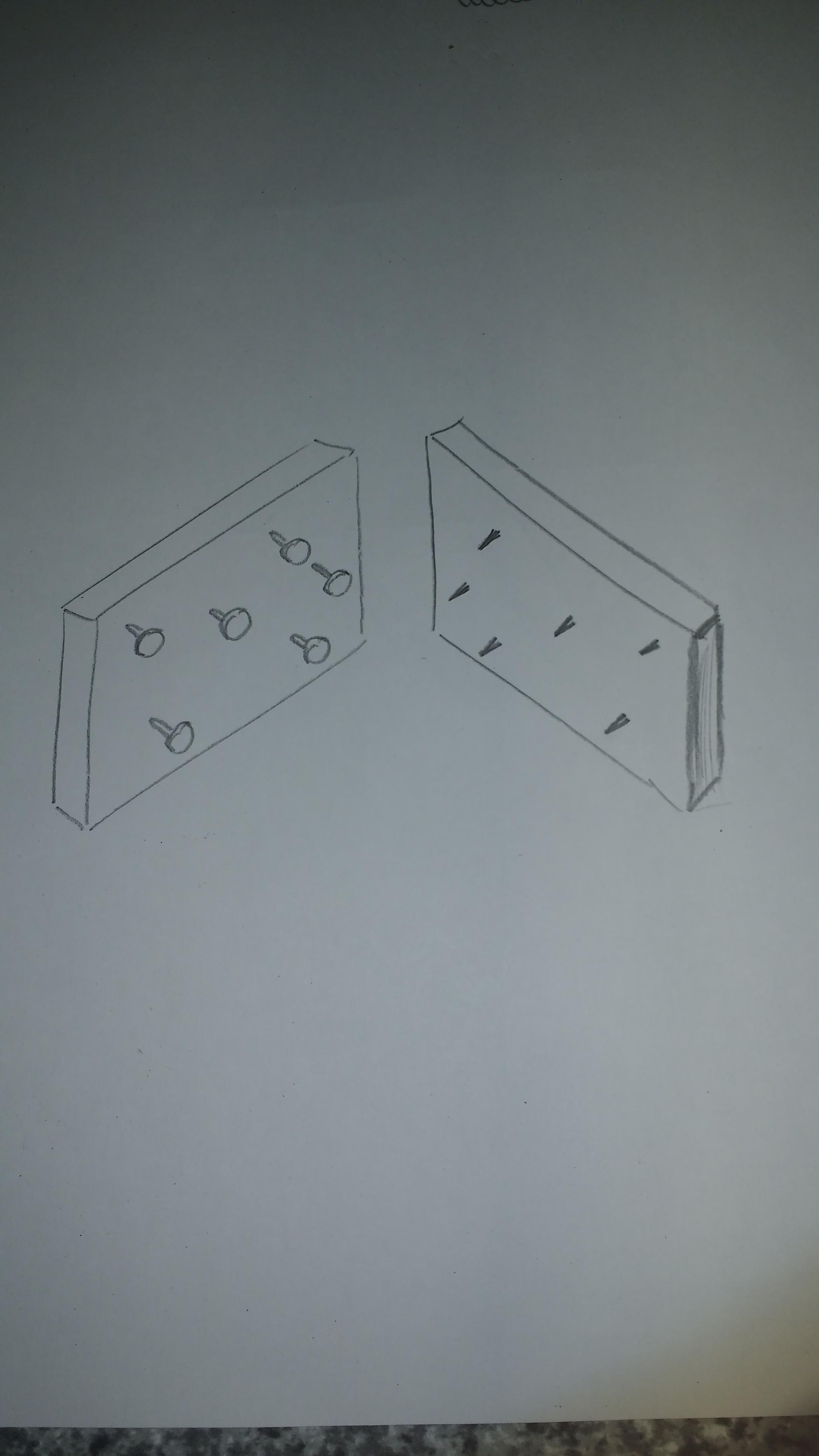

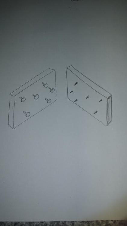

Onoff Posted October 26, 2021 Share Posted October 26, 2021 You can make yourself a "scratching tool" by taking a scrap piece of say 3/4" ply and cutting to say 6"X 3". Put a few screws or nails in from one side that just poke out the other side. Think "bed of nails". When firm enough but not gone off, you sort of go over your render gently and the screw tips leave scratch lines to help key the next coat. Link to comment Share on other sites More sharing options...
zoothorn Posted October 27, 2021 Author Share Posted October 27, 2021 (edited) @Onoff great idea as per usual thx. But just seen this reply. In fact yesterday I just grabbed a big handful of cocktail sticks! Did a job. So onto my render today to finish (me, a job in 4pgs?!). I wish they sold 5 kg of hydrated lime.. urgh I cant use 80% of a 25 kg bag assuming it wont keep in a v. moist climate. So just sand: cement alas, anyway no need for the perfect job for here. Edited October 27, 2021 by zoothorn Link to comment Share on other sites More sharing options...
