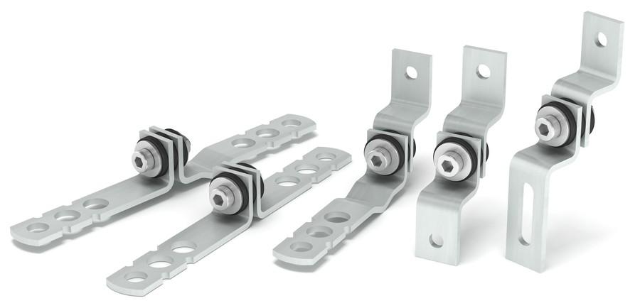

But - I imagine these two parallel walls need to be connected to each other else they might fall over? So how would you *normally* attach these two walls to each other, and in the case of soundproofing, would you use e.g. some type of rubberized clips?

Normally you use wall "ties ties" of which there are many types. Some look like a bow tie made of wire. The kinks or twists in the middle forms a drip bead to stop any water tracking across the tie.
2016832359_K611TraditionalDoubleTriangleWallTie.jpg.87bbd9d086fbeedc2997e477794912a7.jpg
There are noise reducing wall ties but I've no idea how effective they are at reducing noise transmission. They also look expensive..
https://www.ancon.co.uk/products/wall-ties-restraint-fixings/acoustic-wall-ties

Thanks @Temp - I think that info is exactly what I need. Indeed, they look a lot more expensive but I suppose in my case it's only for one room so I'm sure it won't add up to a huge sum.

Very little noise transmitted through a wall tie, if you want to improve then use a longer tie and place at an angle, not as strong but does allow each wall skin to flex without directly pushing the other skin. No idea how much low level noise will transmit in a domestic wall but in Stadia etc. The sound pressure has a big impact on the structure

With masonry party walls we would use use the thin type A wall ties, medium density block plastered and 75mm cavity - either with or without insulation.
