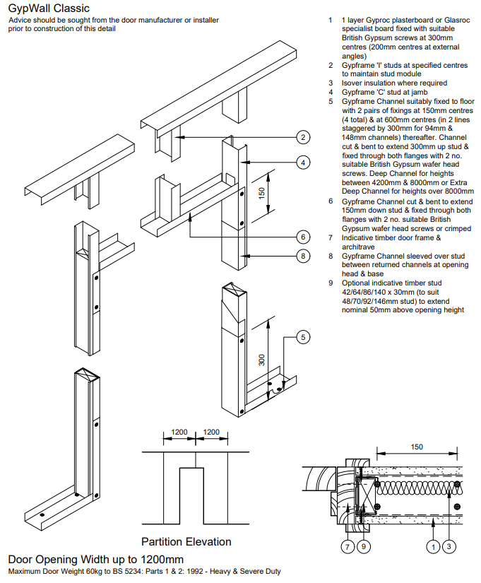

MortarThePoint Posted October 10, 2021 Share Posted October 10, 2021 I'm establishing various door openings in metal frame and wondered if anyone recommended any particular door liner kit as being good. They don't appear to fully standardise on the thickness of the timber and that affects the size of the reveals to be left in the metal frame stud walls. There do however appear to be lots that are 32mm nominal which equates to a finished 27mm. There appear to be thicker ones for fire rating purposes. A 70mm stud with plasterboard either side works out as 100mm, so it's the 115mm nominal / 106mm actual lining I'll want I expect. Is the extra 11mm (12.5mm plasterboard) or 6mm (15mm plasterboard) is to allow for plaster skim? You have to reinforce the C-studs next to a door with timber and there are two ways of doing this. Either tuck a piece of timber into the C-stud or move the stud away from the reveal to have it on the reveal side. Which is best for a solid job? How much wiggle room do people leave with MF studs? One general guide copied below suggests 10mm both sides but that seems excessive for MF. I was planning to go with 5mm each side so a reveal width of 830mm. 10mm (wriggle room) + 28mm (lining) + 762mm (door)+ 28mm (lining)+ 10mm (wriggle room) = 838mm (call it 840mm) [3] https://www.selcobw.com/products/doors-windows-stairs/doors/door-frames/door-lining-sawn-metal-stud-32-x-115mm-nom-pefc https://www.wonkeedonkeexljoinery.co.uk/fitting-a-new-door/how-to-fit-an-internal-door-frame/ [3] https://www.juliancassell.com/2528/interior-door-frames Link to comment Share on other sites More sharing options...
MortarThePoint Posted October 10, 2021 Author Share Posted October 10, 2021 (edited) If so inclined, could add floor channel sleeving the C-stud at the reveal as well as bending the bottom floor channel 300mm up: Edited October 10, 2021 by MortarThePoint Link to comment Share on other sites More sharing options...
willbish Posted October 10, 2021 Share Posted October 10, 2021 1 hour ago, MortarThePoint said: You have to reinforce the C-studs next to a door with timber and there are two ways of doing this. Either tuck a piece of timber into the C-stud or move the stud away from the reveal to have it on the reveal side. Which is best for a solid job? Timber inside is, I think, essential as it gives something for the lining screws to bite into. I also doubled the C studs, probably unnecessary, but it adds rigidity. 1 Link to comment Share on other sites More sharing options...
MortarThePoint Posted October 11, 2021 Author Share Posted October 11, 2021 19 hours ago, willbish said: Timber inside is, I think, essential as it gives something for the lining screws to bite into. I also doubled the C studs, probably unnecessary, but it adds rigidity. What gap did you leave between the c-studs of the reveal for what size door? Link to comment Share on other sites More sharing options...

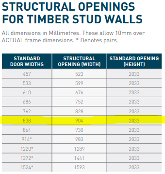

willbish Posted October 17, 2021 Share Posted October 17, 2021 On 11/10/2021 at 09:45, MortarThePoint said: What gap did you leave between the c-studs of the reveal for what size door Pretty sure I followed this document when creating my openings. Will ping the laser around in a bit for you. Opening-Dims.pdf 1 Link to comment Share on other sites More sharing options...

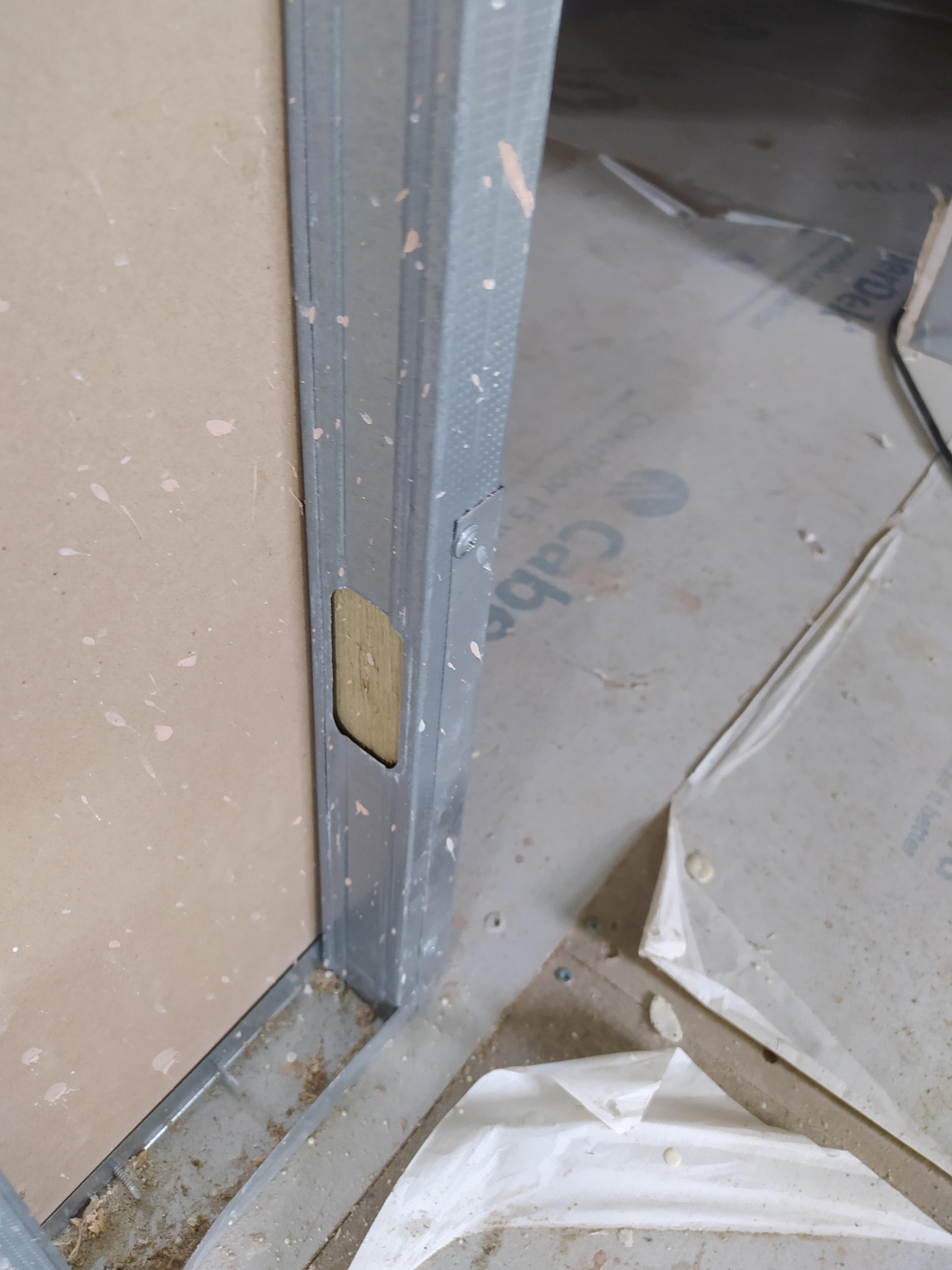

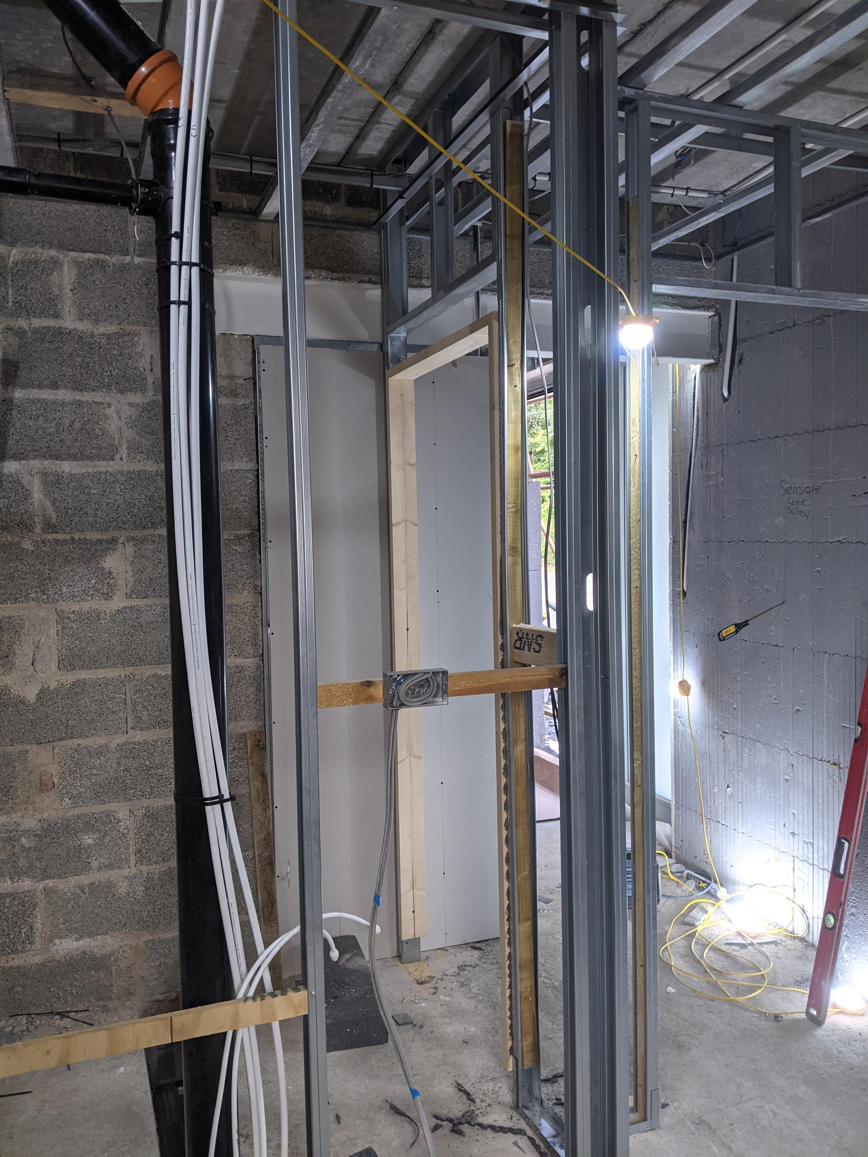

Conor Posted October 17, 2021 Share Posted October 17, 2021 You talking about door frames? They made the C sections ~75mm or so wider than the door openings. They then lined the inside of the studs with 25x50mm battens and noggins either side. My joiners then fitted standard timber door frames before boarding. 1 1 Link to comment Share on other sites More sharing options...
MortarThePoint Posted October 17, 2021 Author Share Posted October 17, 2021 2 hours ago, willbish said: Pretty sure I followed this document when creating my openings. Will ping the laser around in a bit for you. Opening-Dims.pdf 328.35 kB · 1 download Thanks very handy. They appear to be using 10mm extra for timber studs so: 838 + 2*28 + 10 = 904 Given metal frame is much more accurate than timber studs I'm tempted to just build the kit into the metal frame studs as I go, so effectively reducing that 10mm extra to zero. If you could measure with the laser that would be awesome as MF may be tighter reveals than timber studs. Link to comment Share on other sites More sharing options...
MortarThePoint Posted October 17, 2021 Author Share Posted October 17, 2021 2 hours ago, Conor said: You talking about door frames? They made the C sections ~75mm or so wider than the door openings. They then lined the inside of the studs with 25x50mm battens and noggins either side. My joiners then fitted standard timber door frames before boarding. Thanks. Looks like they have glued and screwed the door liner to the metal studs so should have a solid connection. I can't see any signs of packers so perhaps the metal frame reveal is 2 or 3 mm larger than the door liner. A couple of questions: Why don't the vertical bits of the door liner go down to the floor? Why the gap above the top of the door liner? Link to comment Share on other sites More sharing options...

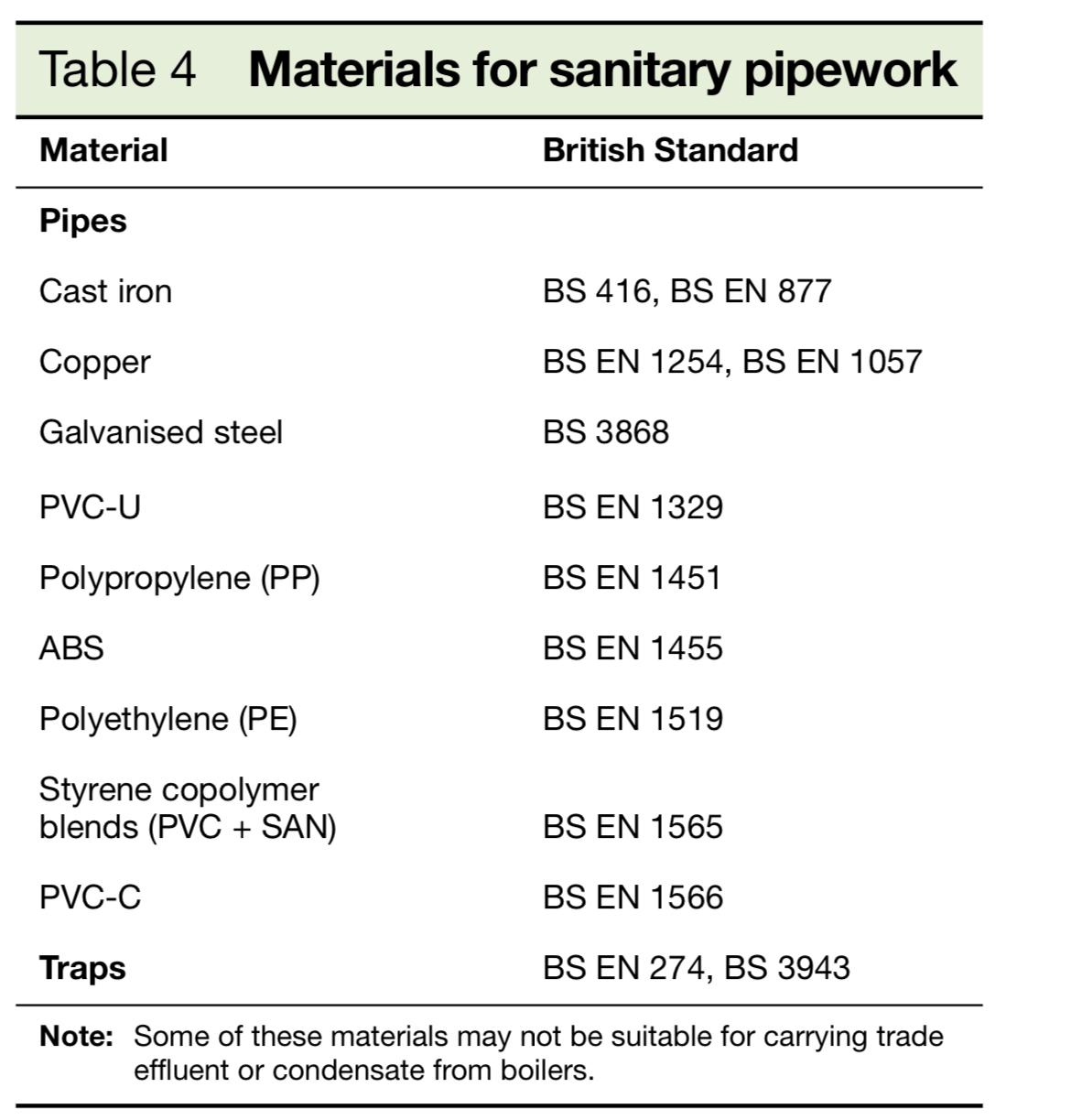

PeterW Posted October 17, 2021 Share Posted October 17, 2021 26 minutes ago, Dave Jones said: Building control should pull you up using underground soil fittings inside. Why..? As long as they are boxed in and not exposed to direct sunlight then they are fine. They should not be used externally. Link to comment Share on other sites More sharing options...
Dave Jones Posted October 18, 2021 Share Posted October 18, 2021 14 hours ago, PeterW said: Why..? As long as they are boxed in and not exposed to direct sunlight then they are fine. They should not be used externally. because below ground drainage hasn't been manufactured to BS EN 1329 which is required by building regs. Same reason you cant use above ground drainage below ground. Like you say would probably be ok but best to do it properly as the cost isn't that much. https://www.polypipe.com/housing/above-ground-drainage-faqs Link to comment Share on other sites More sharing options...
PeterW Posted October 18, 2021 Share Posted October 18, 2021 1 hour ago, Dave Jones said: because below ground drainage hasn't been manufactured to BS EN 1329 which is required by building regs. Same reason you cant use above ground drainage below ground. Like you say would probably be ok but best to do it properly as the cost isn't that much. https://www.polypipe.com/housing/above-ground-drainage-faqs Ok so you’ve quoted a supplier and not the actual regulations, and a single supplier at that too. There are varying regulations on pipework that are allowable, and it covers the 4 main “plastic” pipes in various Standards Depending on the supplier, the underground products may be UPVC or PP - Polypipe only manufacture in UPVC for example for any drainage product where others use a mix of PP, PE and UPVC depending on the product range. It’s also worth noting that a significant amount of the standard relates to dimensions of fittings, wall thicknesses and other physical standards. The actual material used is around 4 paragraphs in the standard and relates to minimum amount of virgin polymer to re-grind and other additives. Link to comment Share on other sites More sharing options...

Conor Posted October 18, 2021 Share Posted October 18, 2021 23 hours ago, MortarThePoint said: Thanks. Looks like they have glued and screwed the door liner to the metal studs so should have a solid connection. I can't see any signs of packers so perhaps the metal frame reveal is 2 or 3 mm larger than the door liner. A couple of questions: Why don't the vertical bits of the door liner go down to the floor? Why the gap above the top of the door liner? 1. No idea. I'm assuming as there's no point going below the FFL. 2. No idea, but I think the guy doing the metal work got the FFL wrong at the start. Think others are ok. The only Packers the joiner used were little strips of DPC 1 Link to comment Share on other sites More sharing options...
MortarThePoint Posted October 18, 2021 Author Share Posted October 18, 2021 38 minutes ago, Conor said: 1. No idea. I'm assuming as there's no point going below the FFL. 2. No idea, but I think the guy doing the metal work got the FFL wrong at the start. Think others are ok. The only Packers the joiner used were little strips of DPC So you've still got a screed or something left to lay after this photo was taken? Link to comment Share on other sites More sharing options...
Conor Posted October 18, 2021 Share Posted October 18, 2021 1 hour ago, MortarThePoint said: So you've still got a screed or something left to lay after this photo was taken? Yes. 50mm PIR, UFH, 50mm liquid screed, 20mm engineered wooden floor. In the basement we built the studs off a course of quinnlight aerated blocks to mitigate the cold bridge. Link to comment Share on other sites More sharing options...
