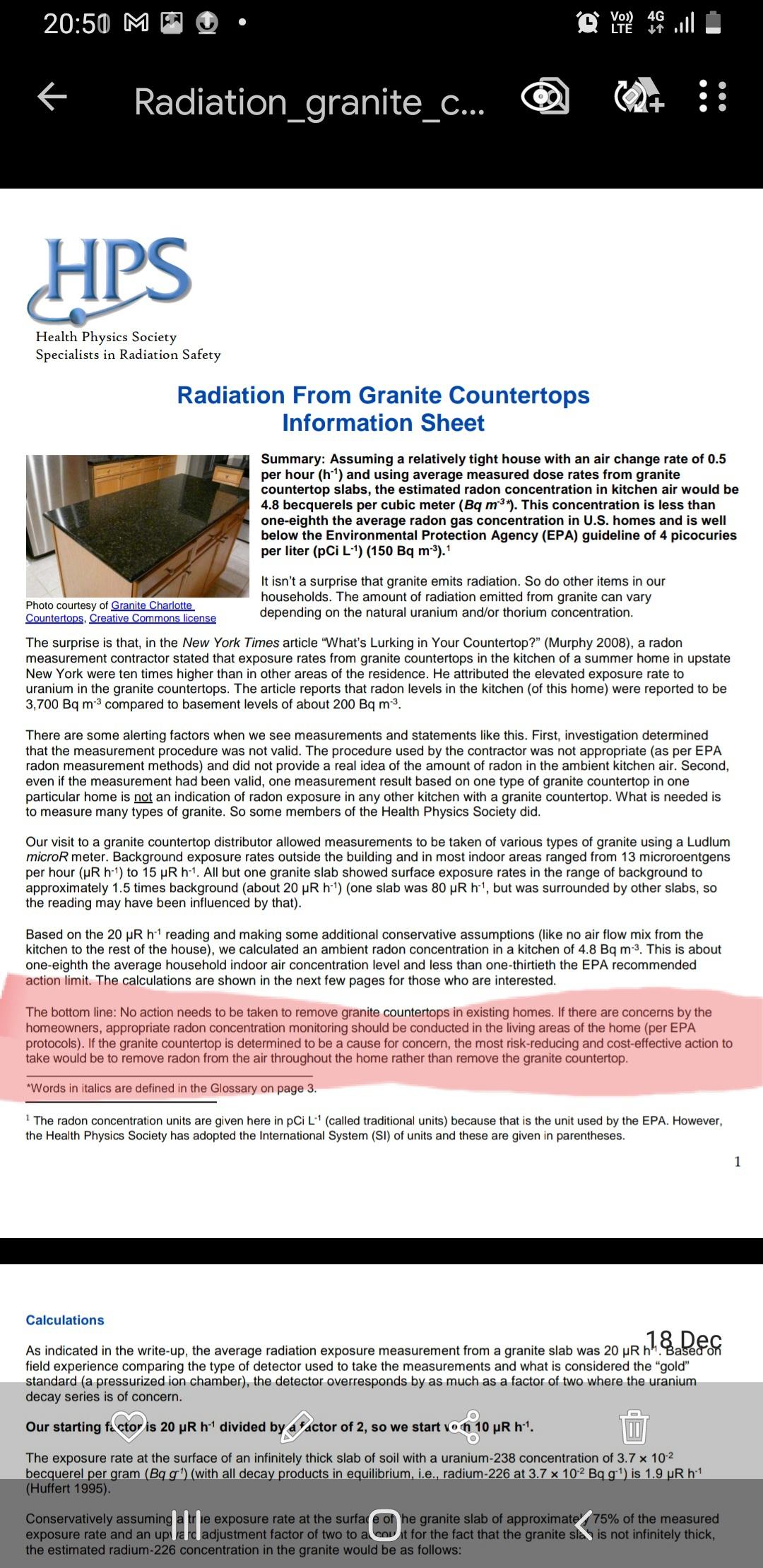

Problem with granite is it sets off a Geiger counter.

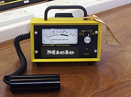

Must be using one of these!
