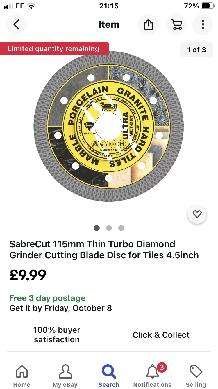

nod Posted October 5, 2021 Posted October 5, 2021 I buy these by the box full They will cut through anything like butter Working out about a fiver each Great value also

Adsibob Posted October 5, 2021 Posted October 5, 2021 2 hours ago, nod said: I buy these by the box full They will cut through anything like butter Working out about a fiver each Great value also Would these be good for terrazo as well?
