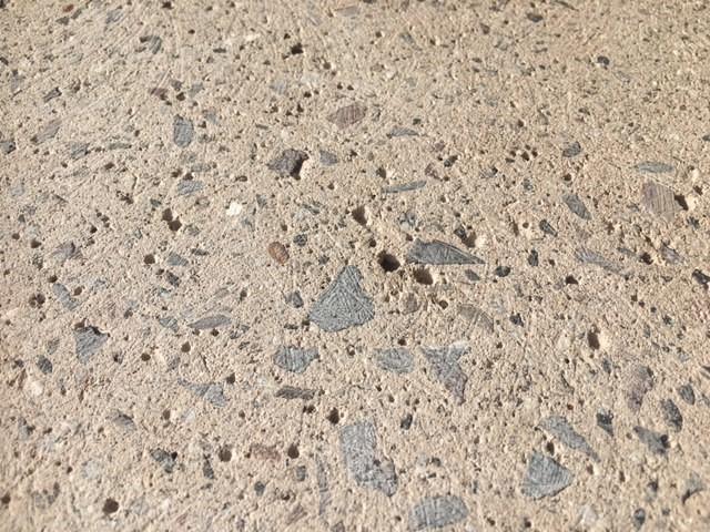

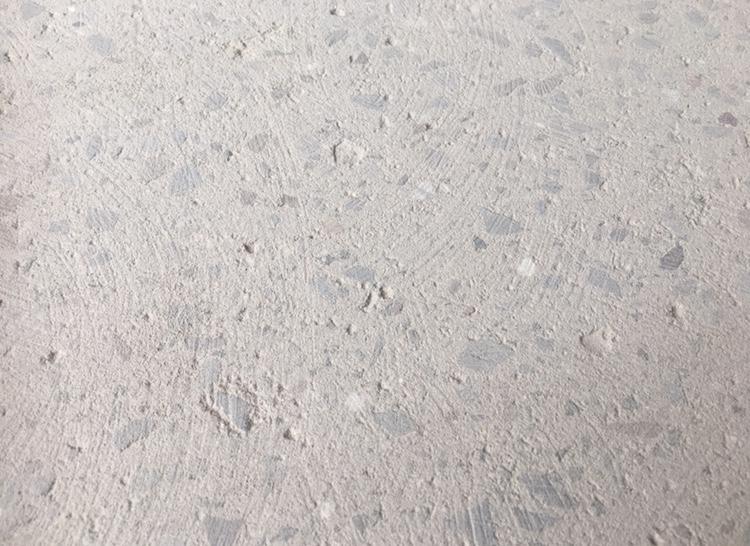

Hi. There's a mix really but nothing massive. I have only ground a small area at the moment where I have uncovered some small holes and a couple of larger ones. No idea what I'll find when I do the whole area (40sqm).

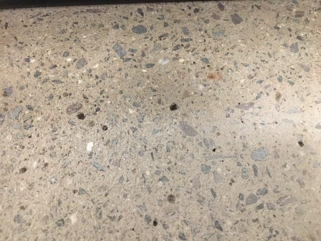

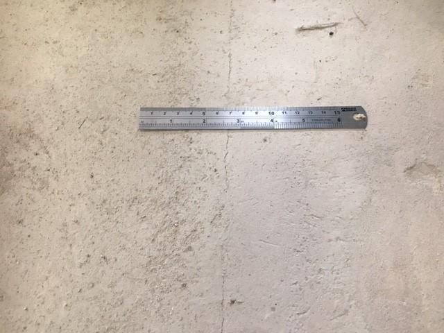

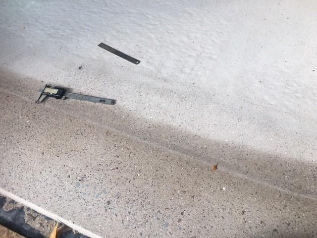

Photos speak a thousand words as they say. Here's the slab where I have ground it and the area behind that's yet to have the laitance etc removed.

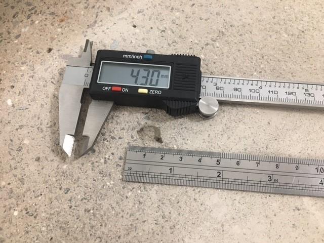

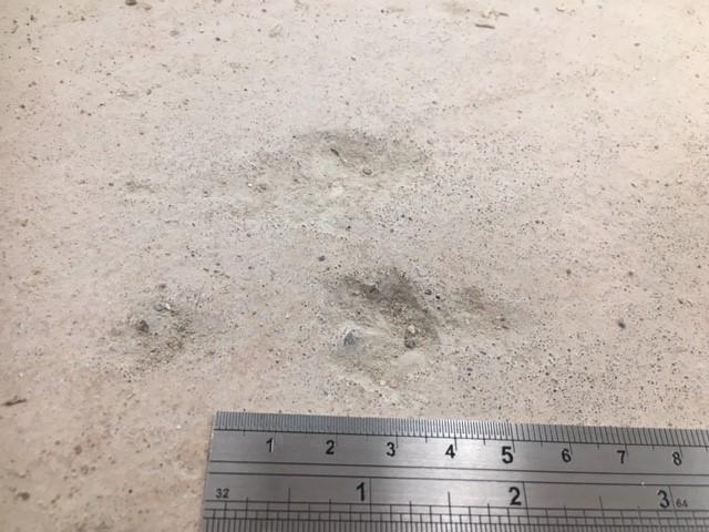

These are the small pin holes.

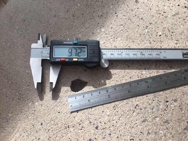

These are the two largest holes. Vernier shows the depth for reference.
In an old 30+ year old concrete slab which I have butted up to, there are some deeper or wider dents from cat paws etc which need filling.
Where the two slabs meet there is a join, naturally.
No doubt the paint will crack also so I am contemplating running a grinder down this line between old and new and filling that whilst I am at it.

I think that the pinholes will fill with your paint, especially if more than one coat, but will you notice?
The crack at the joint is commendably small. Very difficult to patch this, but it is a tiny shrinkage crack and shouldn't move again. You could scratch a V out of it and fill. Or put a skim over it like in plasterboard skimming.
I think a preliminary, extra coat of your floor paint along the joint may be the best cover.

I have bought a small tub of 2 part body filler which states is suitable for concrete, so I will try it out and see how hard it is. You can drill it, and I'm sure with the coating on top it will be fine for a domestic setting.
I am looking at doing a primer coat and two top coats of epoxy so I have time for a plan B if the primer doesn't play ball with the holes I guess.

4 minutes ago, dangti6 said:
the same bubbling appearance was my fear due to air
As long as you fill the holes with filler or paint, there wont be any air.

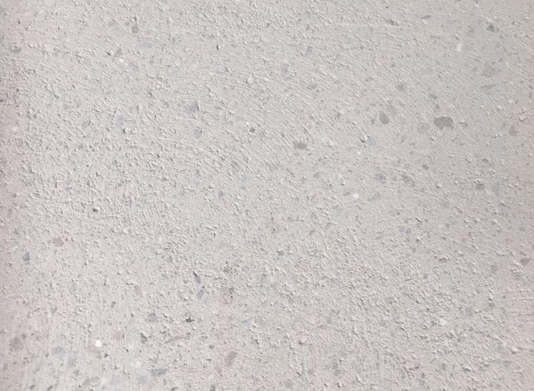

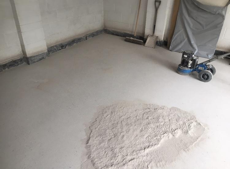

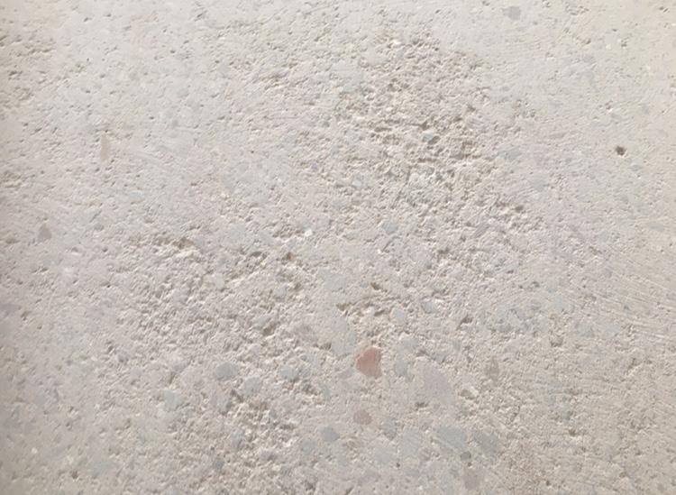

Posted
I have now done a couple of passes with a diamond grinder and pinholes may be the least of my worries. Although the top layer of laitance came off easily I have found that there is pitting across the whole area which is no doubt caused by the wet mix and probably goes down deep enough to the point I can’t feasibly continue to grind to find a uniform layer without loosing a lot of depth.
I’m in two minds whether a good quality 2 pack epoxy coating will cover over these larger areas without lifting. The optimist in me hopes a couple of layers of high build resin (first coat thinned to penetrate) will keep it all together providing I don’t hit these with pointed loads. Am I dreaming? It’s a domestic garage opposed to an industrial environment remember.
Posted
2 pack epoxy will be fine imo but vacuum the floor really well first to get all the loose and dust off.
Posted
I’m going to rinse it all off as I have to do the perimeter later with a 4” disc on an angle grinder to get up tight to the walls. The dust that was created doing this dry without a hepa vac was mental and I can’t bare to be on my knees doing the edges so I’ll wet vac up the slurry and hose the room out.

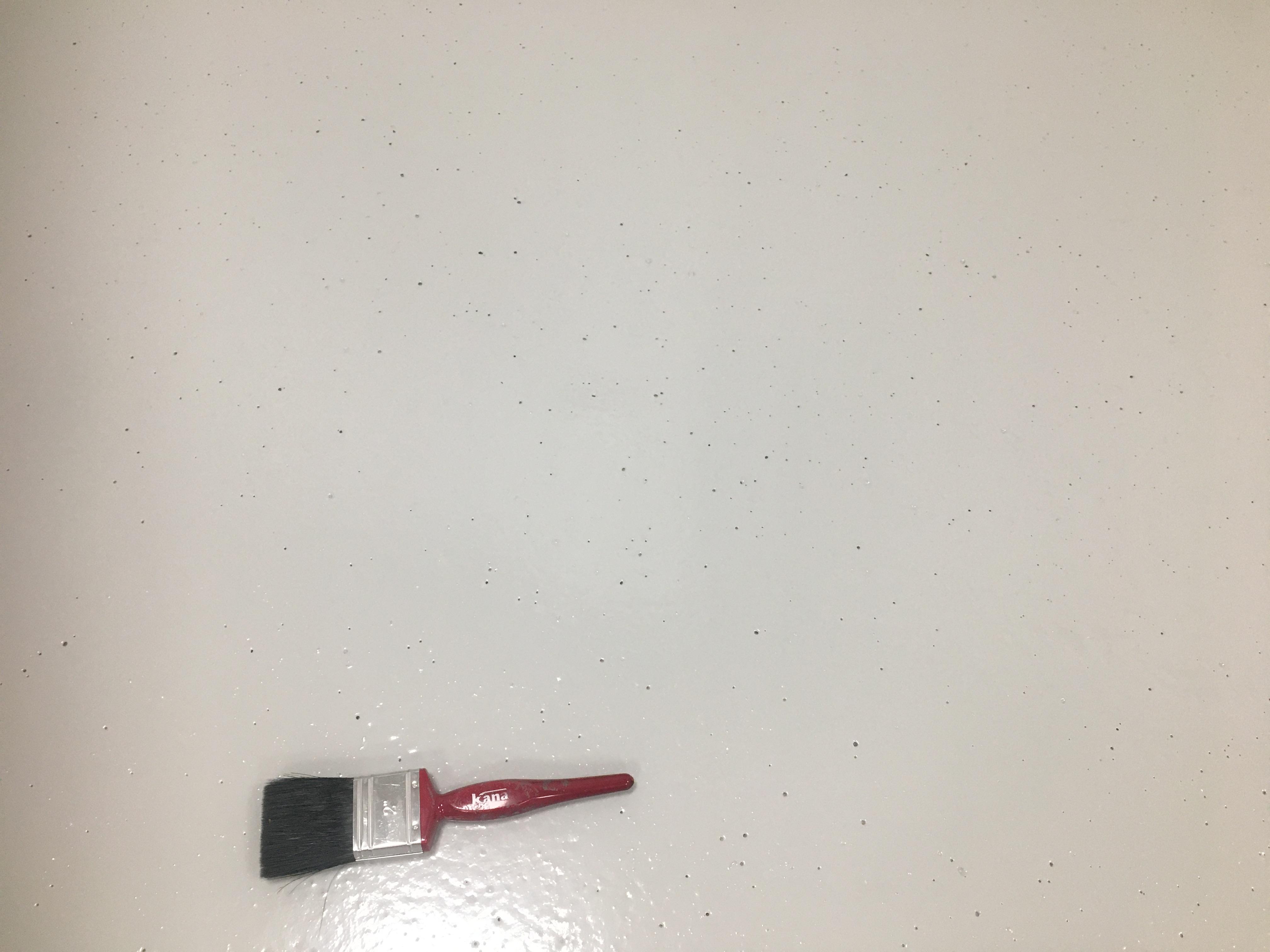

Posted

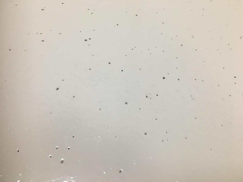

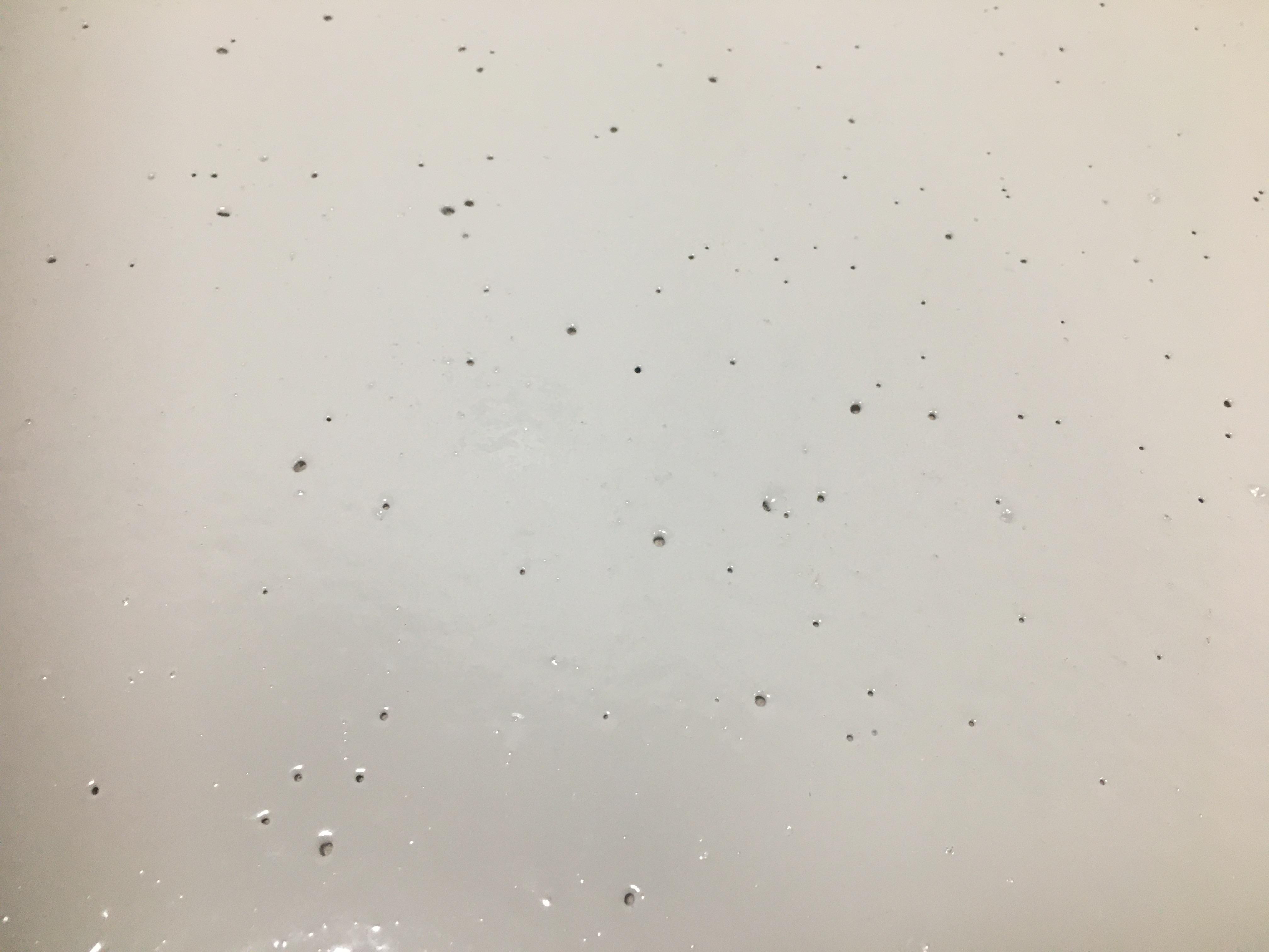

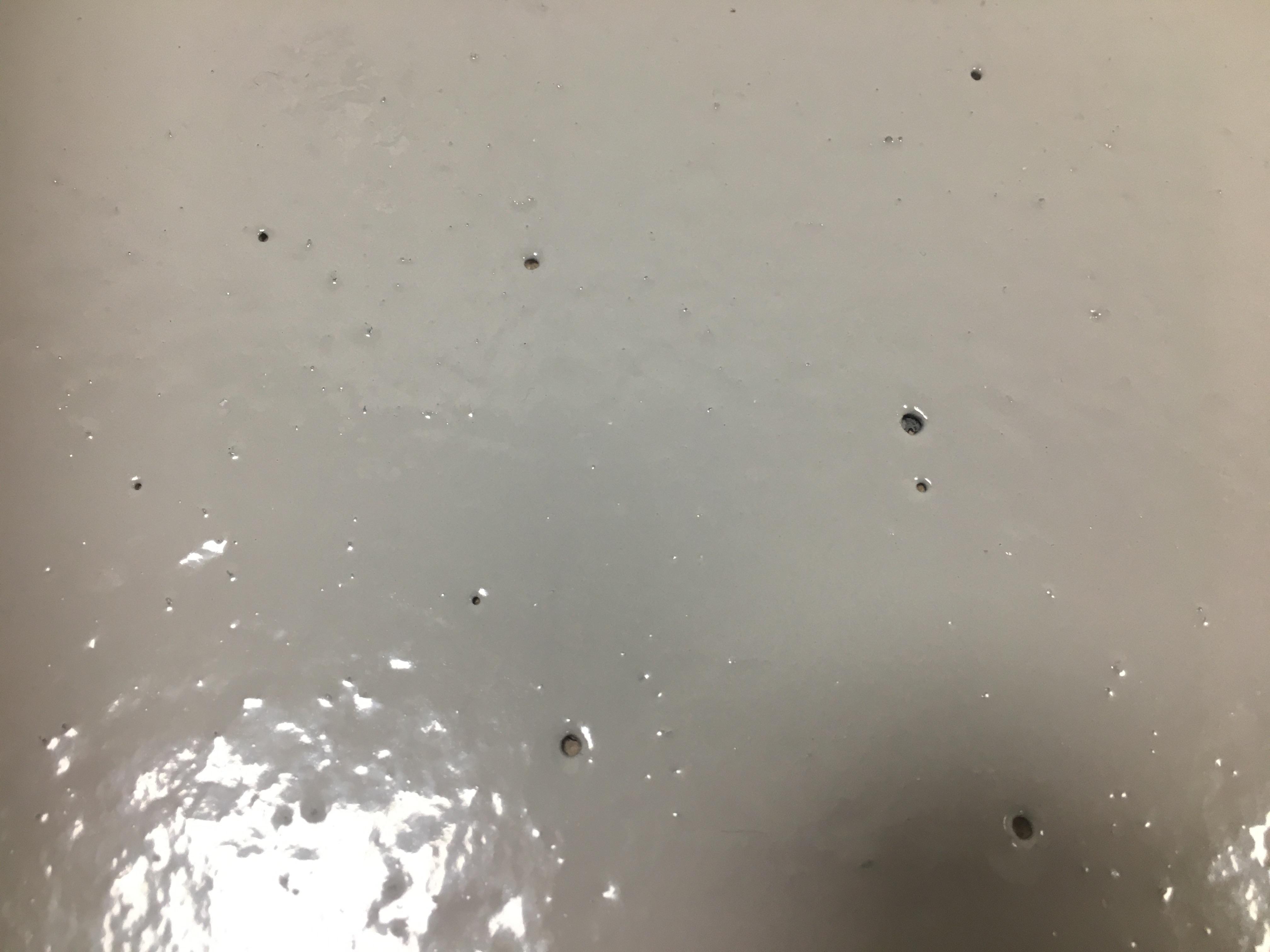

Did the epoxy this week. First coat was a primer/sealer which penetrated nicely in to the concrete - have to work fast.
Top coat of 2 part epoxy went on lovely. Some holes filled but what I found was there were a lot more holes than I had realised. Guess the light grey gloss against the holes highlights them a lot more too.
In two minds whether to buy more and add another coat - think even if I did, it wouldn’t fill all of them unless I made it really thin which I’m reluctant to do as the top coat should really be a higher build to be as robust as possible.
Tempted to just leave it. Don’t intend to get the area wet or work out there without spill trays etc anyway.
