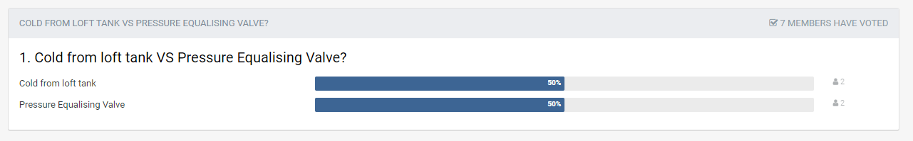

Oxbow16 Posted September 25, 2021 Posted September 25, 2021 First - an apology for monopolising the forum with all my plumbing questions! I'm hoping this will be my last and I'll move onto something else (like choosing a woodburner, which is the next thing on the to do list)... My situation... We've having a bathroom refit and will have a new bath with shower mixer tap. We've got an oil boiler and vented system. We're eco minded and are happy with a very weak shower. In fact, that's our preference. So we don't want to install a pump, shower power, new unvented cylinder, etc. etc. There will be another shower in the house too. The cold is currently mains. I've narrowed it down to two options: 1. Put a pressure equalising valve under the bath so the hot and cold have matched pressure. 2. Run a cold feed from the tank in the loft, so both hot and cold are gravity fed. (The tank is 40 Gallon actual / 60 Gallon nominal). Some relevant points for both 1 and 2: - Is a 40/60 gallon tank large enough to run the cold and hot from? - The tank isn't far away from the bathroom ceiling, so wouldn't need a long run of pipe to get to he shower mixer tap - The pipe from the loft would be coming down the tap end wall of the bath, so would need to be chased in / tiled over. However, the mains cold goes up to the loft on the wall too, so there's already a pipe being chased in there... - The mains cold comes up from the room below where the bath will be (tap end) - The bath panel will be removable, so accessing the PEV wouldn't be an issue - Future proofing... Hopefully the boiler has years left in it, but if/when it goes we don't know what we'll go for next. Are PEVs useful in unvented and/or combi boiler set ups (when used with bath shower mixer taps)? I've read very opposing answers to that question! - I presume performance will be similar in both set ups, so if there's likely to be a big price difference between the two then that might help decide. I'll add a poll for the sake of it. A vote, or a thought on any of the above, would be most welcomed. Many thanks and have a great weekend everyone.
Oxbow16 Posted September 28, 2021 Author Posted September 28, 2021 Thanks to whoever voted Any the thoughts / votes from anyone? Cheers

SteamyTea Posted September 28, 2021 Posted September 28, 2021 No help what so ever, but as 7 have voted, half votes must be allowed.
Oxbow16 Posted September 28, 2021 Author Posted September 28, 2021 5 hours ago, SteamyTea said: No help what so ever, but as 7 have voted, half votes must be allowed. That is odd. And I see the totals don't add up either. IE - in your quoted section. 2 votes for each (so 4), but total is 7. And as it currently stands, 3 votes for each (so 6), but total voters is 9. Maybe there's a hidden Brewster's Millions option for "None of the Above"?! If you've not seen that film I guess that won't make any sense! 5 hours ago, joe90 said: Not sure if this is correct but I was told years ago you were not allowed to run cold from a tank to a shower if the hot is mains pressure??. This was so that if the tank ran dry someone could be scalded as the hot continued to flow. ?… That seems sensible. In my case hot is from the tank, but good to know these things nonetheless. 6 hours ago, tonyshouse said: some modern mixer valves can cope with cold mains and hot from rank That's interesting, I wasn't able to find any. Do you have any links/suggestions by any chance? Cheers for the replies
