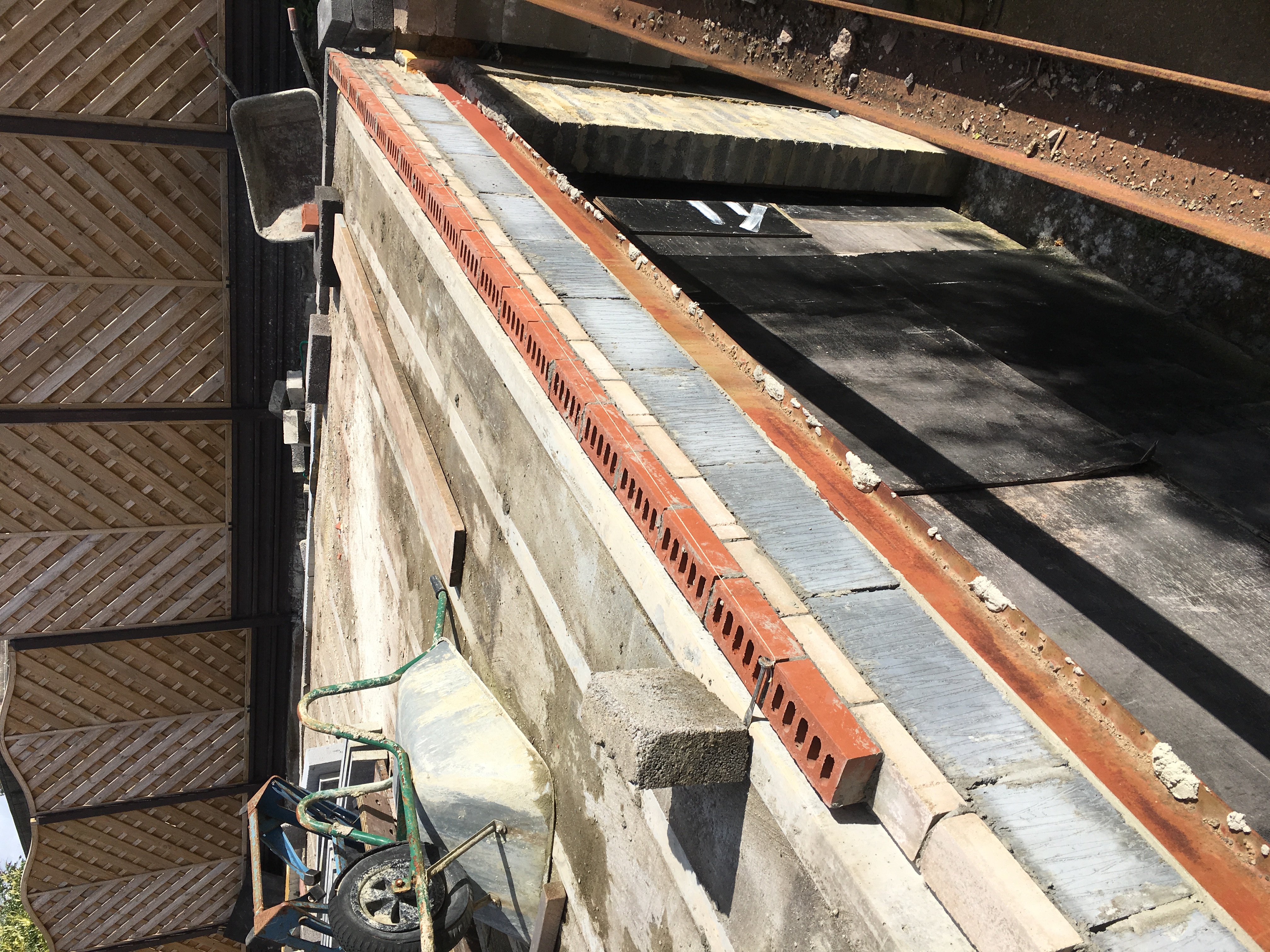

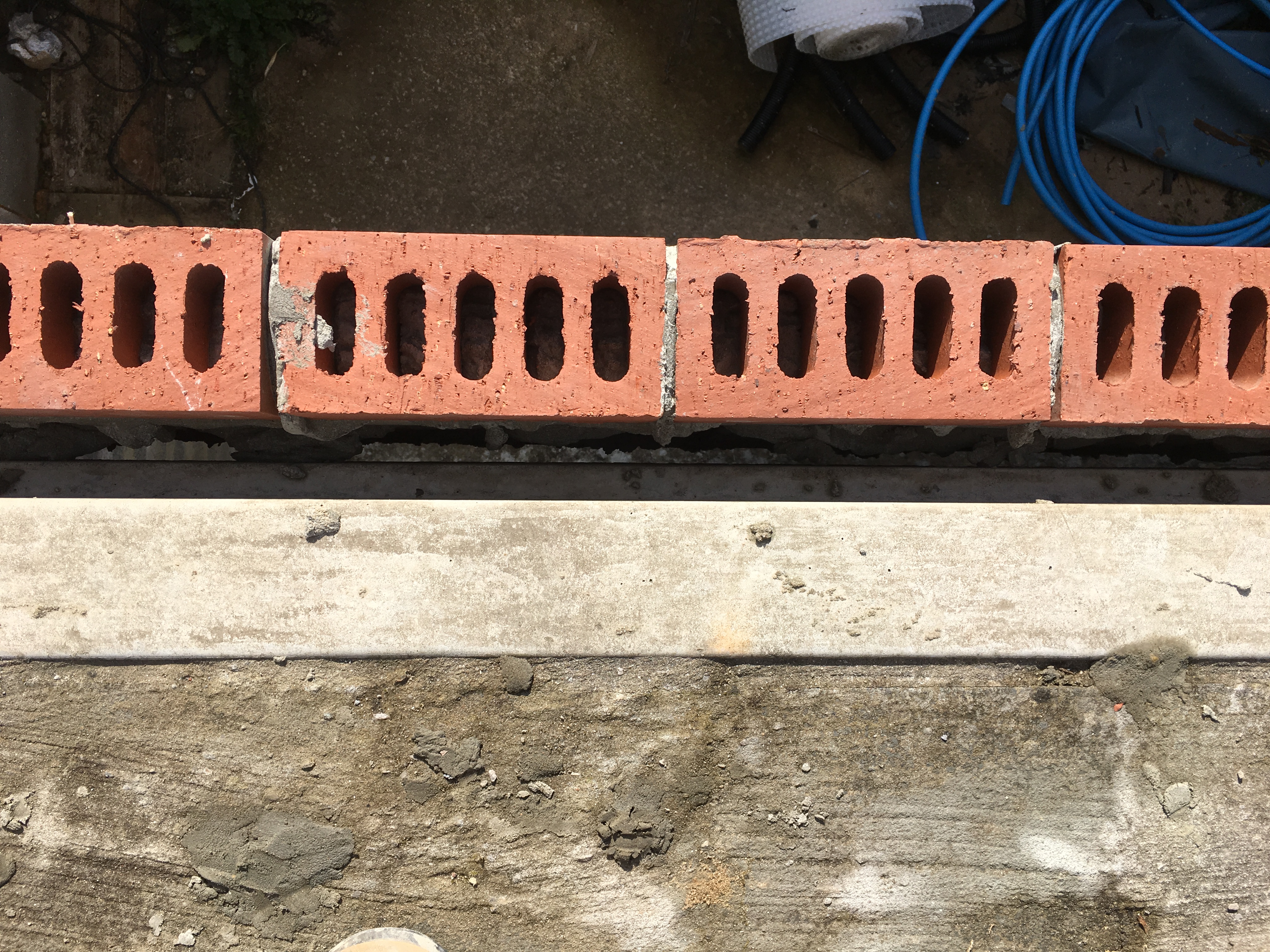

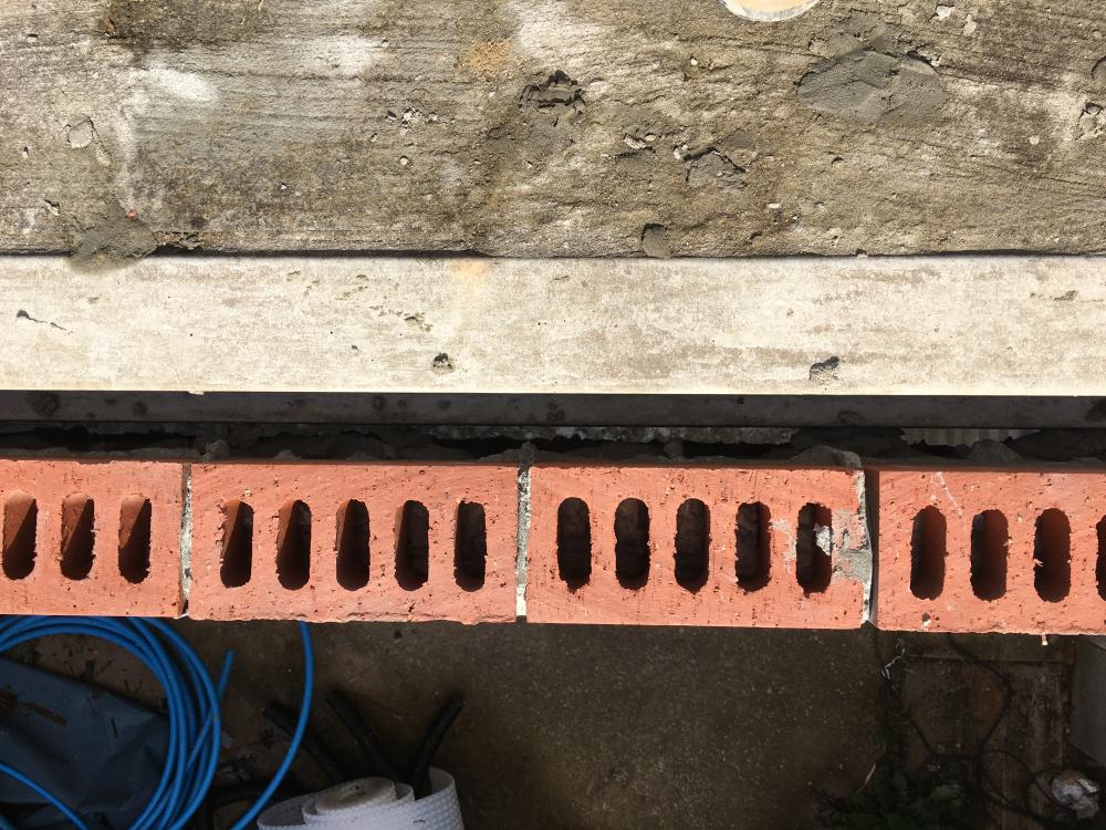

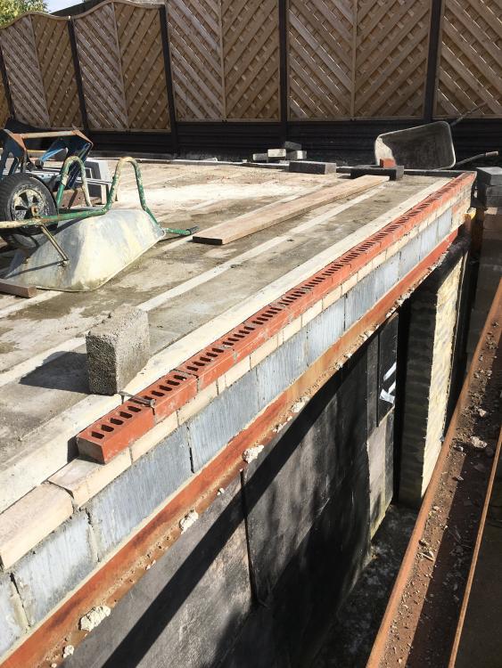

Pocster Posted March 31, 2017 Share Posted March 31, 2017 Hey all, My steel was placed ages ago and once the beam and block were in place it can be seen there's a slight gap. Do I just shutter underneath (say scaffold boards with acro props) and simply put some concrete in the gap to fill it and bond with the steel? Or something more elaborate??? Cheers Link to comment Share on other sites More sharing options...

Triassic Posted April 1, 2017 Share Posted April 1, 2017 Not sure which gap you're referring too. Can you be more specific? Link to comment Share on other sites More sharing options...
Onoff Posted April 1, 2017 Share Posted April 1, 2017 Zoom in on the first photo and you can see the top flange of the I beam. This is the I beam in the second photo supporting the line of full depth blocks. Think I'd squirt some foam down the gap (or from the underside) the stop the concrete falling through. 1 Link to comment Share on other sites More sharing options...
Pocster Posted April 1, 2017 Author Share Posted April 1, 2017 Thanks guys the beam curved not an issue just the gap looking face down between the brick work and the concrete beam . might just foam a bit underside then put concrete in . I did notice as I tapped each block as I laid them the beam 'bounced' which isn't very re assuring ..... cheers Link to comment Share on other sites More sharing options...
