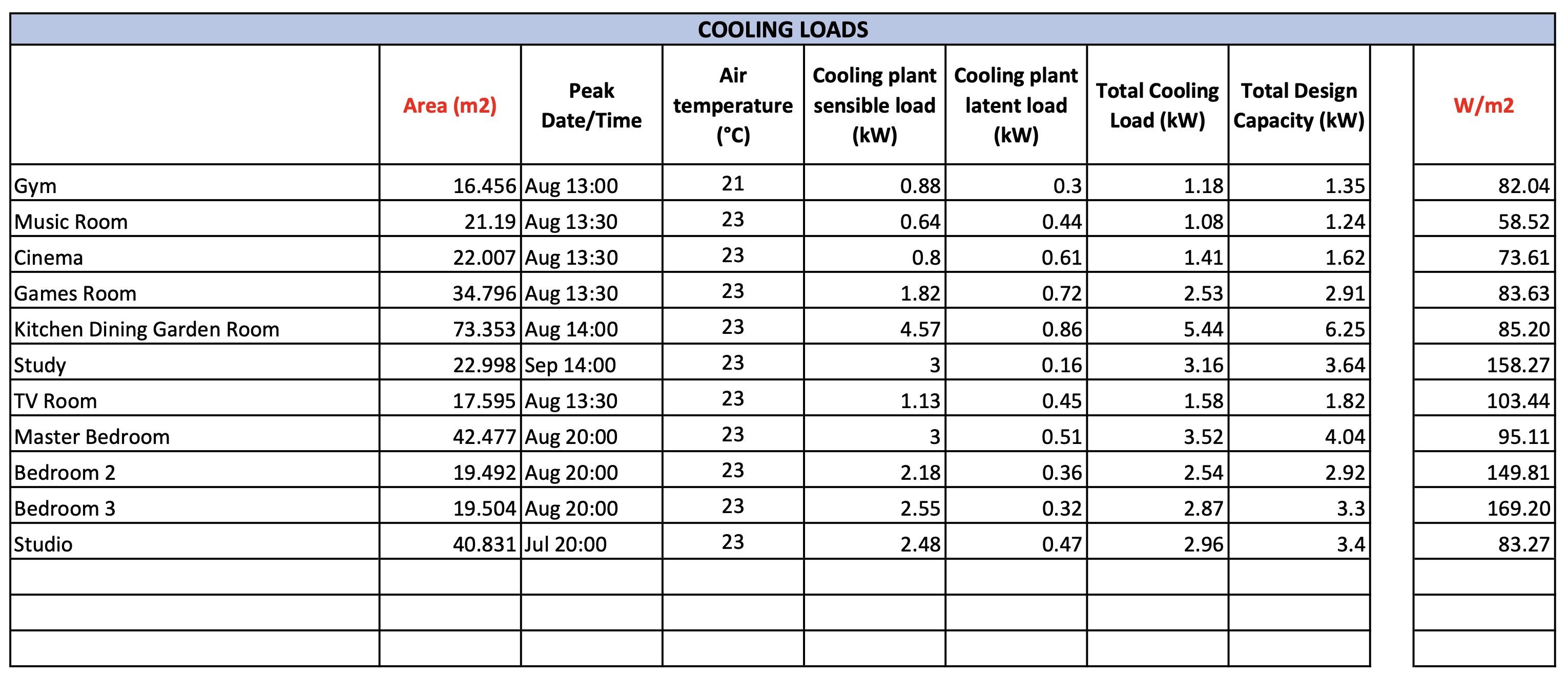

Thorfun Posted October 2, 2021 Share Posted October 2, 2021 I received my cooling modelling back @Dan F and this is what it says: I only got it late on Friday so didn't get a chance to ask questions as it looks like it doesn't take the shading of the external blinds in to consideration but I'll ask that on Monday. just seems quite a high cooling load. anyone got any comments on this? (probably should start my own thread on this subject but ho-hum) Link to comment Share on other sites More sharing options...
joth Posted October 2, 2021 Share Posted October 2, 2021 1 hour ago, Thorfun said: load. anyone got any comments on this? Hope you installing 3 phase, and got enough space for a serious outdoor heat exchanger. Over 30kW of cooling? on a UK domestic home sounds insane. https://www.orionairsales.co.uk/daikin-air-conditioning-rooftop-packaged-uatyq30abay1-heat-pump-30kw100000btu-415v50hz-10214-p.asp Link to comment Share on other sites More sharing options...
Thorfun Posted October 2, 2021 Share Posted October 2, 2021 1 hour ago, joth said: Hope you installing 3 phase, and got enough space for a serious outdoor heat exchanger. Over 30kW of cooling? on a UK domestic home sounds insane. https://www.orionairsales.co.uk/daikin-air-conditioning-rooftop-packaged-uatyq30abay1-heat-pump-30kw100000btu-415v50hz-10214-p.asp yeah, that's what I thought. makes me think they didn't take any of our solar gain mitigation strategies into consideration. in fact, I think I've literally thrown money down the toilet for that cooling demand report. Link to comment Share on other sites More sharing options...
Dan F Posted October 2, 2021 Share Posted October 2, 2021 3 hours ago, Thorfun said: yeah, that's what I thought. makes me think they didn't take any of our solar gain mitigation strategies into consideration. in fact, I think I've literally thrown money down the toilet for that cooling demand report. Wow! Agree, that doesn't seem to make much sense! Did they tell you what method they used for this or what their assumptions and inputs were? Are they considering MVHR (on summer bypass), opening of doors/window? What heat inputs are being used (people, cooking, UVC/recirculation losses)? Our PHPP calculation gave 1.1W/m2 (4.2W/m2 without blinds). We do have 750mm overhangs and a large canopy on south elevation though. Link to comment Share on other sites More sharing options...
Thorfun Posted October 3, 2021 Share Posted October 3, 2021 10 hours ago, Dan F said: Wow! Agree, that doesn't seem to make much sense! Did they tell you what method they used for this or what their assumptions and inputs were? Are they considering MVHR (on summer bypass), opening of doors/window? What heat inputs are being used (people, cooking, UVC/recirculation losses)? Our PHPP calculation gave 1.1W/m2 (4.2W/m2 without blinds). We do have 750mm overhangs and a large canopy on south elevation though. they didn't give any details at all! (this wasn't Enhabit btw). the report was a couple of tables with no explanation of how the model was achieved etc and I have sent them an email asking for details and telling them how unhappy I am with their 'report'. one table seems to allude to them using occupancy and equipment to determine the cooling demand. no mention of blinds, MVHR or anything else. really think I wasted my money on this one but will see what they respond with when they get back to work tomorrow. Link to comment Share on other sites More sharing options...
Dan F Posted October 3, 2021 Share Posted October 3, 2021 4 hours ago, Thorfun said: they didn't give any details at all! (this wasn't Enhabit btw). the report was a couple of tables with no explanation of how the model was achieved etc and I have sent them an email asking for details and telling them how unhappy I am with their 'report'. one table seems to allude to them using occupancy and equipment to determine the cooling demand. no mention of blinds, MVHR or anything else. really think I wasted my money on this one but will see what they respond with when they get back to work tomorrow. Ask them if you should get 30kW heat pump based on this, see what they say. Enhabit couldn't do this? Not sure how much you paid, but might have been worth getting PHPP. Link to comment Share on other sites More sharing options...
Thorfun Posted October 3, 2021 Share Posted October 3, 2021 2 hours ago, Dan F said: Ask them if you should get 30kW heat pump based on this, see what they say. Enhabit couldn't do this? Not sure how much you paid, but might have been worth getting PHPP. Enhabit could do PHPP for me but said it has limitations in that it's whole house rather than room by room. Also, I'd already paid the other company for the thermal modelling and SAP report so the cooling demand wasn't as much as getting Enhabit to do a whole new thermal/cooling/phpp modelling. in for a penny, in for a pound as they say! I'll see what they say in response to my snotty email. Link to comment Share on other sites More sharing options...
Dan F Posted October 3, 2021 Share Posted October 3, 2021 35 minutes ago, Thorfun said: Enhabit could do PHPP for me but said it has limitations in that it's whole house rather than room by room Yeah. Although if you know you have automated blinds in any rooms likely to have any significant solar gain then this limitation is less of an issue in my opinion. That said, I would have done the same and not got PHPP if I'd already paid someone to do thermal modelling and wasnt certifying. 1 Link to comment Share on other sites More sharing options...
