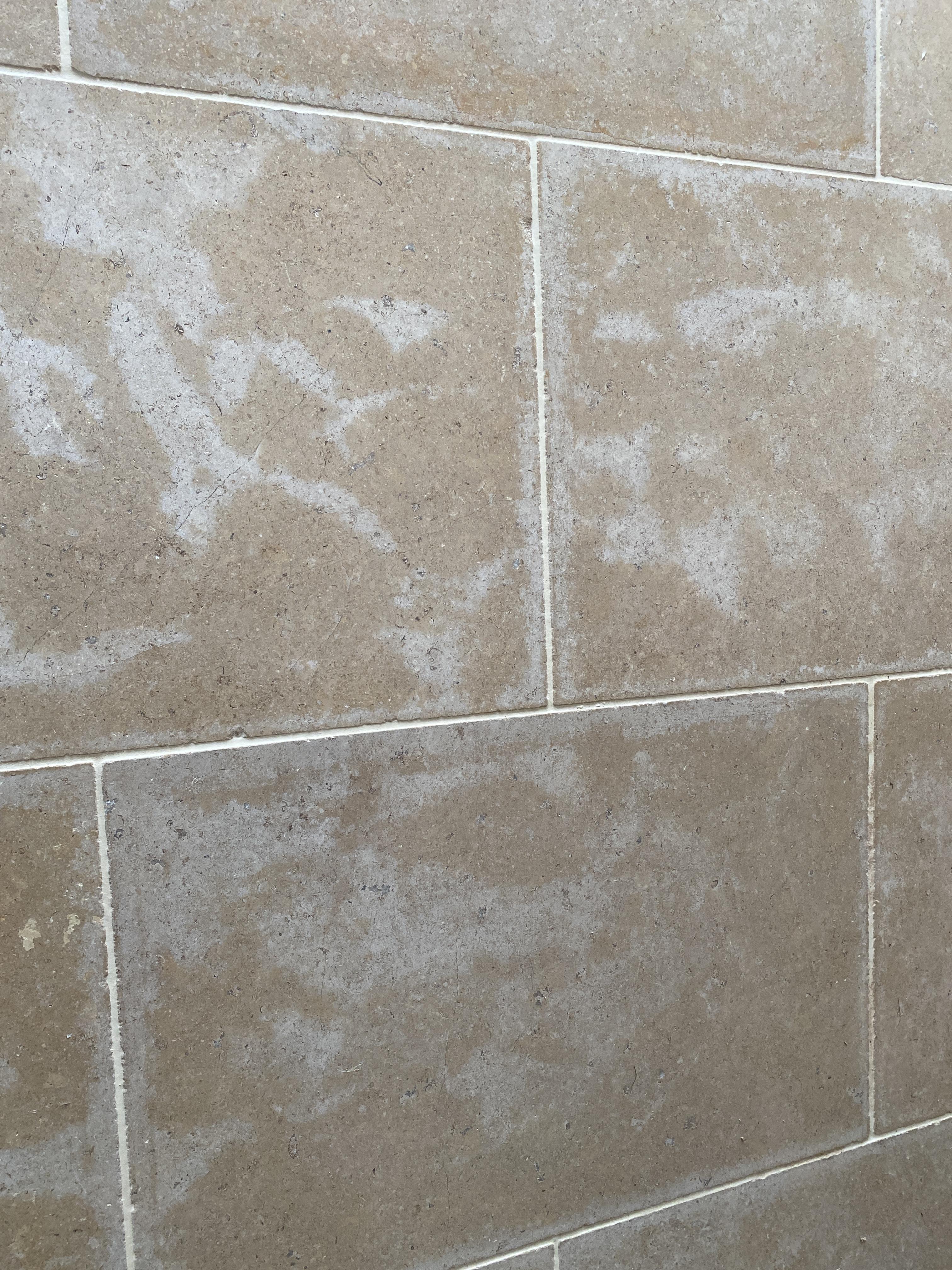

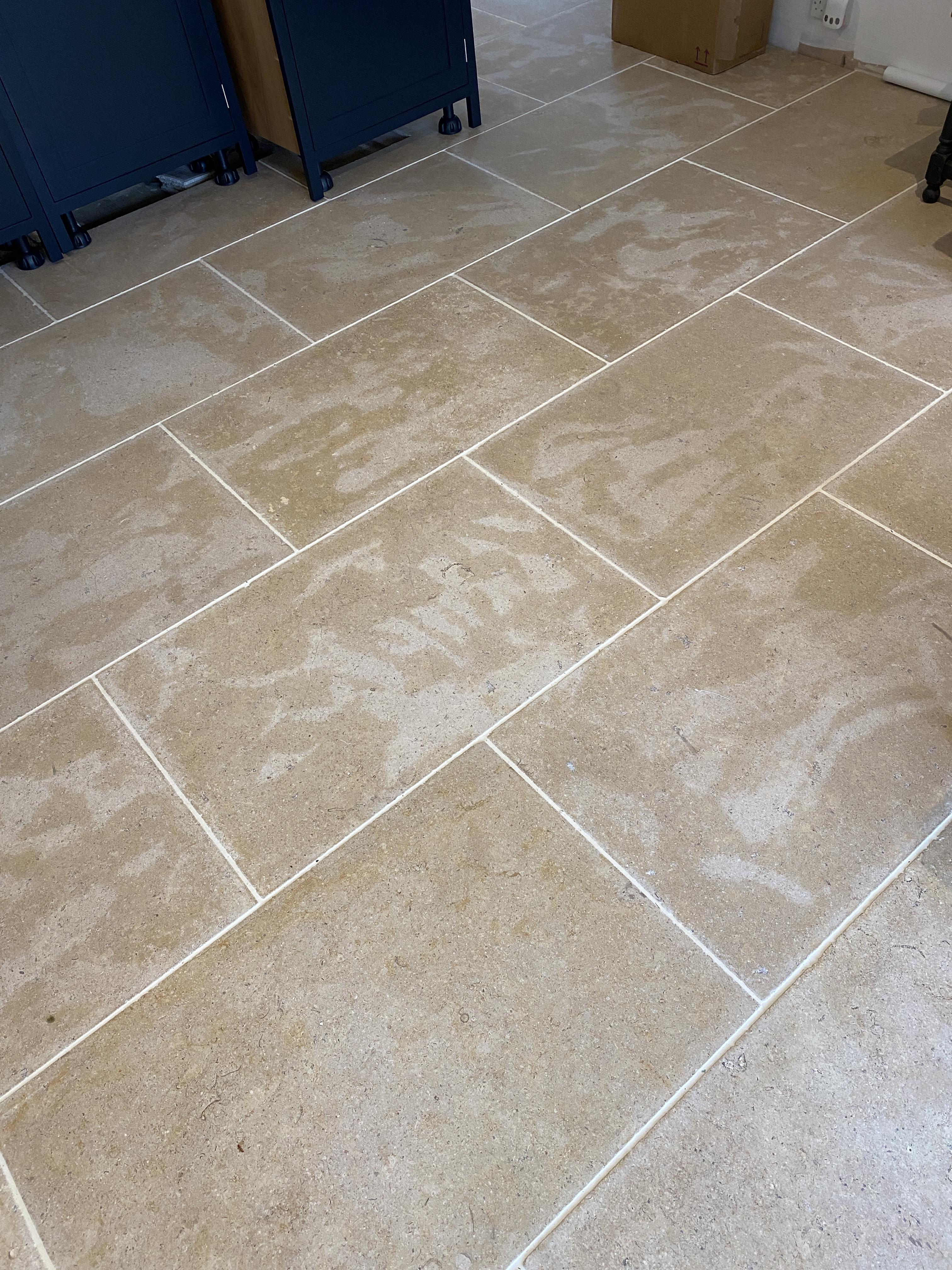

CotswoldDoItUpper Posted September 7, 2021 Posted September 7, 2021 We’ve just had our tiles laid and they’ve gone patchy! They’re 15mm Egyptian natural limestone (not sure the country of origin makes a difference!!) they were laid with mapi flexible adhesive over a ditra mat. Some of it was quick drying some not. Then it was sealed, grouted and washed twice. The sealant was lithofin stain stop. Any ideas why they’re like this?!? thanks!
Marvin Posted September 7, 2021 Posted September 7, 2021 In my humble opinion your information suggests that the tile is reacting from the back of the tile not being sealed. It could be that this is moisture from the adhesive trying to get out and it may eventually sort itself out. Tiles stuck on, grouted and sealed in swift time could be a reason espically with a natural product. M
nod Posted September 7, 2021 Posted September 7, 2021 Limestone should be left to dry out before sealing them grouting 2-3 days 1
CotswoldDoItUpper Posted September 7, 2021 Author Posted September 7, 2021 2 minutes ago, nod said: Limestone should be left to dry out before sealing them grouting 2-3 days I think that’s the issue. tiler has suggested the fix is to come back, remove the sealer wait 5-7 days then re seal. does that sound like it might fix the issue?
nod Posted September 7, 2021 Posted September 7, 2021 I’m not sure how he will remove the sealer If it was applied correctly Two coats 3 hours apart It will have soaked right through the tile

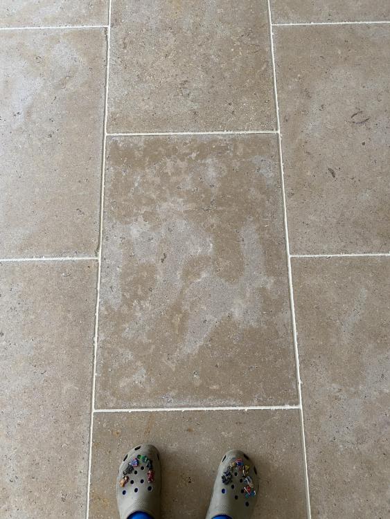

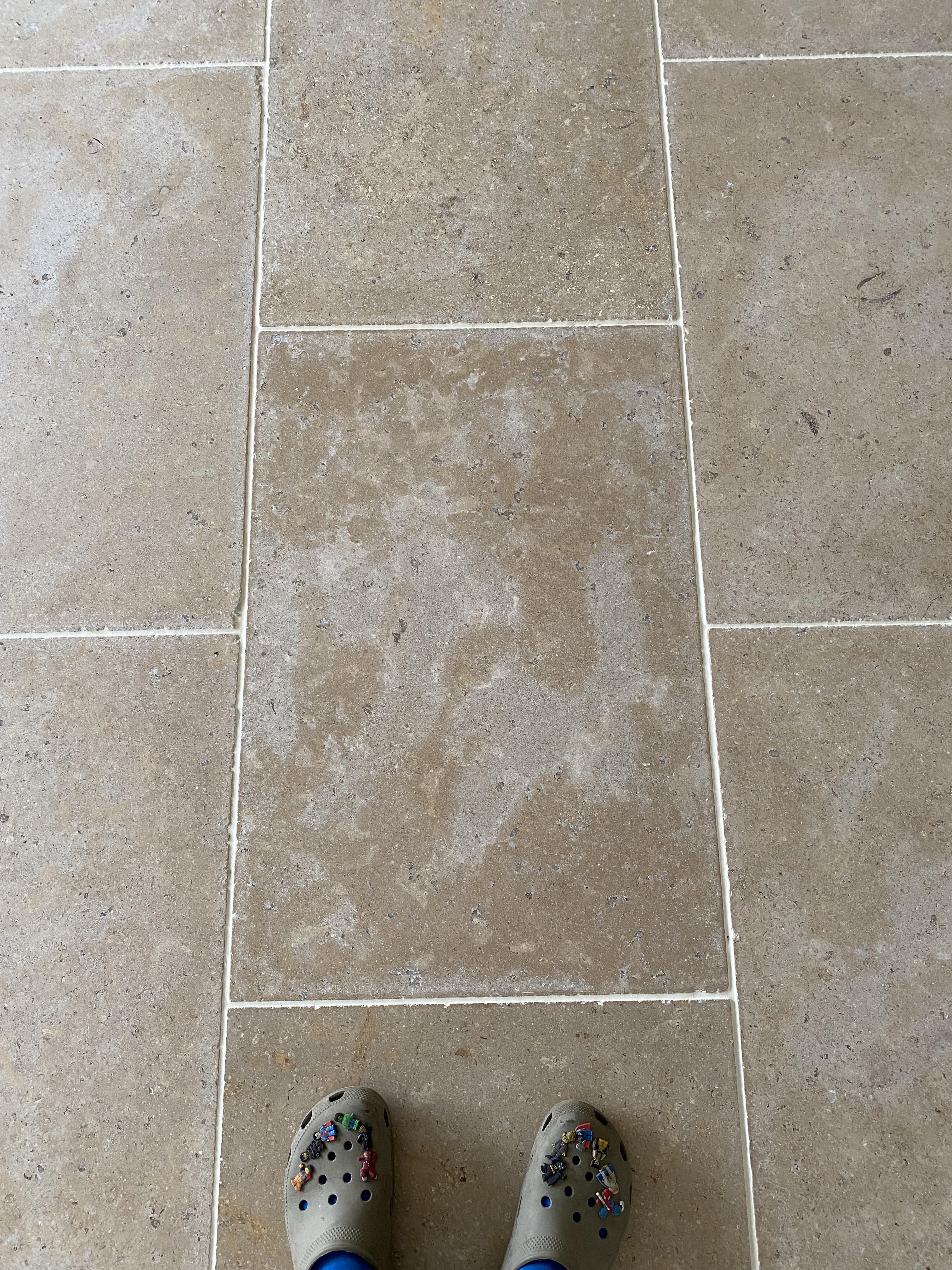

CotswoldDoItUpper Posted September 9, 2021 Author Posted September 9, 2021 So the sealant has been removed this am. 2 hours to remove 55sqm. And think there are bits where there is still some left as it feels greasy. Assured that this is the damp. it has made a bit of a difference in some areas, less white, but my baseline tile still looks awful. Now have to wait 5-7 days for the tiles to dry out. Can’t see it making any difference to be honest.

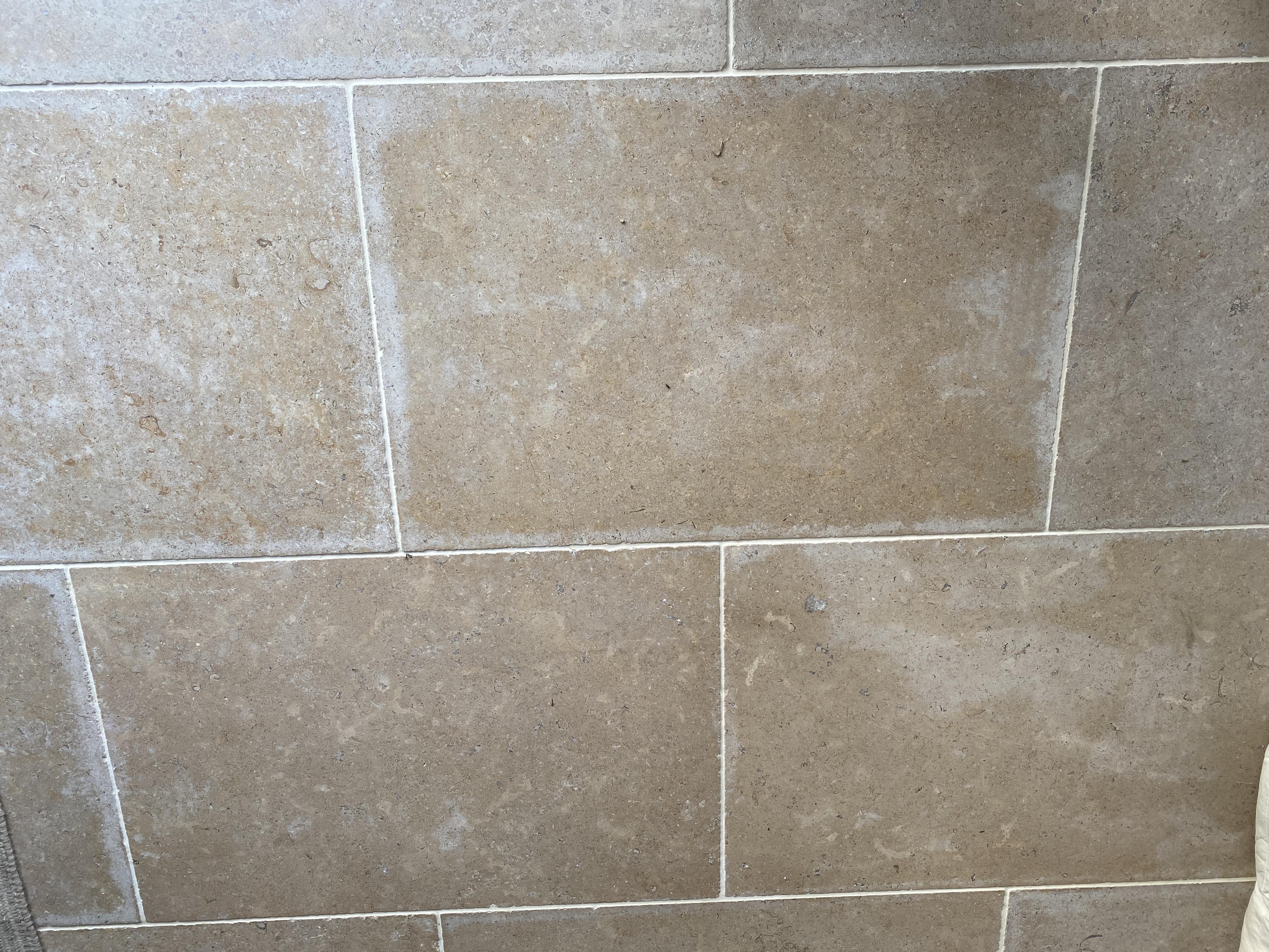

CotswoldDoItUpper Posted September 15, 2021 Author Posted September 15, 2021 7 days after removing sealer we have this. Would it make a difference if the tiler had used the wrong version of lithofin stain-stop? For example He might have used KN instead on MN by accident. Would this have made a difference?
