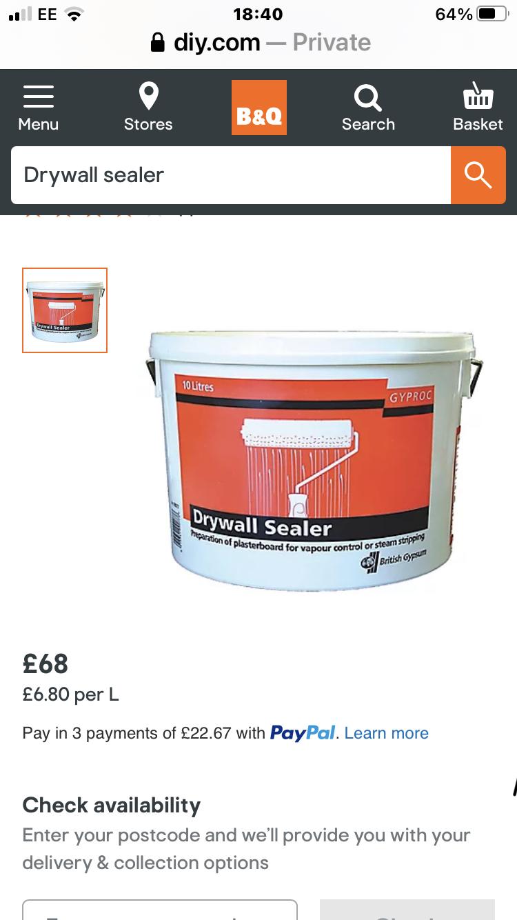

nod Posted September 6, 2021 Share Posted September 6, 2021 I’m not sure who told you it was discontinued I buy it by the pallet load Even B&Q sell it Gypsum drywall sealer Link to comment Share on other sites More sharing options...
nod Posted September 6, 2021 Share Posted September 6, 2021 (edited) 5 minutes ago, nod said: I’m not sure who told you it was discontinued I buy it by the pallet load Even B&Q sell it Gypsum drywall sealer A little expensive Though probably includes the vat I think when your BM says discontinued Its code for can’t be Arsed ordering half a dozen tubs ? Edited September 6, 2021 by nod Link to comment Share on other sites More sharing options...
Donegalsd Posted September 6, 2021 Author Share Posted September 6, 2021 5 minutes ago, nod said: I’m not sure who told you it was discontinued I buy it by the pallet load Even B&Q sell it Gypsum drywall sealer Gyproc ireland told me. It doesn't seem to be on any irish websites. I'm only 30 min from the border so it's no hassle. Does it go on handy enough with a paint spay gun? Anything special to know about its use. I'm pretty sure my painter hasn't used it before. Thanks Link to comment Share on other sites More sharing options...
nod Posted September 6, 2021 Share Posted September 6, 2021 Yeah we spray it It goes on like water and soaks in quickly and doesn’t run It hardens the surface of the board You can normally coat a four bed house in a couple of hours 1 Link to comment Share on other sites More sharing options...
