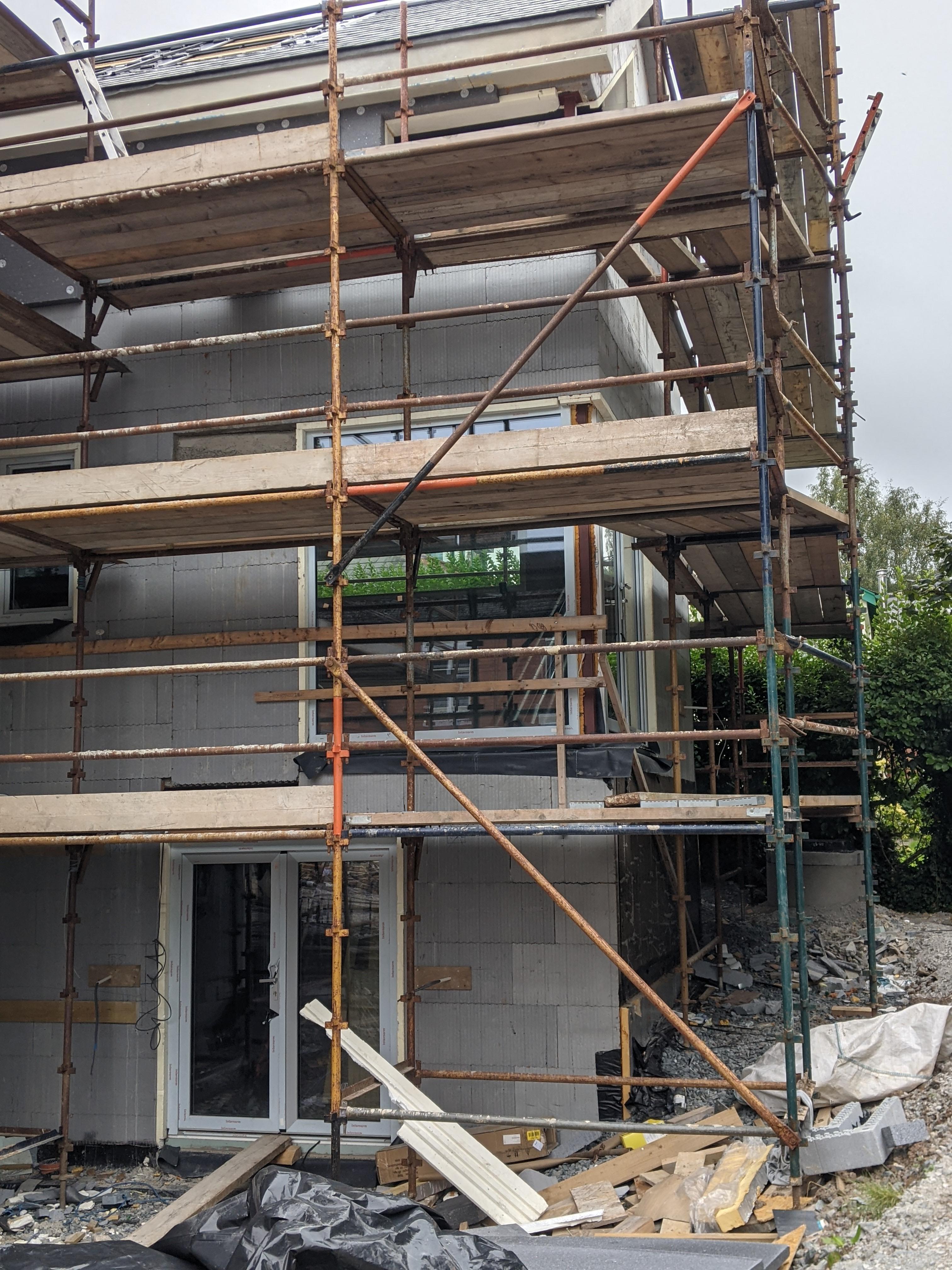

Blynchy Posted September 1, 2021 Share Posted September 1, 2021 Hi Folks, I am looking for any advice you can offer regarding the corner window I'm going to install in my living room. I will be constructing the building from ICF so I intend to create a hidden cantilever from both sides within the walls meaning I won't need a corner post. My thinking at the moment to make this stand out would be to put a glass to glass corner in. Another option would be to have two sliders meet in the corner and when you pull them back, it will be an open space; the only problem with this is that there are two frame meeting in the corner and the majority of the year it will be closed. I also considered Bifold but I can't seem to convince myself they are right for this situation. I would love to hear anyone's thoughts or ideas and if they have done something like this before. Finally, I would love to hear thoughts on the layout itself Layout of Living Block.pdf Elevations.pdf Link to comment Share on other sites More sharing options...

Conor Posted September 2, 2021 Share Posted September 2, 2021 (edited) You wont be able to get a cantilever there. You generally need double the wall length to opening sizein order to carry the cantilever, regardless of method used. We have a 2x2m opening on a 5x5m room and has a 80mm corner post. It was originally designed as a cantilever but didn't work once we added the extra story on top. If I were you, do the same as us and make both returns the same - i.e. 2.5m x 2.5m. Hard to see much with the scaffolding up Edited September 2, 2021 by Conor Link to comment Share on other sites More sharing options...
