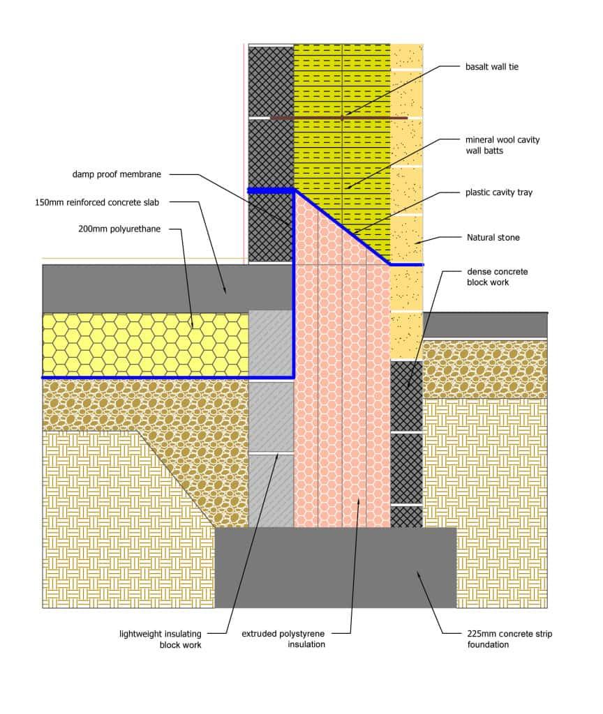

I used insulation to stop a thermal bridge from the cavity infill of concrete, building inspector accepted it. We lowered the DPC in line with the inner floor level and added an extra DPC in the outer brickwork to cope with rain bounce (DPC 6” above outer ground level).
