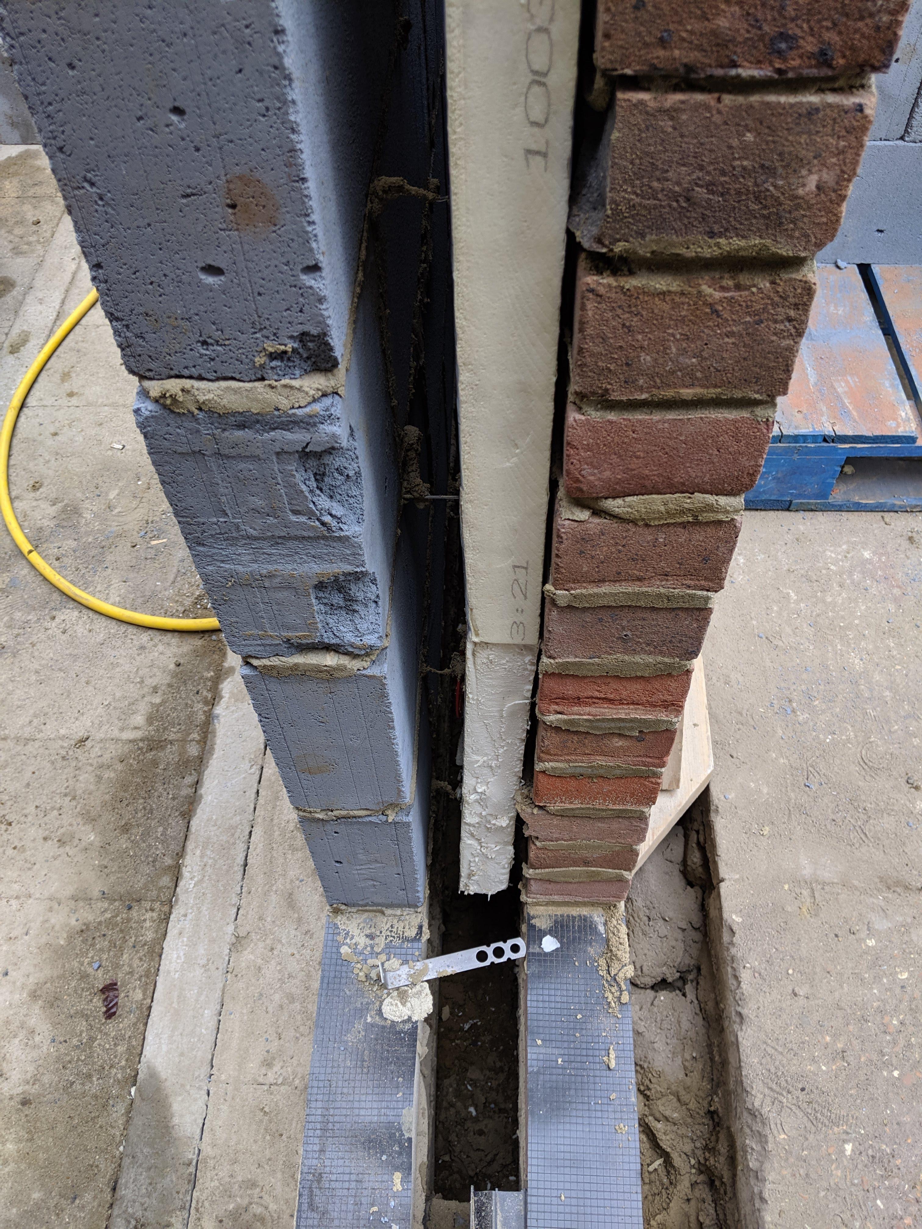

BenP Posted August 23, 2021 Share Posted August 23, 2021 I think architects have been pushed and pulled around by manufacturers - cavity good, cavity bad. Fullfill good, fullfill bad... etc! If space allows we tend to feel a bit more comfortable down the Rockwool type fullfill arrangement. For people who have seen the quality of a typical partial cavity board install this will make complete sense. Not abutted, at funny angle etc. Awful. I'll leave you with the attached to further prove my point....and tickle you all... Link to comment Share on other sites More sharing options...
