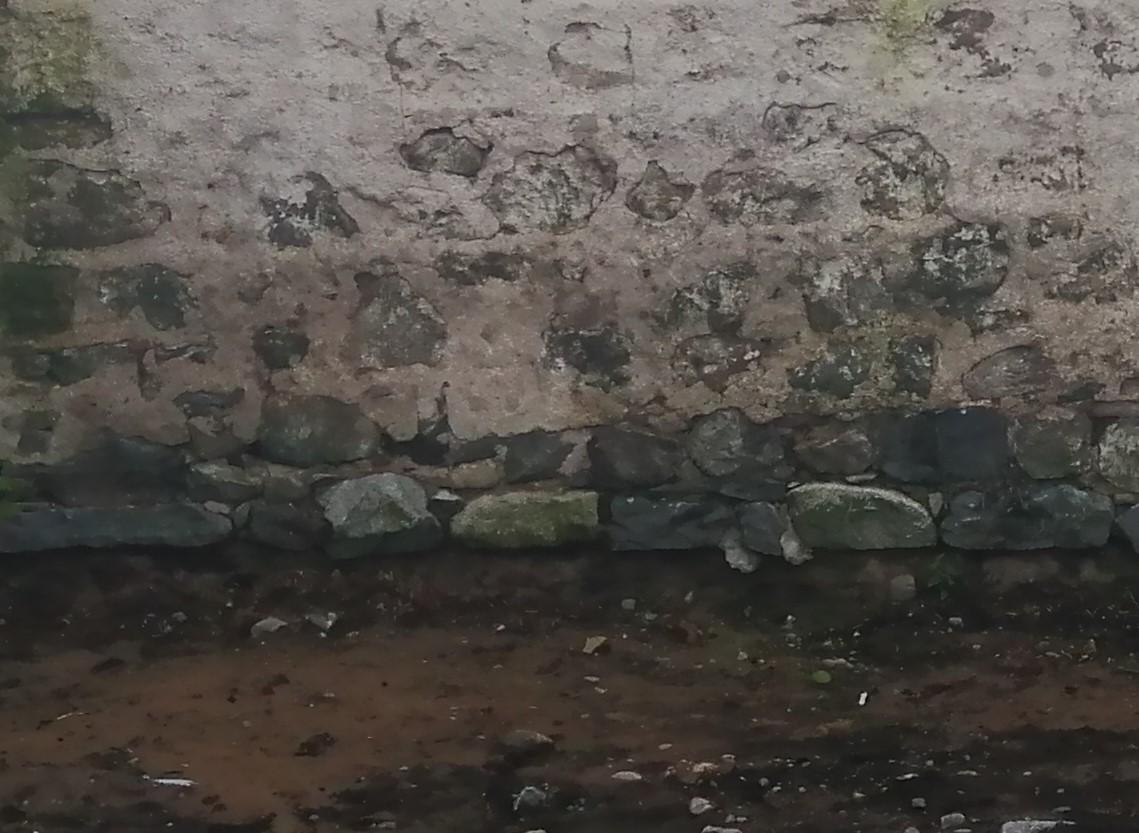

saveasteading Posted August 19, 2021 Author Posted August 19, 2021 5 minutes ago, TonyT said: my 600mm thick whinstone walls. Explain further please? Did you cut a hole through the stone or under it? This picture shows the wall and where the footing has been exposed. in case not apparent, the lighter colour at the bottom is the virgin sand and a puddle, then there is darker colour below the stone, which is the vertical bed. All we have removed was manure, so this situation has been standing for decades. We will be protecting and filling that eroded edge.

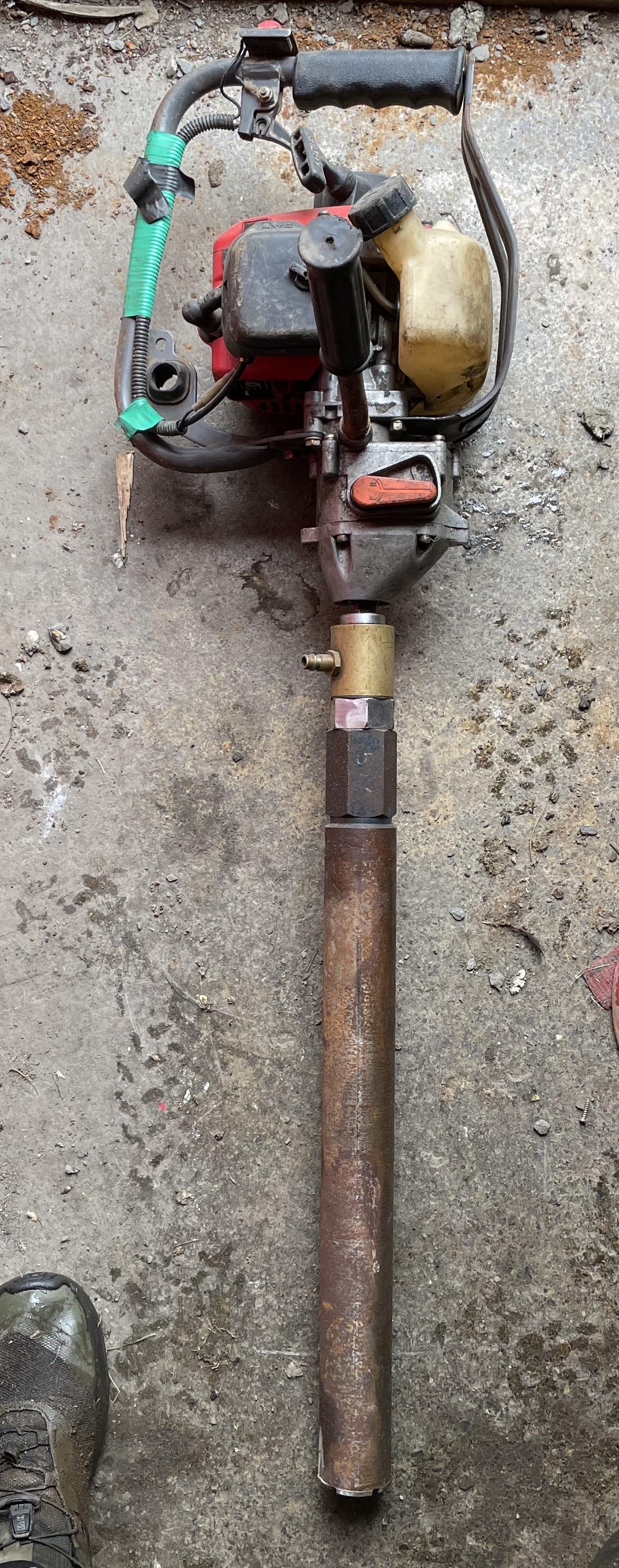

TonyT Posted August 19, 2021 Posted August 19, 2021 I cored a hole for the flue and it took 12 plus hours( borrowed all the correct gear from work) when we first bought the house i kango’d a hole for a waste pipe years later when we did an extension and it it was done in an hour! so coring for me had no making good, kango/img the hole required some making good but was still quicker 1
Cpd Posted August 19, 2021 Posted August 19, 2021 Just done this on my old wall that is exactly the same as yours, I just picked a big stone and dug under it and did the same on the inside, put my 110mm soil pipe under with a swept bend coming up on the inside and then refilled the hole with stone and cement until it was back up to wall height. Previously I have core drilled (I have a proper petrol core drill) straight through but you can get into difficulty with the rubble in the middle of the wall…. and on another building I just used a drill hammer + chisel to remove the mortar around a stone, pulled it out and repeated on the far side, removed the rubble very carefully so as not to dislodge excess amounts and fed a 100mm extractor fan pipe through and re cemented the hole. 1

saveasteading Posted August 21, 2021 Author Posted August 21, 2021 15 hours ago, Gus Potter said: That's interesting what you're doing so would like to hear more! The stone is mostly granite in boulder form, but dressed at the corners. the frontage is mostly sandstone ashlar, with some serious but traditional architecture to it. what we think is the oldest part has some enormous boulders as the base layer. We are currently doing serious repairs that don't involve regulations, to keep the worst of the water out, as that has caused some local failures to stone and timber. the exposed base will be buried when the courtyard is built up for domestic use. meantime I intend to bank stiff mortar under and onto the face to reinstate full bearing and divert water to ground. this face has been exposed for decades, other than having 18" of manure against it, so is not about to fail. the ground is pure sand, rather dense and amazingly single-sized, yet angular, so is strong and porous, yet very easy to handle. The downside would be supporting any trenching and avoiding undermining. I am a Chartered Civil Engineer but don't have experience of stone buildings or A frame roofs. Thanks to all of you. Enough for now, and I welcome any tips on such buildings.
Cpd Posted August 21, 2021 Posted August 21, 2021 On 20/08/2021 at 14:30, saveasteading said: How did you do it? My footing stones are on stable earth and it’s easy to just dig a long deep hole from either side, given you have sand it might be problematic taking this approach, I also my core drill and with a bit of carful measuring you can get a good line up so that the holes meet, I have a mix of bits going up to 120mm. I have restored 3 old buildings or at least am in the process of restoring 3 buildings that are your typical old - very old croft houses that you see the remains of all over Scotland, it’s very challenging and expensive and given my time again I would have knocked at least one of the 3 down and got a nice new build when I had the cash but that ship has sailed long ago…..
