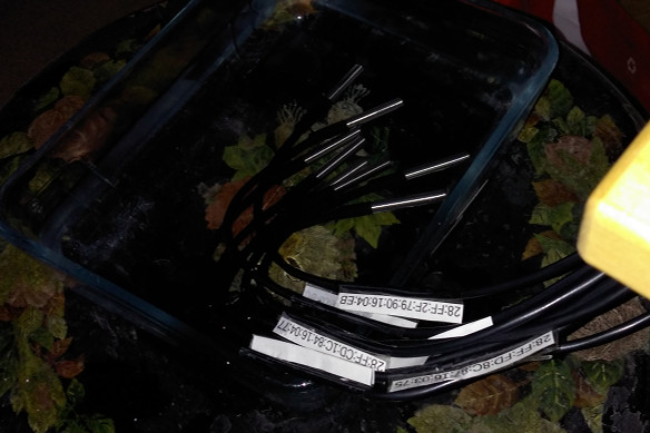

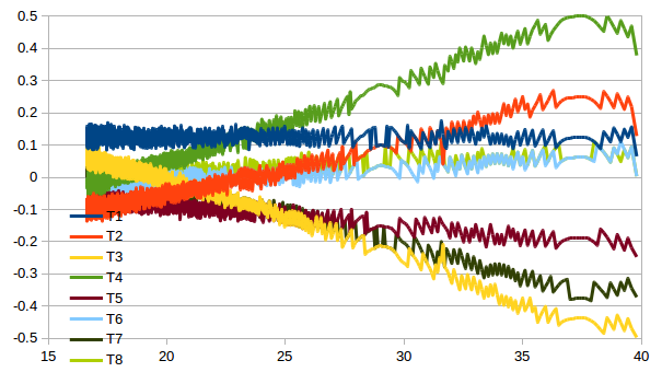

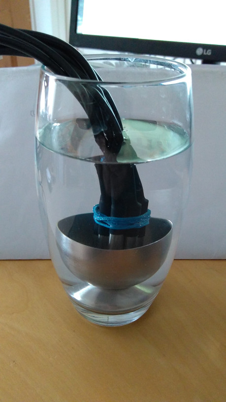

TerryE Posted March 23, 2017 Share Posted March 23, 2017 I am just making up my remote sensors for the new house and breadboarded up a 5 ds18b20 one-wire configuration. Just before I wnet off to the hospital, I dropped all waterproof sensors into a glassof hand-hot water and left them to cool. There was one bad outrider so I did an X plot of all five against the average temperature measured by the other four and got this response: I haven't given the curves here but they also show quite difference lag characteristics in responding to higher rates of change. What this tells me is that I need to batch check and calibrate my sensors before using live. They cost pin money in bulk form China, so this is probably well worth while if you want accurate readings or matched sensors. PS. I know that used the Averege, but what the hell. PPS. Another 10 on their way so I should be able to get a properly matched set out of these 1 Link to comment Share on other sites More sharing options...

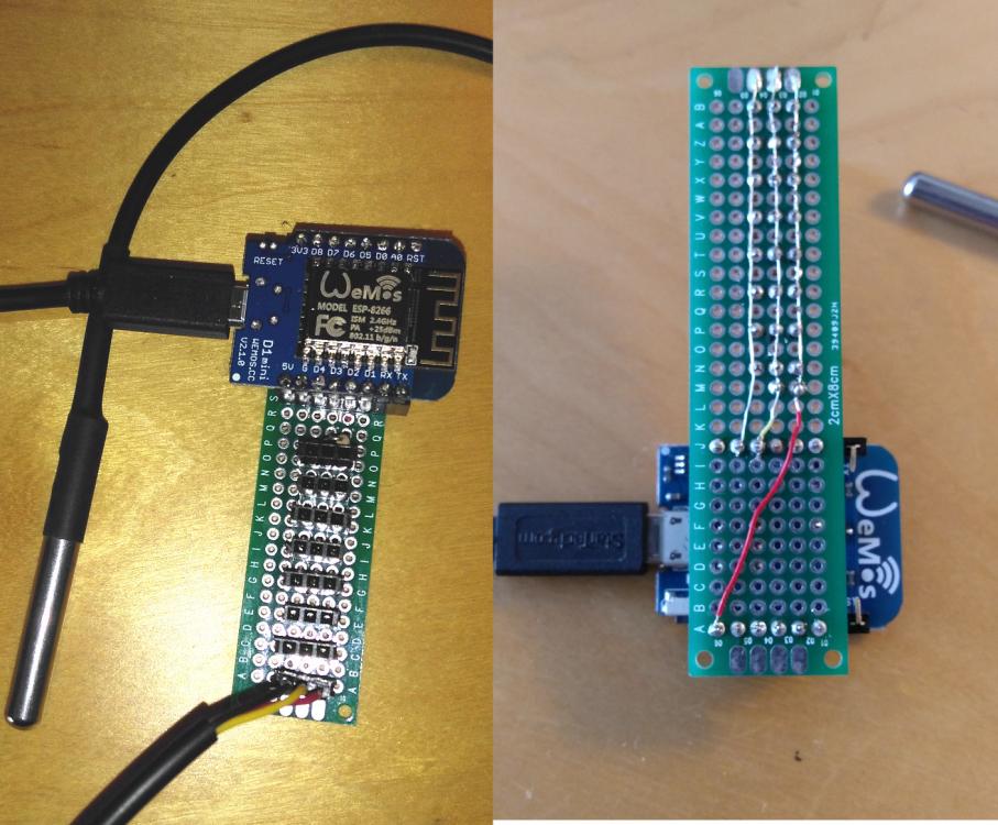

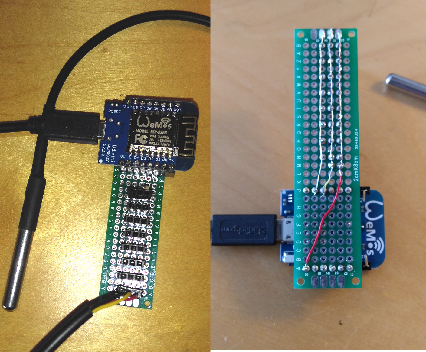

TerryE Posted March 24, 2017 Author Share Posted March 24, 2017 If anyone is interested, then I can post design and assembly details, esp8266 code or links to it, etc. 1 Link to comment Share on other sites More sharing options...

Jeremy Harris Posted March 24, 2017 Share Posted March 24, 2017 My experience is that the Chinese DS18B20 sensors have a relatively high percentage of duds, with temperature offset being the quick and dirty way to spot them. All the genuine Maxim DS18B20s that I've bought from an accredited supplier (RS Components or Farnell UK) have been far better matched, with no duds at all. Looking at the device marking, there are noticeable differences between genuine Maxim devices and the Chinese ones, and like a lot of Chinese semiconductors, I suspect they are fakes. The genuine Maxim devices are more expensive, but frankly that extra cost is trivial when you consider the time it takes to connect up and position the sensors in a house. Link to comment Share on other sites More sharing options...
TerryE Posted March 24, 2017 Author Share Posted March 24, 2017 37 minutes ago, JSHarris said: All the genuine Maxim DS18B20s that I've bought from an accredited supplier (RS Components or Farnell UK) have been far better matched, with no duds at all. I've now got 15 cheap Chinese ones. I'll buy some from Darnell and compare them in my test rig. I've been buying the waterproof ones - partly because the probe packaging with lead is far more robust. The cooling cup of water is a good way to check. 1 Link to comment Share on other sites More sharing options...
Jeremy Harris Posted March 24, 2017 Share Posted March 24, 2017 I'd be interested to see what you find. I only started testing these when I had odd readings from two sensors that were both sat on the bench. I then clamped half a dozen sensors, flat side down, to a block of aluminium and calibrated them against an NPL calibrated glass lab thermometer that was stuck in a drilling in the aluminium block, with the drilling filled with heat sink compound. What I found was that there were often temperature offsets of between +/- 0.5 deg C to a worst case of + 1.3 deg C, at around 20 deg C. In general, only around half to two thirds of the Chinese DS18B20s were inside the Maxim spec of +/- 0.5 deg C. I didn't check linearity, as I decided to just give up on the Chinese sensors and use genuine Maxim devices. The only downside with doing this was that I needed to make housings for the Maxim devices, not hard, as I found they are a nice snug fit inside a bit of 6mm OD brass tube from B&Q. With 1mm OD heatshrink on the junction with the connecting cable I found it was pretty easy to run some quick set epoxy over the DS18B20 and insert it into a short length of brass tube, sealing around the cable entry with adhesive lined heatshrink sleeving. An extra blob of epoxy in the end of the tube sealed that and made a robust sensor. With regard to the pull up resistor, I found that reducing the value this gave better results on long cables. I'd very occasionally get a single duff reading, maybe once every week or two (and the sensors are read ten times an hour) from the sensor with the longest cable run. Reducing the pull up from 4k7 to 3k3 seems to have fixed this. Link to comment Share on other sites More sharing options...

TerryE Posted March 24, 2017 Author Share Posted March 24, 2017 7 hours ago, PeterW said: @TerryE can it also log DHT22...?? The simple answer is yes, and Wemos even do a standard DHT Pro shield: . I hadn't thought of doing this, but a good option might be to put DHT22s in all of the extract ducts. The DHT22 uses the OW bus at an electrical level but the bus protocol at a S/W level is different. Specifically only one device is supported per OW bus but the Wemos board export 7 I/O pins that can be used to drive separate devices. I terms of my little setup, here is my prototype stage for the logger (total price well under £10 or £15 including half a dozen Chinese DS18B20s): Most of the smarts are on the Wemos Module so the circuit board only contains the wiring to support 8 DS18B20 headers. You just plug your USB into your PC and the DS18B20s into the headers and you are up and running. The power here comes from the USB 5V. There is standard Arduino extension to support this board, but the NodeMCU Lua package typically uses a IDE called ESPlorer, but I use a simplified approach which works for me. In dev mode every time the chip loads a new module it checks back to the mother ship over wifi and if the version is newer than the existing copy then it automatically replaces the file before loading it. This means that I don't use ESPplorer for editing or downloading source. I just do all the editing on my laptop and reset the chip if I want to download the latest copy. Link to comment Share on other sites More sharing options...

TerryE Posted March 24, 2017 Author Share Posted March 24, 2017 @PeterW, It's a standard USB virtual comm port, so any *nix / OS/X / Windows machine will do. I just plug in to my Ubuntu Laptop when developing. If you are using them for "mission critical" control in production and don't want to rely on the Wifi being up, then a good technique is to plug the device into your HA RPi3 using USB and use a simple serial protocol over the virtual comm port. USB supports up to 5m cables so this will allow you to collect data remotely up to 5m away. Further than that and you will need to depend on the WiFi being up. For non-critical logging (e.g. room temps) then you just use Wifi. Also a company called ITEAD do a range of mains pluggable switches / sensors, etc. based on this chip (its Sonoff range) so you can just buy these and replace the firmware if you want; that's what my son-in-law does in their house. Link to comment Share on other sites More sharing options...

TerryE Posted March 26, 2017 Author Share Posted March 26, 2017 @SteamyTea, try logging over a temperature glide. If you haven't got the waterproof ones then put them in a metal box on the window cill and let them slowly warm in the sunshine. Or in a poly bag in water starting hotter or colder than room temperature. Then you can do the same sort of analysis as my first post. You don't need an absolute reference, just use an average, maybe excluding any obvious outriders. I've decided to source mine cheaply but use this sort of callibration technique to select matched sets. I don't need absolute accuracy, but I do need reasonably matched sets - say to 0.1° over the operating range. Link to comment Share on other sites More sharing options...
Jeremy Harris Posted March 26, 2017 Share Posted March 26, 2017 That data pretty much mirrors my experience, ST, that if you get "good" sensors then they tend to be consistently "good", but I did receive quite a lot of duff sensors, that quickly showed as being duff by having an excessive temperature offset (greater than +/- 0.5 deg C). I think I used two or three different suppliers from ebay, initially, and I didn't keep a record of which devices came from each supplier. It may well be that all my duff ones came from a single rogue supplier, as that would tally with the percentage of duff ones I had. I can say that the genuine Maxim ones look markedly different from the ones I bought on ebay, with clearer part markings that are in a different font. I'm pretty sure that DS18B20s are being manufactured in quantity by one or more Chinese counterfeiting outfits, simply because I've seen exactly the same thing with power MOSFETs, and the volume of the market for DS18B20s is very large. Like all things, some of the fakes may well be as good as the genuine chips, it's just a bit of a lottery knowing who are the reliable sellers. When I had problems with fake IRFB4110 MOSFETs, I found that the easily tested specs were fine, although the on resistance was at the upper end of the spec. The part markings were definitely fake, as they showed the parts as having been made at an IR fab plant that had never produced this range of devices. I built a brushless motor controller with them and immediately had big explosions, with the FETs letting out loads of magic smoke. It turned out that the fakes had no where near the dV/dT capability of the genuine devices, so failed dramatically when switching a few tens of amps at around 80 V in a uS or two. When rebuilt with genuine IR devices (which were about four times more expensive) the controller worked fine (still does, several years later). FWIW, there are a lot of fake SSRs around, too. I got caught when I bought what were marked as Crydom SSRs, but when they arrived they felt very light when compared to another Crydom that was the same model. I decided to sacrifice one and ripped it apart, only to find that it wasn't potted internally, had inadequate isolation between the LV side and the ELV side and also had very poor thermal coupling between the internal triac and the metal back plate. Clearly this were fakes being sold by a Chinese seller on ebay, described and marked as if they were a well-known and trusted brand name. In the end I bought a job lot of new and genuine Crydom SSRs from a UK seller, that were guaranteed to be genuine devices, and they've been fine. Given the safety risks associated with stuff that's switching 230 VAC and supposedly has an isolated ELV DC control signal, I'd urge a bit of caution when buying these things. Link to comment Share on other sites More sharing options...

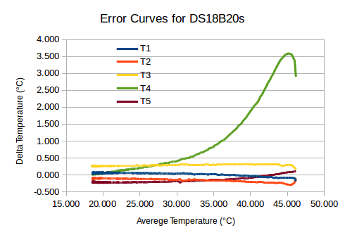

TerryE Posted March 29, 2017 Author Share Posted March 29, 2017 I've plugged 8 of my my batch of waterproof DS118B20s into my prototype rig and did a quick temperature ramp on them, by filling a glass dish with hand-hot and dropping them in, then stirring and dribbling in cold water to gradually cool the solution down (note that I've labelled each DS18B20 with its PW address): The error range was a lot less this batch: ±0.3%, but it wasn't at all clear to me how much of this was due to inhomogeneities in the liquid temperature and the positioning of the cans relative to the cooler glass surfaces, etc. So I had a brood and decided to bundle the probes with an elastic band around the sleeve part to the cans were still separated by water and then stood them in a metal egg cup in the centre of a glass again holding water at an initial ~40°C and left them to cool overnight logging the temperatures every 10 mins. I then pulled the data into a spreadsheet, so here is also the error vs. average XY plots for all 8 thermo's: What I'll do before heading off to bed is to leave 8 of the devices in a hot glass of water and let this cool naturally overnight and then repeat tomorrow. This should give me two reasonably homogeneous and steady glides to calibrate the thermometers What is clear here is that the thermometers give stable and self-consistent readings over the temperature range that I am using these for. They are consistent to within ¼°C of the average over this range, and once corrected by a linear regression derived from this calibration data, then they will be accurate within the least significant bit of their sampling resolution. As I said, I am less concerned about absolute accuracy so long as the thermometers are mutually consistent. IMO, there is little point in paying a 200% plus premium for Maxim parts from a main UK distributor or doing any waterproofing given that these 10 Pcs 1M DS18B20 Temperature Temp Sensor Thermal Thermometer Waterproof Control cost £1.30 ea. I will do the second batch tonight. Link to comment Share on other sites More sharing options...
SteamyTea Posted March 29, 2017 Share Posted March 29, 2017 Can't open the link Link to comment Share on other sites More sharing options...
TerryE Posted March 29, 2017 Author Share Posted March 29, 2017 17 minutes ago, SteamyTea said: Can't open the link Sorry, fixed. Link to comment Share on other sites More sharing options...
