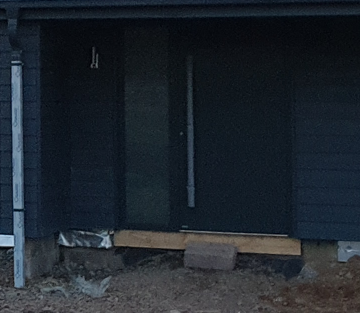

Last night I went to check on the house and discovered that the builder had removed a plank from the door threshold that you can see in the pic. This seems to have been hiding a bit of an issue.
It looks like the RK door frame is sitting in front of the base blockwork with nothing supporting it underneath. There is just a single bracket which looks like a temporary bodge to stop the bottom of the frame flexing.
It looks like the intent is for the slabs to go under there which would mean no external insulation. I'm waiting to hear from the contractor but this really looks to me like the door needs moved back. In the drawings the size from the inside face of the door frame to the plasterboard return should be 120mm it's actually 200.
Any thoughts?

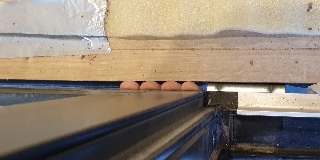

It is quite hard to see what is going on.  The door needs to sit on something solid.  The sill on ours bridges between the outside brickwork and the inside screed and there is 25mm Celotex upstand between.
Posted

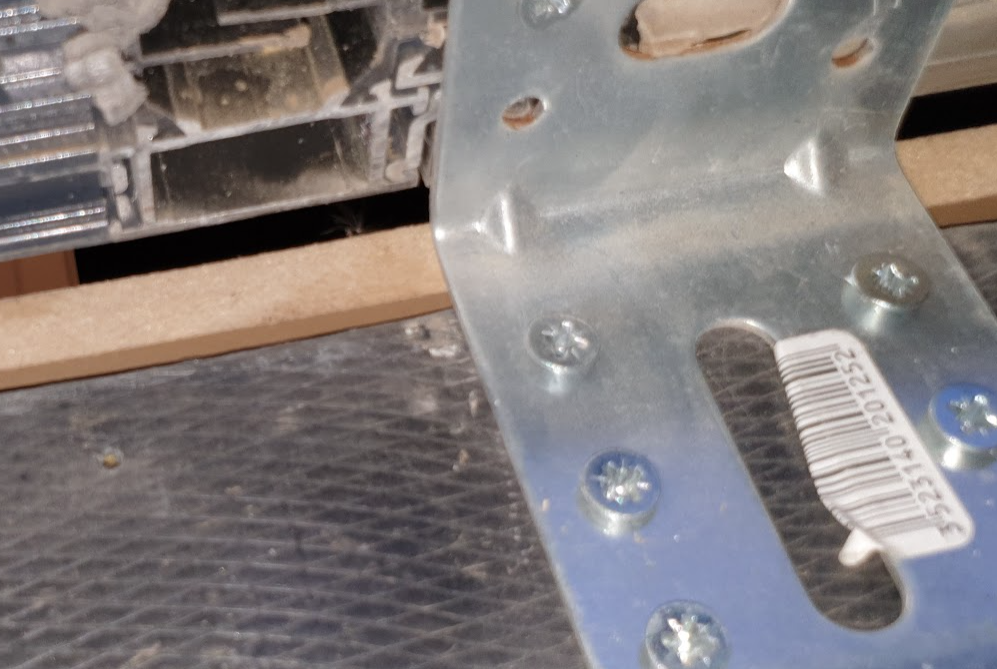

Yeah I could not get very good pictures. Essentially, instead of sitting on blockwork / internal slab the door set is forward of the blockwork, so the threshold is not sitting on anything but the single bracket you can see in the picture.
It's an RK flush door, I'm not sure if that makes any difference but I'm trying to find some detail drawings from RK to see what they think  it should look like.
Posted

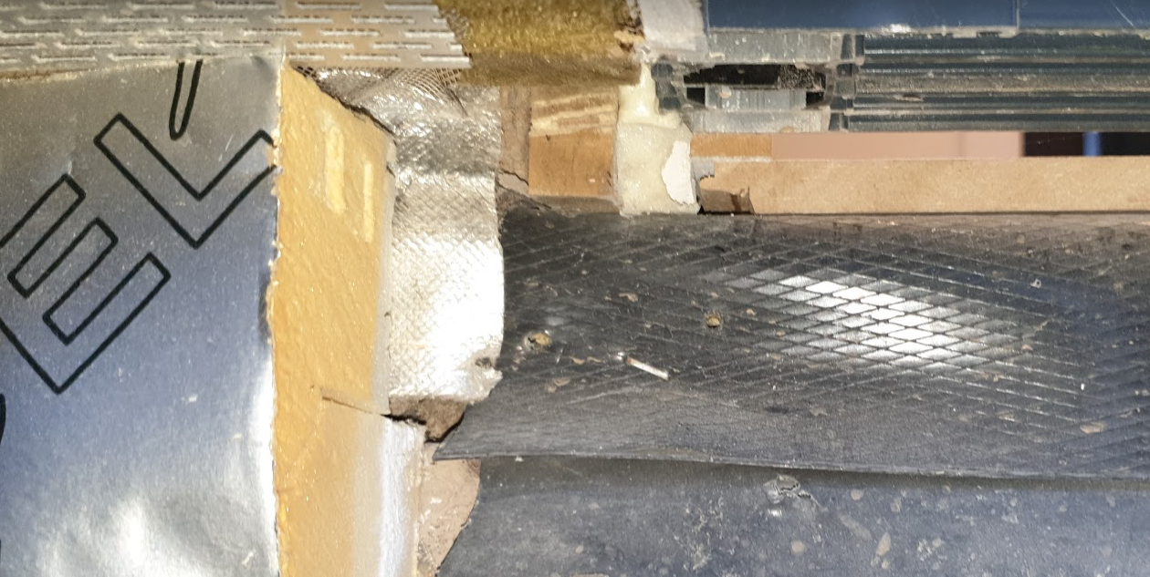

The front door is a flush fitting RK door while the others are Rationel. The RK is thinner than the Rationels. So to keep the external return from the edge of the cladding to the face of the door the same on all the doors they have moved the RK door forward. This means that it's in front of the blockwork.
They are proposing putting brackets all the way along the bottom covered by a thinner external PIR than the rest of the blockwork, leaving about 35mm for the external slabs to tuck under the door frame.
I'm really not sure about this.
Posted
Problem with just brackets and no other support. Is the threshold will flex.
It should have a solid base but when that’s not possible, then the brackets are the only option. Doesn’t matter whose door it is, it’s the same principle for all. However, I’d be looking to introduced additional brackets and what other support could be introduced.
What they appear to be proposing sounds fine but you have to question the detail in the first instance.

Cheers. More substantial support is going in plus solid base up to the PIR so it should be supported. I can't face ripping it out and moving it back.

I have an rk door and did indeed give a brick solid support under it . Must admit I’d be unhappy about brackets under it - I think our door weighed in at 150kg + . No way of getting a nice chunk of steel under there ? . Or ( maybe a stupid suggestion ) shuttering and pouring concrete to run under it ?

I think what we will do is put an angle iron all the way along the bottom with some sort of blockwork and slabs underneath. Concrete is an idea though.

If that will introduce an unwanted cold bridge then you can get GRP angles that will overcome that. Our doors and sliders are supported on them.
