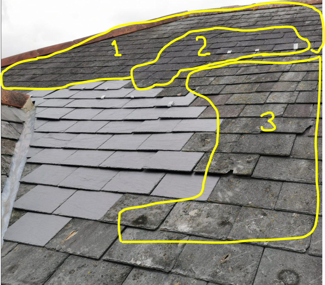

My neighbour has had a roof repair (semi house, slate roof), ignoring the fact that the contractors have damaged part of my roof in the process.
I need some guidance on this patch, alternative slate has been used which is a different colour and texture which may never fade into invisibility.
My concern is that it will forever looking awful, and an obvious repair. Am I too concerned?
The slates are lifted, giving me concern for wind lift and weather getting blown in as well as the perpendiculars now not lining up, which means the original slate has been moved.
Building control talk about 25% minimum coverage before their rules apply based on appearance but they do have a statement of "in keeping" with the original roof and "like for like", any suggestions gratefully received. My neighbour is claiming historical damage and is happy with the patch, any comments

Are we looking at your half of the roof? I don't mean to be rude, but it has to be said that it is in pretty poor condition anyway. I think the patch is the least of the problems. There are a lot of broken, cracked and clipped slates there. I couldn't say how long that can be kept watertight, but realistically, it will need re-slating in the near future. There may also be a good reason why the new slates are not sitting down properly - if the existing battens are in poor shape, for example.
It may be hard to conclude other than that the builders did the best they could with a roof that is already in poor condition. Perhaps it wasn't so much that they damaged your roof, but that any disturbance to the old and fragile slates inevitably resulted in needing to replace some of them.
As it's a semi, you will need the co-operate with your neighbour when re-slating, so making enemies of them is not recommended - ideally, you'll do it as a joint effort.

Is that your damaged roof and lead valley in the photo?  If so I would not have expected the neighbour's contractor to carry out the works to your roof without your consent.
Did they have reason to work over your side where the damage was caused ? Did they walk over it etc?
Hows the breakdown of £1900 come about ? to re-lead a valley a £1000 sounds a lot.
Yes the new tiles stand out like a sore thumb but that roof is crap anyway.

You have recourse through the legal process. First, you have to give your neighbour the chance to rectify or pay damages you find agreeable. Assuming they won't pay your £1900 quote, they either need to pay someone to rectify, or they need to take it up with whoever did the work.
You don't get to choose the contractor at this point, and if you insist on using your guy, then you'll almost certainly have to pay out of your own pocket.
If your neighbour refuses to play ball, then you'll need to go down the legal route if you don't want to pay for it yourself.
It's an unfortunate situation, and I'm gobsmacked that your neighbour would instruct repairs to your roof without your input, but you do have recourse.
Incidentally, I don't know how you think someone could do a "like-for-like" repair job on this roof. As others have said, it's on its way out - I can't think where you'd even source slates of that quality.
Also, there's already been replacement of a significant portion of the roof in the past - see sections 1 and 2 (which might all be one section - hard to be sure).
I think there is another option before recourse to law, though Jack is right that if you do go down that route, it is your neighbour that you would have to take action against, rather than the contractors. If you do this, I would guess that there is very little chance of you co-operating together when you need to replace the whole roof - or indeed any other problem with a shared interest.
Put the £1900 (regardless of who should pay that) towards the cost of a complete re-slate, at least of that side of the roof. This should be an equally shared cost, but it will solve all the problems of a mismatched patch, damage, and a roof nearing the end of its life. Perhaps more importantly, it will prevent you spending the rest of your life at daggers drawn with your neighbour, even if it does mean using some diplomacy at this stage. You may even need to swallow hard and forget whose 'fault' this is in the first place - your only aim is a satisfactory outcome, and if you both benefit from that, then that is the best out come.
If things go to law, that has the potential to work out far more expensive than a new roof, and the only real winners then will be the lawyers.

Thank you all for your replies. Jack and Stewpot, especially. Jack section 2 was the original front chimney stack that was removed, section 1 is original and section 3 has been pushed up and along by the alternative slate. The roof is 1930's but sourcing reclaimed slate around here is not hard, there's loads of slate. The valley damage was created by the downpipe bowl having too much weight put on it, splitting it (joint asset) and the bottom of the valley being stepped on causing the split to the valley. The contractors that did the repairs on the neighbours side, left slipped slates in the damaged trough from the side they were fixing and from ours. The neighbour has had contractors on the roof, joint areas, without prior notice twice and you would imagine that a decent contractor would have taken pictures of pre-existing damage to cover their liability.

No they don't.  This could be a Planning matter if the building is listed or in a Conservation Area but of no concern to Building Control.
