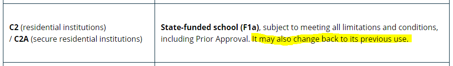

IanR Posted August 10, 2021 Share Posted August 10, 2021 40 minutes ago, Ambaz79 said: I just had a question about a building we want to convert into Flats/HMO. Currently the building is a care home and has been for 30+ years. Was it purpose built? and is it C2 Use Class? If so then I don't believe there is a way to Use C3 (or C4) Residential under PD. If it was originally C3 Residential, that was then converted to C2, it can be returned to its original lawful Use (C3 in this instance) under PD Class U. Link to comment Share on other sites More sharing options...

IanR Posted August 10, 2021 Share Posted August 10, 2021 1 hour ago, Ambaz79 said: its an old victorian house that was covered to a care home and then extended and then extended again. The last extension is purpose built "kind of" with wc and sink only and is single storey. But at some point in the early 90s it was a home for sure. I can find plenty of references to the Class C2 (care homes) returning to its previous Use within PD. For instance: Ref. https://www.planningportal.co.uk/info/200130/common_projects/9/change_of_use/2 But I can't locate the SI that includes this amendment to the 2015 General PD Order, which doesn't include this line. The Statutory Instrument will include the full text which may give a hint to how extensions added after the original Change of Use would be treated. I would guess that only the original parts of the building that once had a C3 Residential Use could be converted back to Residential under PD, and the new areas would require a Change of Use planning application. I would expect the PD on part of the building would significantly assist the planning application. And, with a planning app, you could potentially make exterior changes that the PD would not allow. Link to comment Share on other sites More sharing options...
