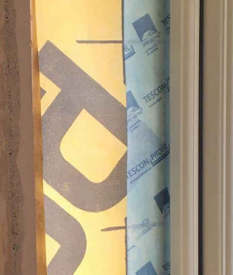

tonyshouse Posted August 6, 2021 Posted August 6, 2021 Air sealing round frames is crucial to airtightness and comfort attention to detail is crucial many new homes are colanders, very draughty and consequently don’t perform as design intended this is what I did ten years ago - still working, all wet plastered http://tonyshouse.readinguk.org/air-sealing-windows-and-doors/

MikeSharp01 Posted August 6, 2021 Posted August 6, 2021 4 minutes ago, Olf said: Well qualified Fensa registered professional installers are of the opposite opinion, even use of expanding foam was breach of their high standards in my case: What is going on here, did they manage a close air tight fit without the expanding foam and / or compriband, or is this a tongue in cheek dig at FENSA?
Olf Posted August 6, 2021 Posted August 6, 2021 The latter I'm afraid Another scam scheme like most of other self certifications, result not worth the paper issued, but not having one makes you the bad one ? I fully agree with @tonyshouse, fixing the gaps around the windows brough immediate difference, it is just bitch to do and so annoyance that it could have beed done right first time much easier. I'm also interested how is it performing now, espcially the caulk used as sealant? I used modern materials to fix, though their much dearer:
tonyshouse Posted August 6, 2021 Author Posted August 6, 2021 I do have some shrinkage of wood and wood based windowboards but no draughts emanate from the gaps. The house does seem less airtight than when I built it, but that could equally be old age creeping on at me. can’t raise the enthusiasm to do another air test. I did seal several leaks early on where I realised things weren’t quite done right so I may even be tighter. windows are brilliant, as day one, front door not so good but I made it . no evidence of sealants failing and no draughts round or through windows
joe90 Posted August 6, 2021 Posted August 6, 2021 My builder plastered up to the wooden frames, I told him to use a stop bead so I could caulk that (and stay flexible) but he convinced me it was not necessary. Well I was right, wooden windows shrank a little and the air test showed some leaks. My builder was very good but on this subject I was right. The cracking also pulled the edge of the plasterboard apart a little, even Jeremy Harris suffered the same. 1
