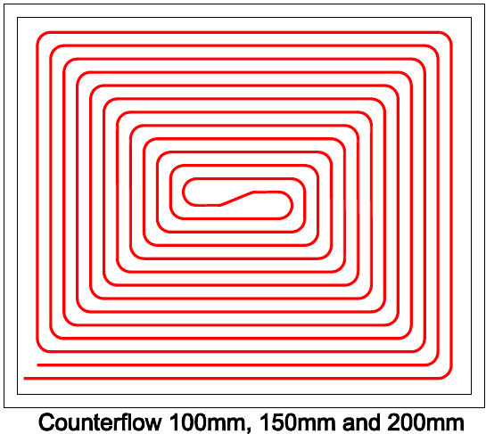

MortarThePoint Posted August 6, 2021 Posted August 6, 2021 (edited) As we are using 150mm pipe spacing (ASHP) most rooms end up as two loops. Typically theses are laid at right angles to the wall with a window. Serpentine pattern. How should the two loops have their flow and return chosen. Options: 1. Both loops flow to middle of room, return from edge of room. Cosiest in middle of room, but does it concentrate too much heat there? 2. Both loops flow to outside of room 3. Keep same flow direction, one loop flows to outside first, second to middle first. I think I've seen this in some Google search results. 4. Doesn't matter a jot About to cut my loops onto the manifold so want to get it right. Edited August 6, 2021 by MortarThePoint
MortarThePoint Posted August 6, 2021 Author Posted August 6, 2021 According to NHBC it's linear pattern not serpentine. Anyway, one continuous meandering from one side of an area to the other.
Temp Posted August 6, 2021 Posted August 6, 2021 Think ours are like this.In theory whole floor is same temperature..
MortarThePoint Posted August 6, 2021 Author Posted August 6, 2021 2 hours ago, Temp said: Think ours are like this.In theory whole floor is same temperature.. What NHBC call Serpentine achieves the same by meandering out at twice the spacing and the returning in the gap left.
RHayes Posted August 11, 2021 Posted August 11, 2021 If it's not too late I'd go for your option 2, both loops to outside, as that is where the heat is lost. Better still is to run the pipework parallel to the windows and starting with flows to outside or at least flow to the window first, as this is likely to be the highest heat loss area of the room. Hope my recomendations is not too late for you to install in this way. 1
Adsibob Posted October 3, 2021 Posted October 3, 2021 (edited) On 06/08/2021 at 12:50, MortarThePoint said: What NHBC call Serpentine achieves the same by meandering out at twice the spacing and the returning in the gap left. Like one of the three options described in the attached. Reading the NHBC guidance I see that there does not appear to be a right and a wrong way of doing this. It simply says: "Underfloor heating pipework loops can be laid out in several patterns, depending on the fixing methods and shape of the room. The most appropriate layout for a particular application should be confirmed by the system manufacturer." layouts.pdf Edited October 3, 2021 by Adsibob
