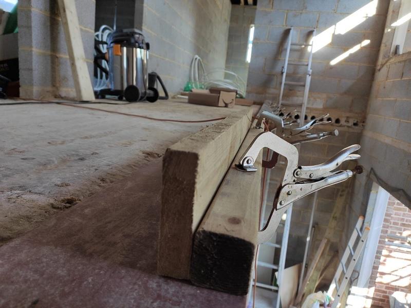

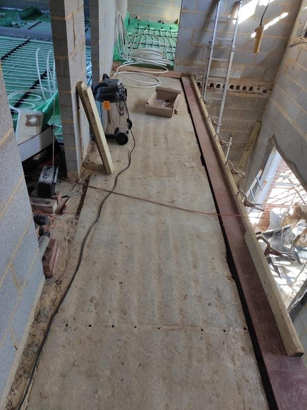

MortarThePoint Posted August 5, 2021 Posted August 5, 2021 (edited) I have a first floor landing next to a void down to the ground floor. Along the edge of the landing is a steel beam and the majority of the landing itself is Hollowcore slab. I am preparing for this area to be screeded, so need to put in a dam to stop screed waterfalling over the edge. See below what I have done. It leaves me wondering about how I am going to anchor the balustrade. Having removed the timber form work I'll have a strip of the beam left showing around 70mm wide. I could drill holes in the steel and attach a piece of wood along the length of the beam except where the stair meets the landing. Would I need to have something fireproof between the metal beam and the piece of wood bolted to its top? Have I got my form work in the right place? Leave a wider section of beam exposed Try to minimise the section of beam exposed Looks like a good plan, crack on Speaking of cracking, the intended finish along here is carpet, but down the line I guess it could become tile so I was wanting to avoid having to fill a gap between the edge of the screed and the balustrade timber with SLC or the like as could cause cracked tiles. At the top of the stairs should I have the screed go right to the edge of the beam? Edited August 5, 2021 by MortarThePoint

MortarThePoint Posted August 5, 2021 Author Posted August 5, 2021 (edited) 42 minutes ago, Russell griffiths said: Are you going to bridge the gap between steel and concrete with some form of mesh, I have used chicken wire in the past or a fine stainless mesh embedded in the screed. I'm only asking the ~40mm screed to bridge a gap of around 20mm so it should be stiff enough for that even without reinforcement. Looks wider in some places do to vertical difference. If there is differential movement between the beam and the hollowcore, then even reinforced I'd expect it would crack. Edited August 5, 2021 by MortarThePoint
MortarThePoint Posted August 5, 2021 Author Posted August 5, 2021 It's looking like my best bet is to hold the screed back a bit further to allow options. I can then cast a continuation of the screed or bolt timer to the steel beam. Ideally this would all be done already and I'd just be screeding to the edge of the steel. I'll leave the screed 100mm back from the edge of the beam as I can't imagine us having posts larger than that.
MortarThePoint Posted August 5, 2021 Author Posted August 5, 2021 3 minutes ago, Nickfromwales said: Fail to prepare, prepare to fail. Mesh. If not using chicken wire, what's the best bet. Anything available from Toolstation/Screwfix?
MortarThePoint Posted August 5, 2021 Author Posted August 5, 2021 This is what it would end up looking like The gap highlighted would probably be around 5mm, but could end up being more. I'd be surprised if it's an issue for carpet or timber flooring even at 20mm. Tiles may be more of an issue, but perhaps that needs to be. @Nickfromwales and @Russell griffiths you're talking about reinforcing with mesh where I have shown the green squiggle. I can't see it cracking there unless the HCF and UC beam move differentially and if that occurs do I want the screed to fight it? It would be worse for the screed to crack somewhere else.

Nickfromwales Posted August 5, 2021 Posted August 5, 2021 Is the screed in now? If so my apologies, just foam it!! Thought this was going into the screed and was to reinforce the screed at that point so it doesn’t fracture and just float there. Grafting and typing as usual.
MortarThePoint Posted August 5, 2021 Author Posted August 5, 2021 25 minutes ago, Nickfromwales said: Is the screed in now? If so my apologies, just foam it!! Thought this was going into the screed and was to reinforce the screed at that point so it doesn’t fracture and just float there. Grafting and typing as usual. Not in yet so it's an option to reinforce if I can get some in time

Russell griffiths Posted August 5, 2021 Posted August 5, 2021 If it cracks then the bit of screed on top of the steel will just float and rattle about. I would mesh it and fix the mesh to the steel with tex screws and washers. Leaving a gap for screed to go under the mesh, so pack it up off the steel.
