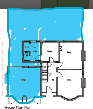

SuperPav Posted August 6, 2021 Share Posted August 6, 2021 The usual advice of get a planning consultant would apply Hard to comment on some things here with the limited information and lack of elevations. 1) What is the footprint of the original house, specifically what (if anything) can you do using PD rights. There could be some games to be played here. 2) What/if anything has your neighbour said about it - both to you directly but also as part of any comments on the planning application? Do they have any *specific* concerns? 3) What is the current boundary treatment - fence etc. 4) Appreciate those drawings may be a bit distorted, but how much are you going out rearwards as it almost looks like you're doubling the depth of the house? Your questions about how the corner window should be treated from a planning assessment are a bit irrelevant to be honest - it looks like there's more than just the corner window on their eastern elevation anyway. Link to comment Share on other sites More sharing options...
Ferdinand Posted August 6, 2021 Share Posted August 6, 2021 Welcome. I think we really need a bigger slice of the plan, showing for example the orientation in the plot, the road etc. F Link to comment Share on other sites More sharing options...
Ambaz79 Posted August 7, 2021 Author Share Posted August 7, 2021 (edited) Hello All Thank you for taking your time to look at this. I have attached as much as I think I can. I don't have any clue on how PD rights could be used and how. Maybe the info attached today could help advise on this. Before I submitted the 1st plans we had a chat with my neighbor (and emailed the original plans to him before submitting) who said he would like us to be as far as possible from his house and ideally in line with the original house so the extensions goes back but not to the west towards the boundary. As we wanted to extend towards the west we decided that I submit the plans and proceed as needed and he would comment on the application. I think this was a fair way to deal with it and I want to be clear we are not as war or anything. I guess he wants to protect what he can and I want to extend to what I have planned and create my dream home. He has made a comment on the first application to say the extension to the west would be too dominant and overbearing. Then on the second application he commented and referred to the 1st refusal notice where reason 2 of the refusal notice was the building would have a overbearing impact on the neighboring amenities. Current boundary between the 2 houses is a standard fence panels that is around 6ft high. One point to note is the road is on a slope so his property is built over a 30cm higher than ours so he has high ground compared to us. There is on one of the images attached the orientation of the plot so you can see the rear is south facing. Also something to note is my next door neighbor on the other side has just had planning accepted last year to demolish his house and build a brand new building there. I don't know if this has any impact on the other side. We are extending around 7M back at a height of around 5.2M. The extension overall would more than double the size of the existing house. Our house currently is by far the smallest house on the street. Again thanks for all your advice on this. Edited August 7, 2021 by Ambaz79 1 Link to comment Share on other sites More sharing options...

SuperPav Posted August 9, 2021 Share Posted August 9, 2021 I've had a look at this including the houses either side and the planning history, and as some informal feedback my thoughts below: Both comments by the neighbours are reasonable. The fact that the last application was also rejected on overbearingness (rightly or wrongly) means you're off to a bad start in terms of getting your proposal through as is. The fact your house currently sits so near to #16, with a tapering/diagonal plot is always going to require some compromise as you extend rearwards. Some of the proposed works seem somewhat inefficient from a cost/work vs value point of view - is the garage wall to #16 really moving by about 500mm? Where do all of your services currently run? If it were me, I'd be tempted to lose the garage in its current location, put a second bay to match your current one to that side, over the existing footprint, then extend rearwards in the current width, perhaps by more than you have currently (8-9m?), and then bung an attached garage on the side facing #20. Even if you had a double length garage here, it would only be a single storey side extension to #20 which is a material improvement over the last application. I would also advise you to keep the garage wall to #16 in its current position - putting foundations right up against current ones right on the boundary (+ ripping out the old ones for the new floor), + limited access for building and maintenance is going to be a real pain. Worse so if there are any services or even rainwater drainage running along this wall. Apologies for the MS paint quality of drawing, not on the good computer at the moment! Link to comment Share on other sites More sharing options...
