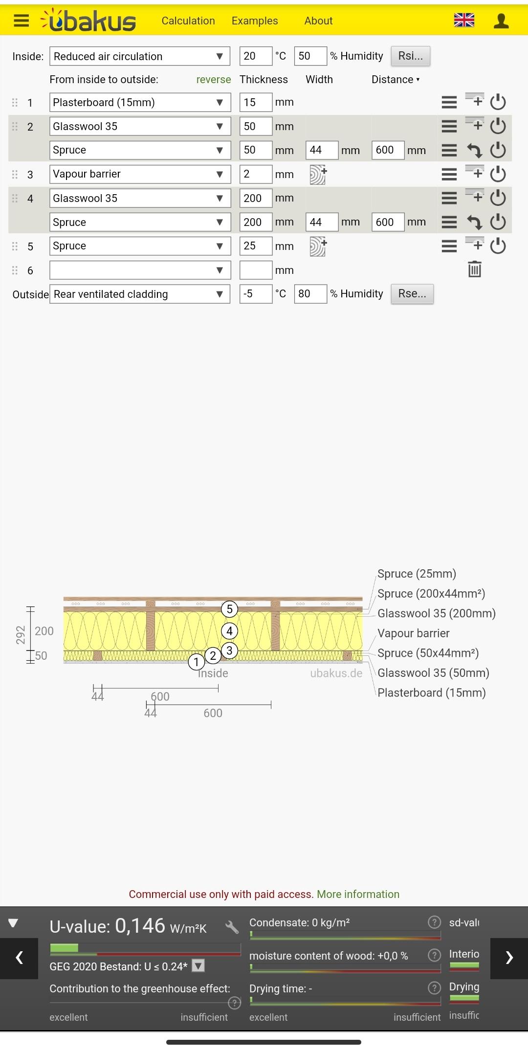

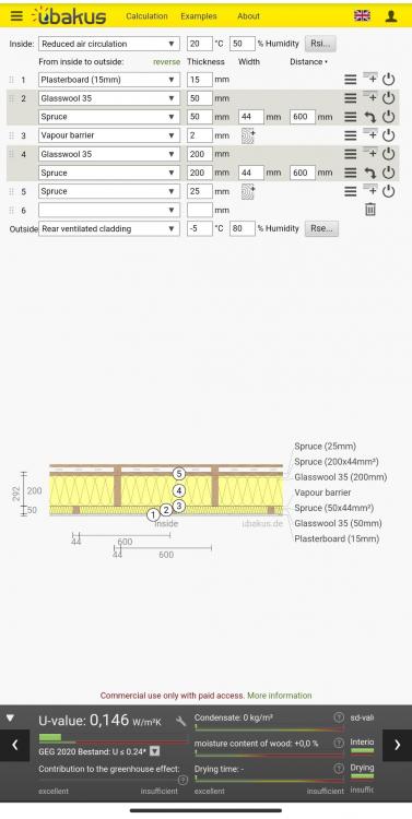

Evs Posted August 8, 2021 Author Share Posted August 8, 2021 (edited) On 02/08/2021 at 23:15, Iceverge said: Vapour membrane is vital for airtightness and to prevent condensation on your rafters causing the rafters to rot. PIR in the roof is a bad plan for loads of reasons. Torturous to install. Expensive. Bad decrement delay leading to overheating. Shrinkage of timbers and PIR causes drafts around the insulation making it underperform severely. I have attached probably one of the cheapest options. No PIR. Better still if you can replace the glasswool between reg joists with blown densepack cellulose. Supplier installed. Excellent for decrement delay, airtightness, toxicity, environmental credentials the list goes on. I’ve only only seen this reply somehow. Thank you for taking the time to do this. I’m still not sure whether I can fully insulate the trusses with 200mm of glasswool or I have to leave the 50mm air gap. Edited August 8, 2021 by Evs Link to comment Share on other sites More sharing options...

Iceverge Posted August 22, 2021 Share Posted August 22, 2021 On 08/08/2021 at 22:36, Evs said: I’ve only only seen this reply somehow. Thank you for taking the time to do this. I’m still not sure whether I can fully insulate the trusses with 200mm of glasswool or I have to leave the 50mm air gap. Full fill between the rafters membrane batten 25mm counter batten 25mm for 50mm ventilation above the rafters. tiles. Link to comment Share on other sites More sharing options...
