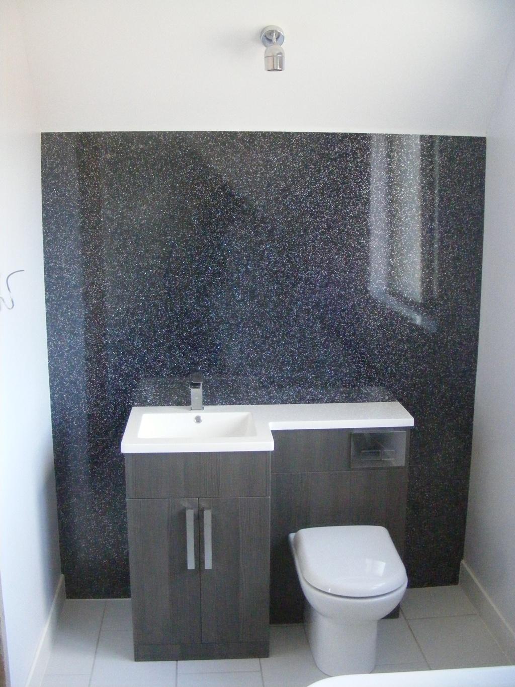

ProDave Posted July 29, 2021 Share Posted July 29, 2021 I did one of ours horizontally, but a completely different situation: In this case the wall ends low due to being room in roof, and there was less than 1200mm between the top of the basin and where the wall becomes sloping ceiling. So putting it on it's side avoided a vertical joint, and there are 2 invisible horizontal joints either side of the vanity unit. Link to comment Share on other sites More sharing options...
