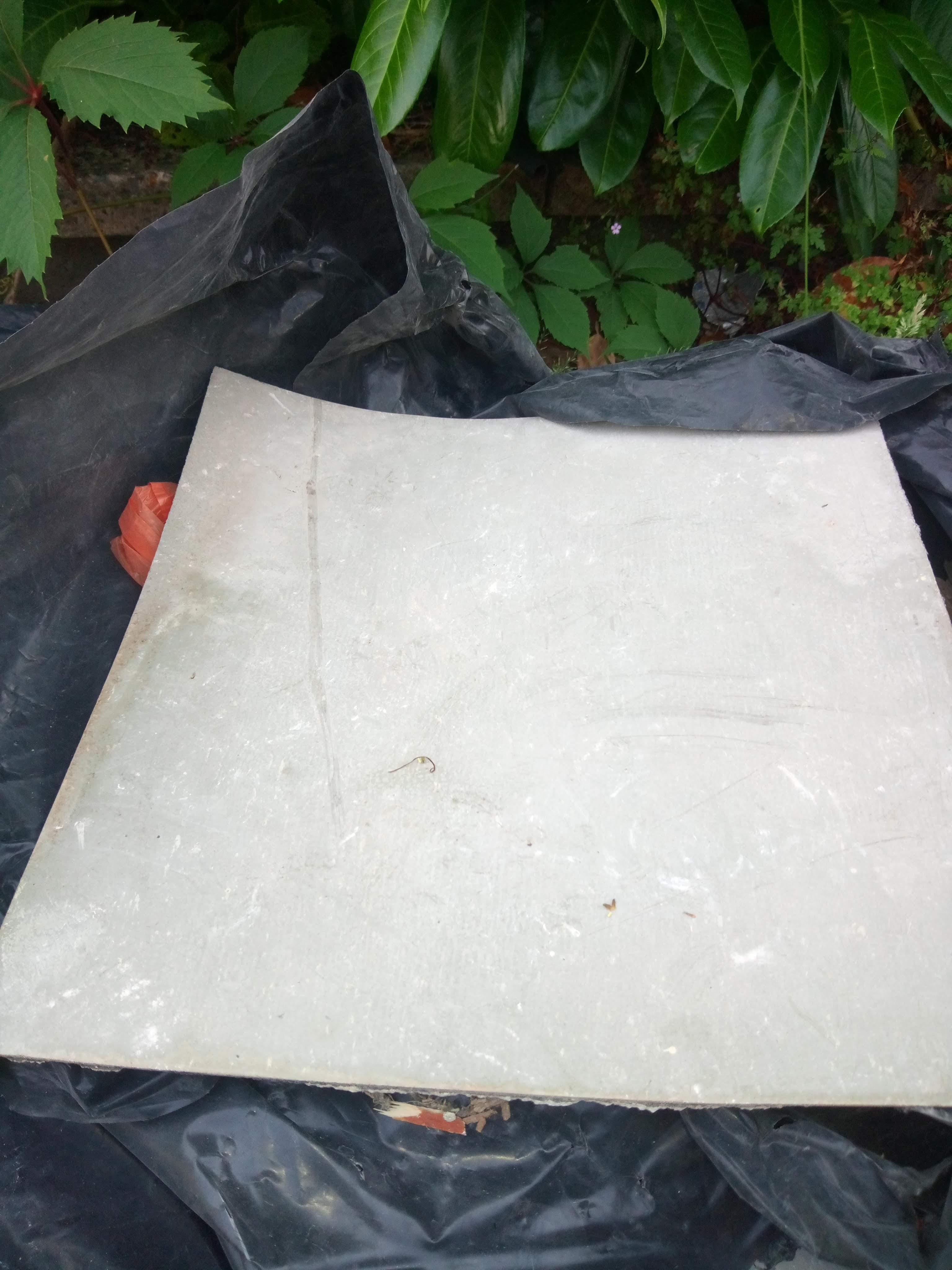

Loz Posted July 20, 2021 Posted July 20, 2021 Hi, Wasn't sure which forum to best post this in, just in middle of renovation and lifted carpet in the airing cupboard today ahead of tank being removed and new system being put in so floor boards all need lifting and discovered some thin vinyl like tiles on black type adhesive. Had a recent asbestos cement board incident and when reading about that saw some info on vinyl floor tiles, here are some images, what do people reckon - guess they could be asbestos ones - also bit worried about having lifted the carpet that hasn't been moved in years and wandering if could have released anything lying dormant in there ? They are very thin, less than 1mm, Many thanks, Lawrence

markc Posted July 20, 2021 Posted July 20, 2021 I would carefully fold up a corner to see how it breaks. I reckon you have old bitumen tiles and they are harmless. 1
saveasteading Posted July 20, 2021 Posted July 20, 2021 yes, asbestos tiles usually hard and snap, and probably would not have come off so nicely. get a test though. 1 1

James Newport Posted July 20, 2021 Posted July 20, 2021 11 minutes ago, saveasteading said: yes, asbestos tiles usually hard and snap, and probably would not have come off so nicely. get a test though. The tiles I found in my kitchen that definitely contained asbestos came up incredibly nicely! 1

James Newport Posted July 20, 2021 Posted July 20, 2021 9 minutes ago, Loz said: Thanks for all quick replies, looks like the tiles are still there, they are very thin or could be just the remnants after tile been removed and somehow left the coloring as they are wafer thin Google for Marley floor tiles, that's what people seem to call old floor tiles that contained asbestos. I've attached a picture of one from my kitchen. They look nothing like your tiles. But I have no idea what your tiles might be. 1
saveasteading Posted July 20, 2021 Posted July 20, 2021 Have had asbestos tiles in demo/refurbs. They have never bent like that photo. Always came off clean or snapped. So first check them out. If asbestos reinforced then I think they are low risk, and I don't think need any special training, but you do not want dust. Plenty of people have been unaffected but plenty have suffered. There will be a leaflet online from HSE saying something like: wet the area, wear disposable gloves and mask. then do the double bagging thing. If you are not a business, then you can take them to the municipal tip and hand it over for safe disposal (all contaminated stuff seems to go to Peterborough) 1 1
Loz Posted July 21, 2021 Author Posted July 21, 2021 Hi, Thanks for everyone who took time to reply, broke some pieces off with a wall paper scraper as advised by testing company and had them tested this morning (£48 for same day) and the mastic/adhesive was clear but the tiles contained chrysolite asbestos, the company seemed pretty relaxed about it whereas I was concerned had released fibres breaking the tile to get samples (I was in proper mask and gloves) - they said almost impossible to release the fibres from breaking them as so well bonded (unlike cement board where apparently more easily released) and this was backed up by removal company that spoke to who just said stick mask on and pull them up (going to chop the floorboards and lift them that way) and don't worry if break. What is weird if you go online there everything points to breaking them releasing fibres, no idea who is right, asked if should get air reassurance test done and they said would be waste of money. So guess what is done is done and will wipe area down and get on with rest of renovation and hope more doesn't show up anywhere unexpected. Lawrence 1

saveasteading Posted July 21, 2021 Posted July 21, 2021 (edited) worry not. the HSE say this 71 In certain types of ACM, the asbestos fibres will usually be firmly linked in a matrix and will not be released easily. This includes: ■ asbestos cement, (unless it is substantially fragmented, crushed, or otherwise significantly damaged); ■ textured decorative coatings; ■ paints with asbestos, any article of bitumen, plastic, resin or rubber which contains asbestos where its thermal or acoustic properties are incidental to its main purpose, such as vinyl floor tiles, electric cables and roofing felt. it is not licensable. you have spoken to experts who have told you not to worry. https://www.hse.gov.uk/pubns/guidance/a23.pdf I assure you that most 'specialists' will not go to quite these lengths unless in an occupied building. Edited July 21, 2021 by saveasteading added reference 1
