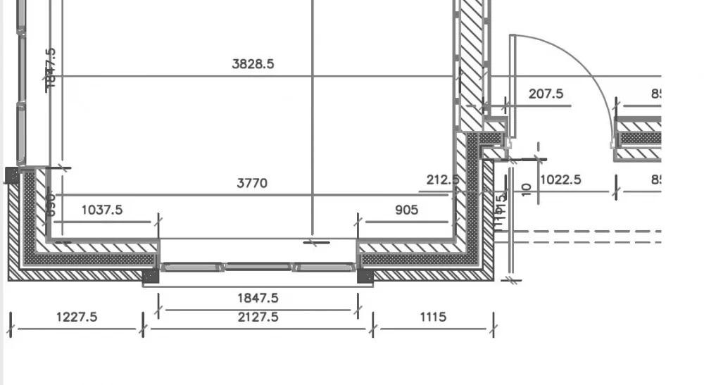

Seeoda Posted July 17, 2021 Share Posted July 17, 2021 I have a semi-D with relatively good soundproofing between my side and the neighbours. The wall build-up is block-on-flat, sand and cement on both sides and then steel hat channel and drywall on both sides. Mostly the party wall provides adequate soundproofing. Conversations and telly are not heard, however, some sounds do get through, such as the neighbour's front door shutting and stairs. See pic of their front door. It is a structure borne noise and I know these are hard to reduce. Given this unwanted noise is actually not loud, is there any hope to reduce it? Assuming there are no gaps in the cement coat, I am wondering could the drywall cavity on both sides be creating a 'triple leaf effect'? One person advised me that removing the drywall and wet plaster or to use drywall with fibreglass attached that is not touching the block wall. Would this make a difference? The triple leaf effect is something a lot of guides don't mention. The house is three floors and really like a slice of the cake, cut from a cake, the rest of the terrace, given how tall, wide but shallow this house is. I think this shape might worsen the noise pollution transfer the house is acting like one large speaker. Smaller the air gap, the more the higher frequencies can resonance right? I am also looking into convincing the neighbours to install some kind of rubber cushion on their front door but I do not what product to use. Link to comment Share on other sites More sharing options...
saveasteading Posted July 17, 2021 Share Posted July 17, 2021 Never heard of the triple leaf effect. More layers and more density will reduce air-borne sound, not amplify it. Impact sound will come through because there is contact all the way. To reduce airborne sound you need something separate from the solid wall, so changing to a dab connection is little benefit. Any introduction of fibreglass between the leaves will help, but noise will still come through the connections. Also there is flanking sound, where a surprising amount comes through the weakest point, such as cracks or joints at corners. What is the floor made of? If concrete in a single slab, then the noise can reverberate from one house to the next. For a much better sound barrier add another skin of wall, using studs that span floor to floor, and that don't touch the party wall. Fill with acoustic mineral wool, plasterboard and finish. You have now lost 80 to 100mm of floor space. The best improvement I have known was by fitting a special acoustic barrier of pvc sheet, containing lead, hung loose down the 9 inch solid party wal, then stud and board. It resulted in not being able to ever hear babies or tv through the wall either direction. It was experimental and would be v expensive, and I don't know if it is available. It shows what can be achieved if it matters enough. British Gypsum and Knauf have info on the noise reductions theoretically available, but an acoustics guy told me that the life levels are never as good as the lab figures.. Please note that you could do lots to the wall, only to have the noise come through the ceiling, or side walls....it depends so much on the construction. 1 Link to comment Share on other sites More sharing options...
Mr Punter Posted July 17, 2021 Share Posted July 17, 2021 (edited) The inner leaf masonry where the door is connected runs into your house with no breaks. That explains the front door noise. The top hat should be resilient bar. The stair may be fixed to the masonry. Edited July 17, 2021 by Mr Punter 1 Link to comment Share on other sites More sharing options...
