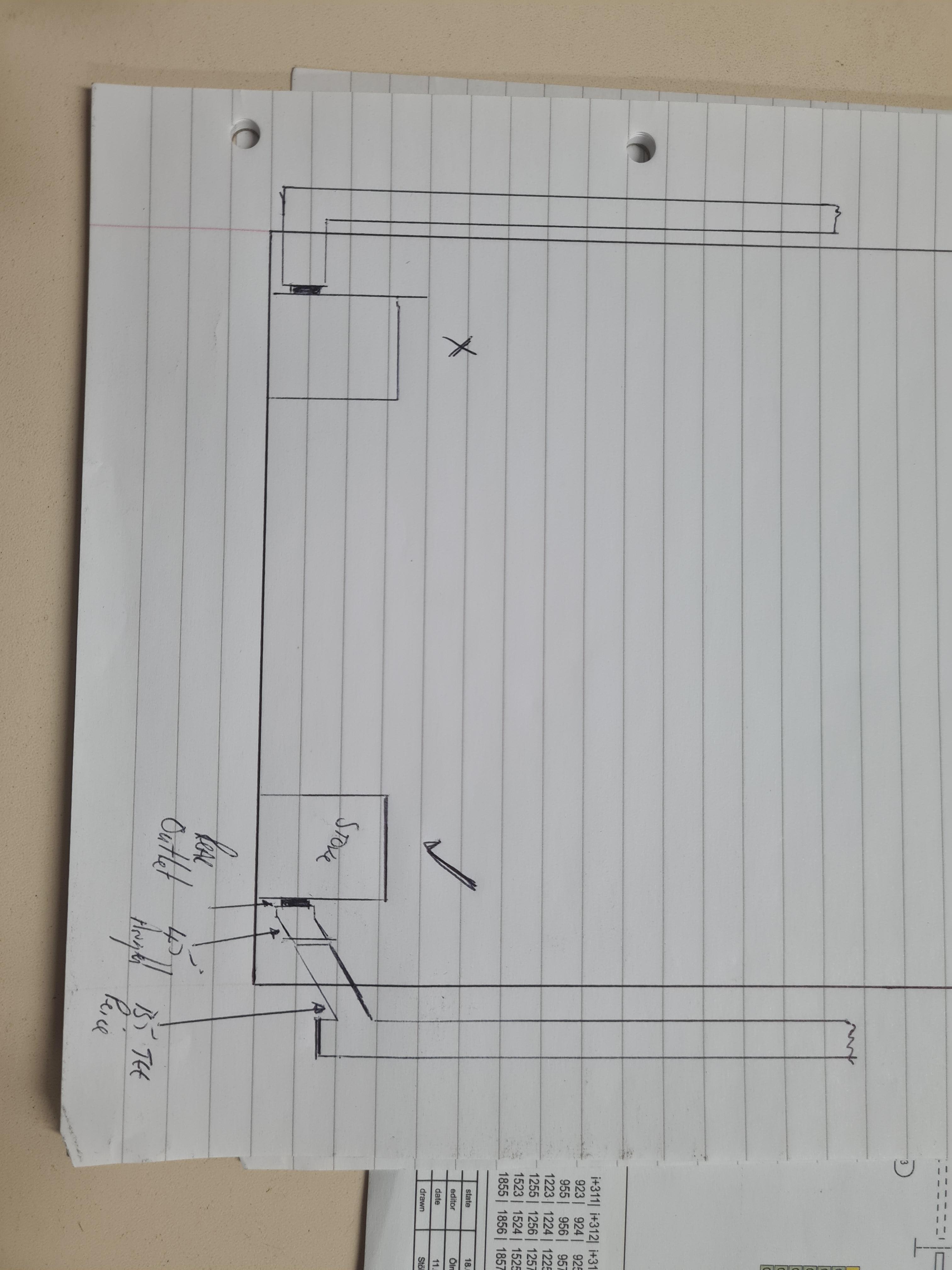

JEG8 Posted July 14, 2021 Share Posted July 14, 2021 Hello, I am looking to install a 5kW stove (Purefire Curve), with the intial plan to use the top outlet for the flue. Plans may now be changing and we are possibly using the rear outlet. Instead of a 90' I would like to use a 45' coupled to a 135'Tee through the wall. (I will be using Twin wall right from the stove.) In theory, I cannot see any issues and would like to think that the BC wouldn't have a problem signing it off, but, has anybody had any issue using this kind of setup or done something similar? Cheers James Link to comment Share on other sites More sharing options...

Cpd Posted July 14, 2021 Share Posted July 14, 2021 Not sure I follow, can you draw a picture. Are you using the tee as a way of cleaning the flue ? Link to comment Share on other sites More sharing options...
JEG8 Posted July 14, 2021 Author Share Posted July 14, 2021 Only one appliance feeding out of the rear outlet. With regard to the 45 out of the back coupled to a 135 Tee (Through the wall) with drain/ removable cap - This would be to allow good access for cleaning. Link to comment Share on other sites More sharing options...
JEG8 Posted July 14, 2021 Author Share Posted July 14, 2021 Hope this makes it a little clearer. Cheers Link to comment Share on other sites More sharing options...

Cpd Posted July 14, 2021 Share Posted July 14, 2021 Not an expert on the regs but I would say that’s a really good set up as it makes cleaning really easy. 1 Link to comment Share on other sites More sharing options...
PeterW Posted July 14, 2021 Share Posted July 14, 2021 Will be fine although it’s worth adding a small stub below the tee with a proper cap that allows any water to drain out. Link to comment Share on other sites More sharing options...

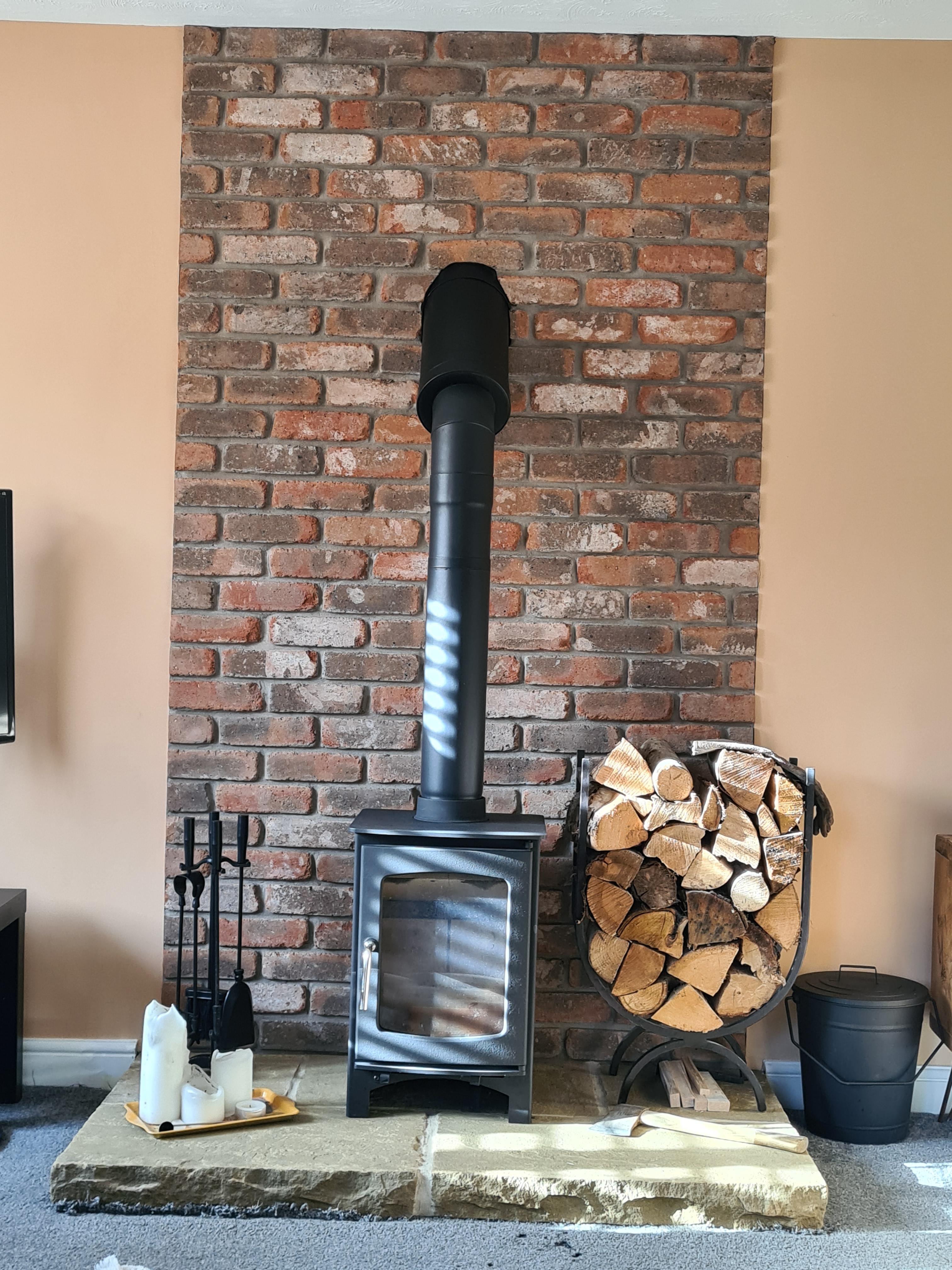

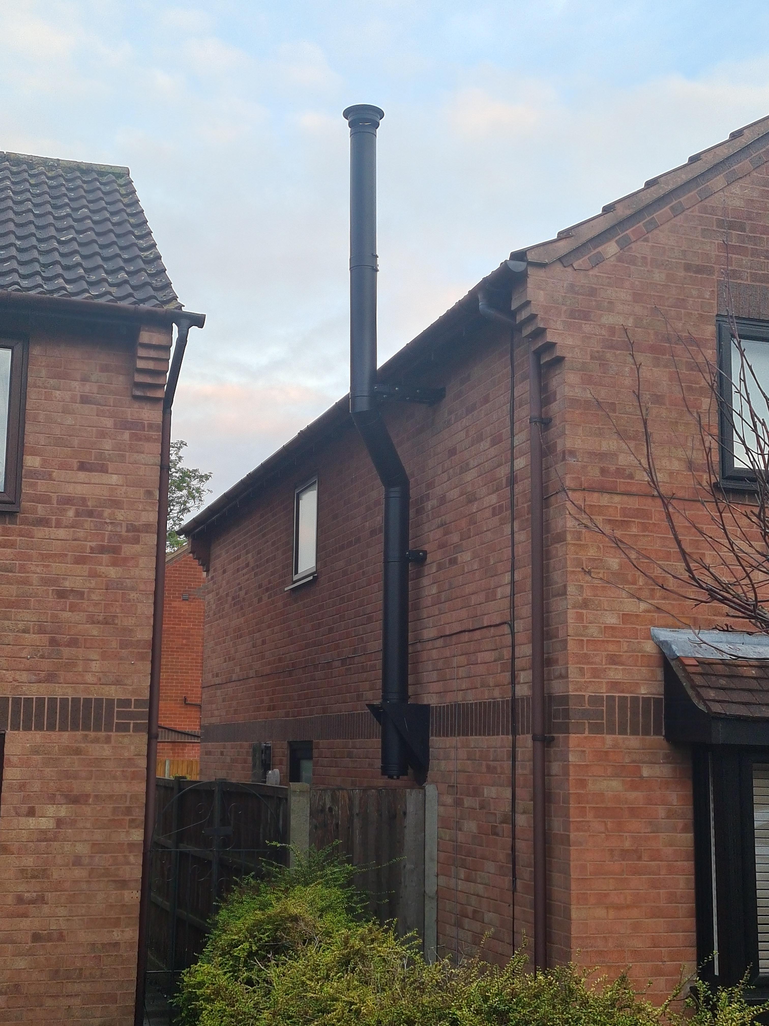

JEG8 Posted August 8, 2023 Author Share Posted August 8, 2023 Long time since I posted but, forgot to follow up with completion picks. Has been in for a couple of years now and burns a treat. Thanks for the comms on this. 1 Link to comment Share on other sites More sharing options...
