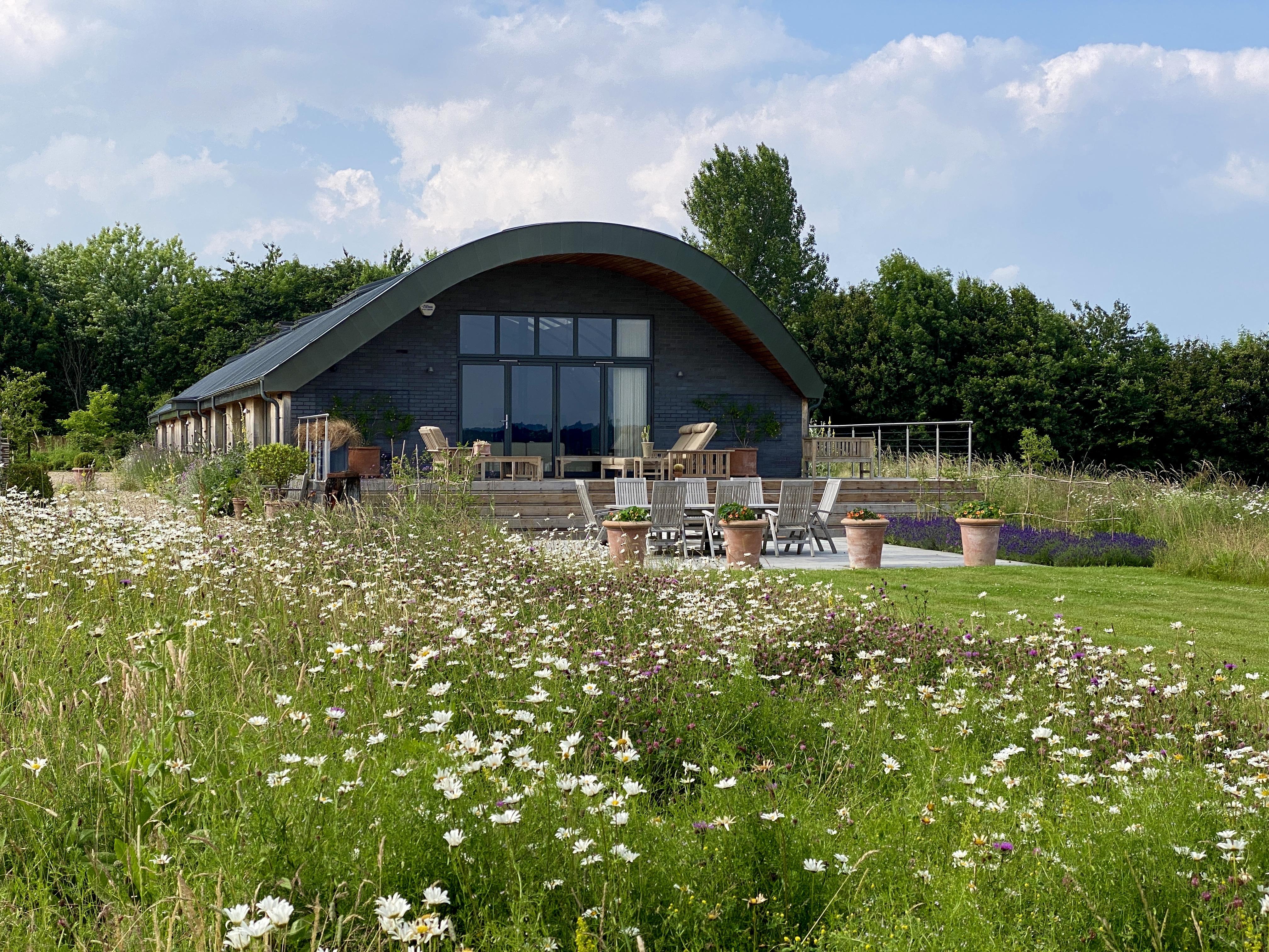

Claire B Posted July 12, 2021 Posted July 12, 2021 I've been in my nissen hut conversion 4 years now and would like to add solar panels and battery back up (thinking Tesla Powerwall) so I can be more self sufficient. I asked the farmer if I could buy some land to put the panels on (ground mounted) as my roof faces either east or west. He said he'd sell me some land (at 30k for half an acre!) but why don't I just put panels along the ridge line of the roof. My roof is curved. He said he'd found some curved panels on eBay for his shepherds hut but I'd need something more substantial here. Could anyone recommend any? The roof is zinc, would they just attach to the seams? It would be great if this could work as you wouldn't see them. The roof has Velux windows but they're on either side and there's a good 2 meters between them over the top.

Claire B Posted July 12, 2021 Author Posted July 12, 2021 On 12/07/2021 at 18:02, SteamyTea said: You would need planning permission to put more than, I think 9m² on the ground. If your roof is neither East or West facing, where does it face, downwards? You could just fit regular modules, they are a metre wide, so probably not much of a gap at either side. Expand Yes I was prepared for the planning permission if going with ground mounted. I might get away with the roof mounting without planning as long as they can't be seen. Roof faces East or west (either, not neither). Along the ridge they would be facing straight up if I put flat panels on there. I think a curve would capture more sun.

IanR Posted July 12, 2021 Posted July 12, 2021 (edited) On 12/07/2021 at 17:55, Claire B said: My roof is curved. He said he'd found some curved panels on eBay for his shepherds hut but I'd need something more substantial here. Could anyone recommend any? The roof is zinc, would they just attach to the seams? Expand On a flat standing seam roof, you can fit directly off the seam using something like: https://s-5.com/products/solar-panels-on-metal-roof-pvkit-2-0/ You could still use the S-5 clamps on your curved roof, but you need to build up a frame from them to get the panel mountings flat. https://f.hubspotusercontent00.net/hubfs/3482954/Resources/Product Documents/Clamps/S-5-E/s-5-e-clamps-brochure.pdf You tend to go "landscape" with the PV modules on standing seam (when you mount directly), so they cross at least a couple of seams, This would avoid them lifting too far away from the roof and allowing the wind to get underneath. Alternatively, how about thin flexible PV modules, bonded directly to the Zinc? To show an example (but don't know the product or company): https://www.solarshop.co.uk/flexible-solar-panel#!/Miasole-120Wp-Peel-and-Stick-Flexible-Solar-Panel-5-year-warranty/p/202039294/category=19470179 I did try to source something similar for my own roof a couple of years ago, but I could only find them on Alibaba etc. Perhaps there are other options now. If you find a solution that isn't ridiculously expensive, then please post back, I may be interested myself. Edited July 12, 2021 by IanR
Claire B Posted July 12, 2021 Author Posted July 12, 2021 On 12/07/2021 at 18:18, IanR said: On a flat standing seam roof, you can fit directly off the seam using something like: https://s-5.com/products/solar-panels-on-metal-roof-pvkit-2-0/ You could still use the S-5 clamps on your curved roof, but you need to build up a frame from them to get the panel mountings flat. https://f.hubspotusercontent00.net/hubfs/3482954/Resources/Product Documents/Clamps/S-5-E/s-5-e-clamps-brochure.pdf You tend to go "landscape" with the PV modules on standing seam (when you mount directly), so they cross at least a couple of seams, This would avoid them lifting too far away from the roof and allowing the wind to get underneath. Alternatively, how about thin flexible PV modules, bonded directly to the Zinc? To show an example (but don't know the product or company): https://www.solarshop.co.uk/flexible-solar-panel#!/Miasole-120Wp-Peel-and-Stick-Flexible-Solar-Panel-5-year-warranty/p/202039294/category=19470179 I did try to source something similar for my own roof a couple of years ago, but I could only find them on Alibaba etc. Perhaps there are other options now. If you find a solution that isn't ridiculously expensive, then please post back, I may be interested myself. Expand Thanks Ian, Those flexible 'stick on' panels would be great if they'd work, your link shows them on a curved roof like mine. Just need to find a supplier and fitter. This is what the farmer used on his shepherds hut. The site is very exposed and we get much more wind here then our neighbours tucked away within the village. I'd be worried about the wind getting under the clamped on panels. I'd also need to check that wouldn't invalidate my roof warranty.
