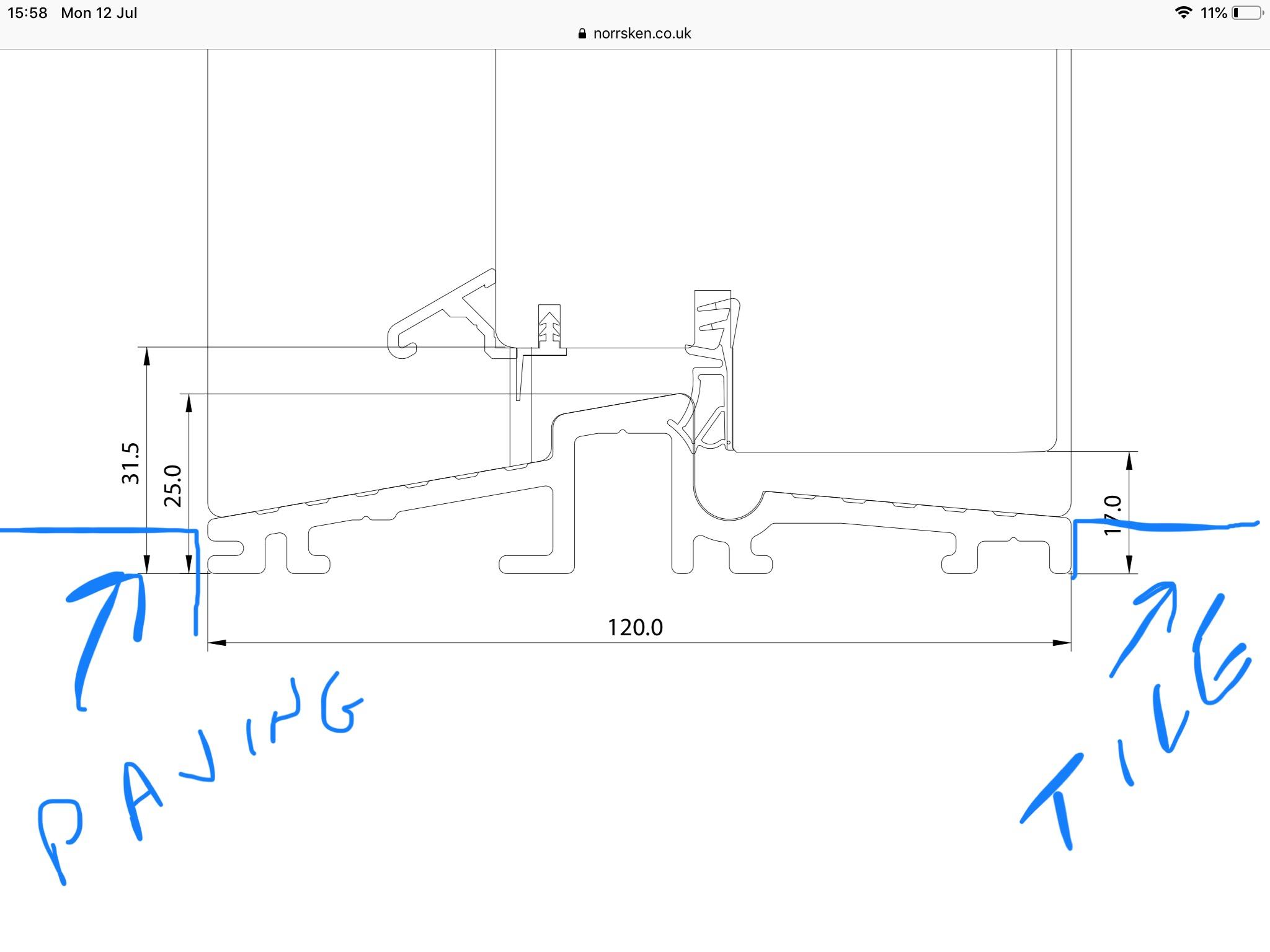

Russell griffiths Posted July 12, 2021 Share Posted July 12, 2021 (edited) G,day. Im just looking at front and back doors, can anybody point me in the direction of what height difference we need to comply with for disabled access. I had in my mind that it was 15mm high, i have a drawing of the door threshold I would like to use, do you think it is cool bananas or no good, it’s from norrsken who supplied our windows which I am very happy with so I’m hoping they are correct. Edited July 12, 2021 by Russell griffiths Link to comment Share on other sites More sharing options...
ToughButterCup Posted July 12, 2021 Share Posted July 12, 2021 (edited) As so often, you are right. Here you are old fella: LABC guidance Its from their Step-by-Step Guidance booklet. Who says builders can't crack a joke? Ian Edited July 12, 2021 by ToughButterCup 1 Link to comment Share on other sites More sharing options...
Russell griffiths Posted July 12, 2021 Author Share Posted July 12, 2021 Cheers bigears @ToughButterCup, I think those cills will be pukka. Just what I expected from our Norwegian friends. Link to comment Share on other sites More sharing options...
Oz07 Posted July 12, 2021 Share Posted July 12, 2021 Just ask when ordering if part m compliant. Look ok to me. 1 Link to comment Share on other sites More sharing options...
nod Posted July 12, 2021 Share Posted July 12, 2021 15 or under Link to comment Share on other sites More sharing options...
