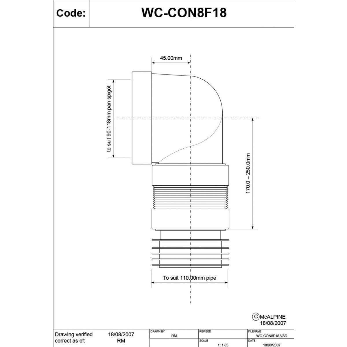

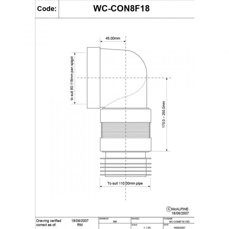

The McAlpine fittings are much better quality than the Floplast stuff. Dimns of a couple of McAlpine connectors for instance:
mcalpine-wc-con8f18-4-110mm-90-flexible-wc-connector-short-length-drawing.thumb.jpg.f2b556cb94273e11f72f987f875acb77.jpg
