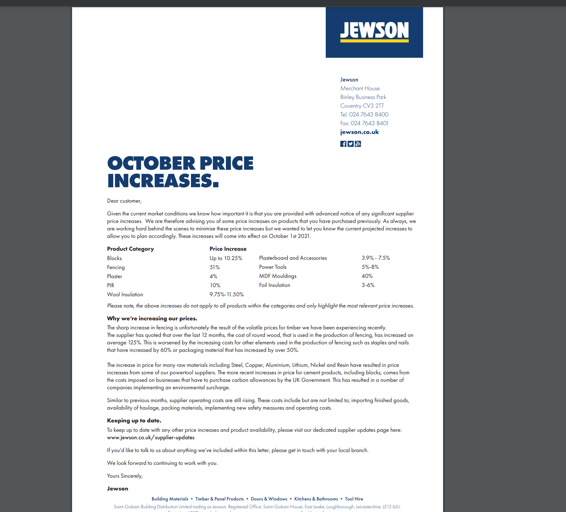

Dave Jones Posted September 22, 2021 Share Posted September 22, 2021 Link to comment Share on other sites More sharing options...
