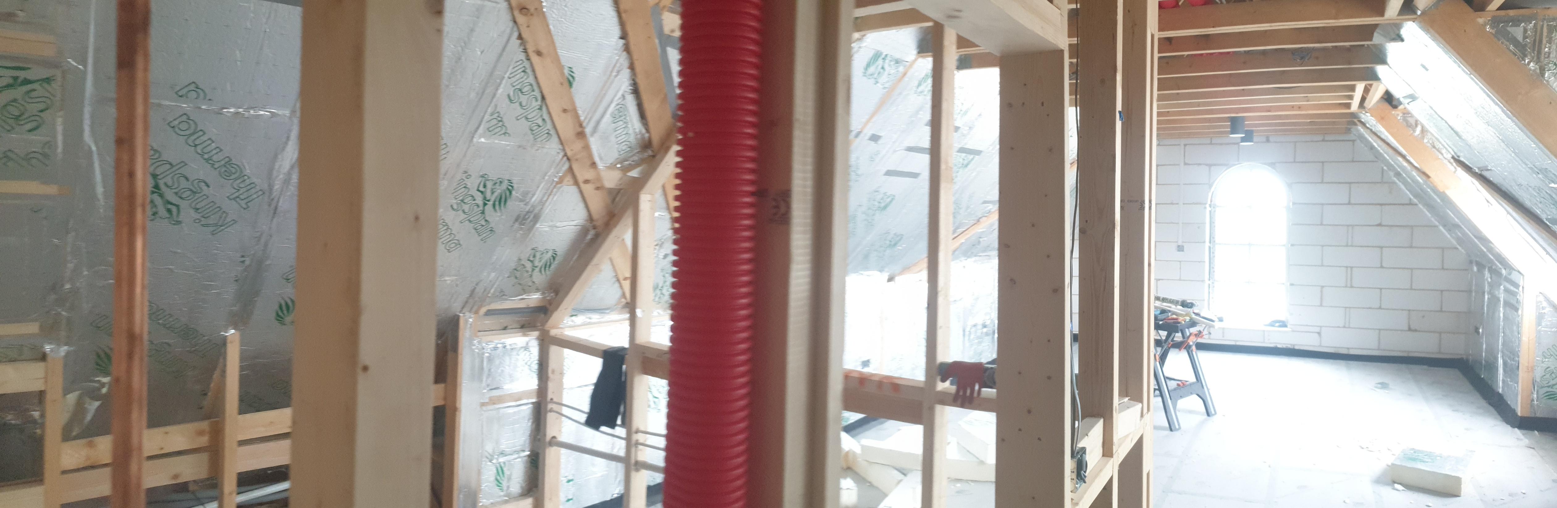

I'm fully filling the rafters with 200mm of mineral wool and 100mm PIR below
You will need a lot of very long drywall screws to fix your plasterboard.  I don't envy the tackers.
err...that's me! ?
but I'm planning on battening it out as then plaster boarding on top so the long screws will be for the battens then standard drywall screws for the plasterboard.

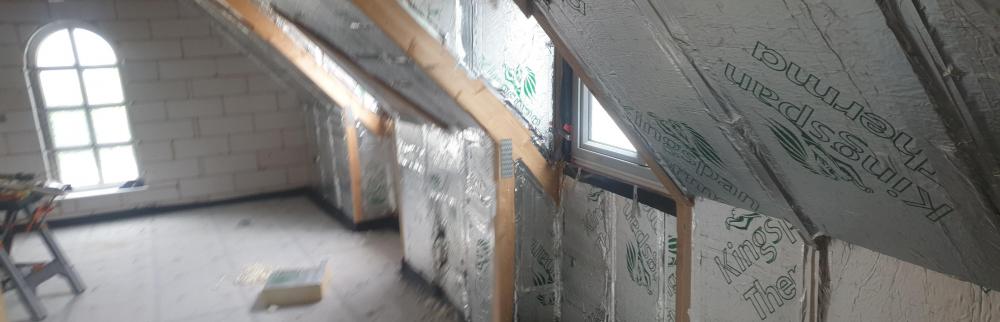

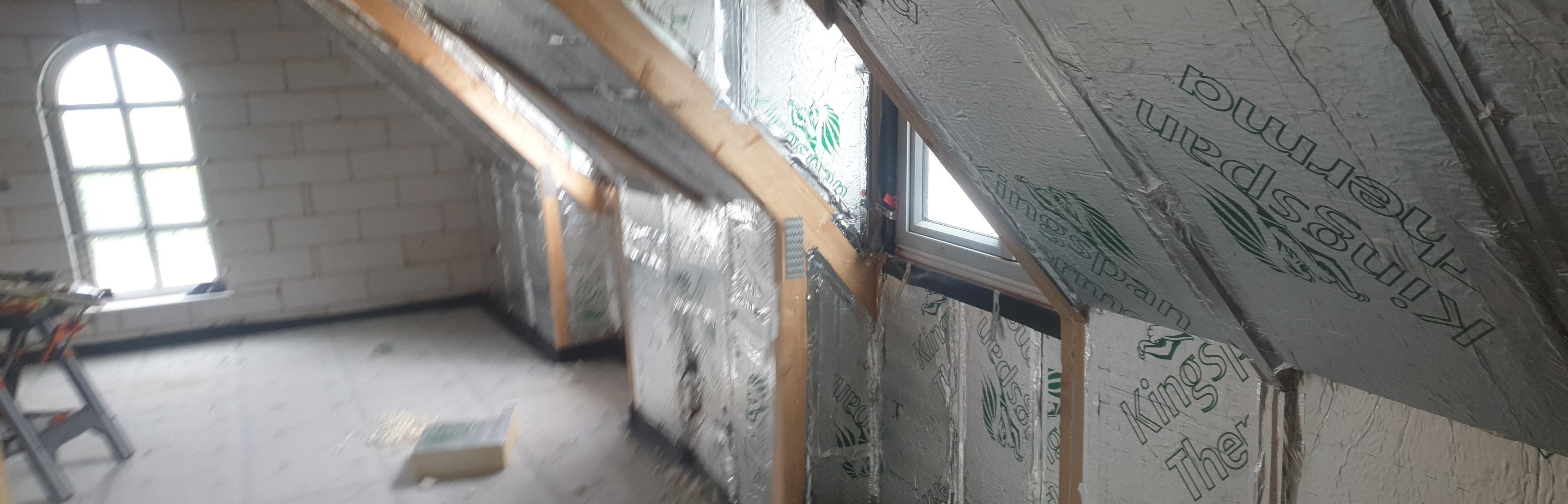

Sorry - promised a pic and failed to deliver! Sorted.
The garage ceiling was a piece of p*ss compared to the attic room.
